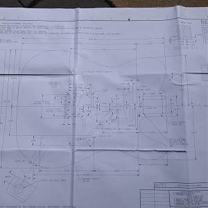

    I got plans for a tele off the web and printed out to scale so i can make my templates.

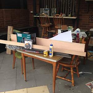

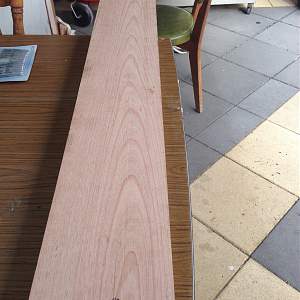

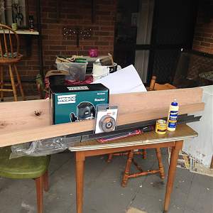

    any way here is some photos of some of the stuff i got, Click image for larger version.
ID:	4652Click image for larger version.
ID:	4653Click image for larger version.
ID:	4654Click image for larger version.
    Please excuse the mess in the back ground, we are doing an extension of the house at the moment so there is crap absolutely everywhere.
