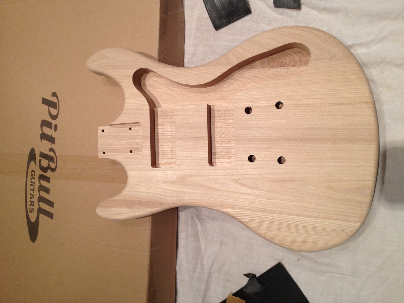

    Mine:

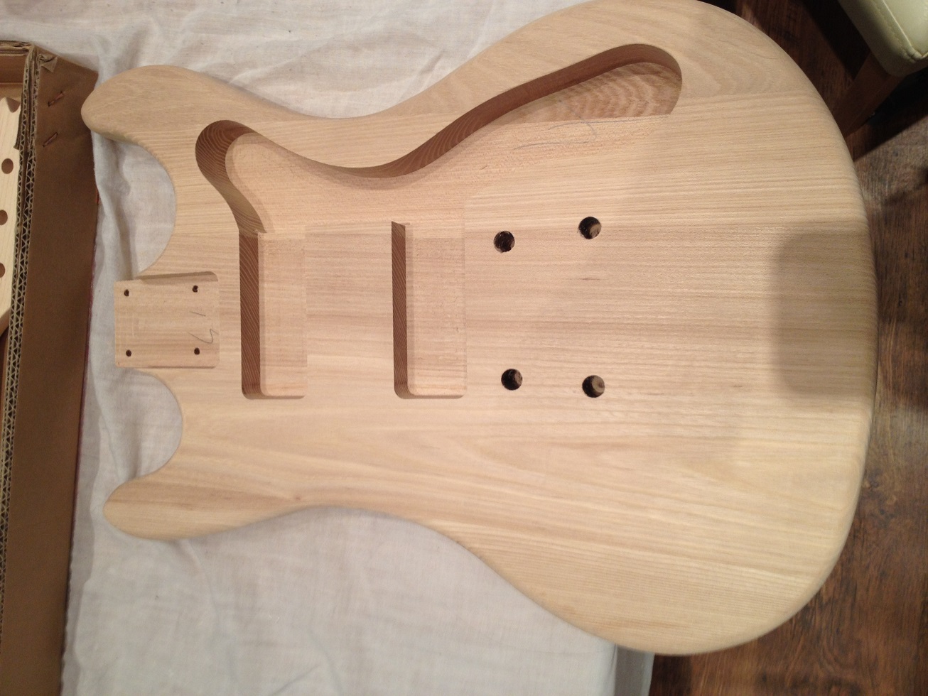

    Nat's:

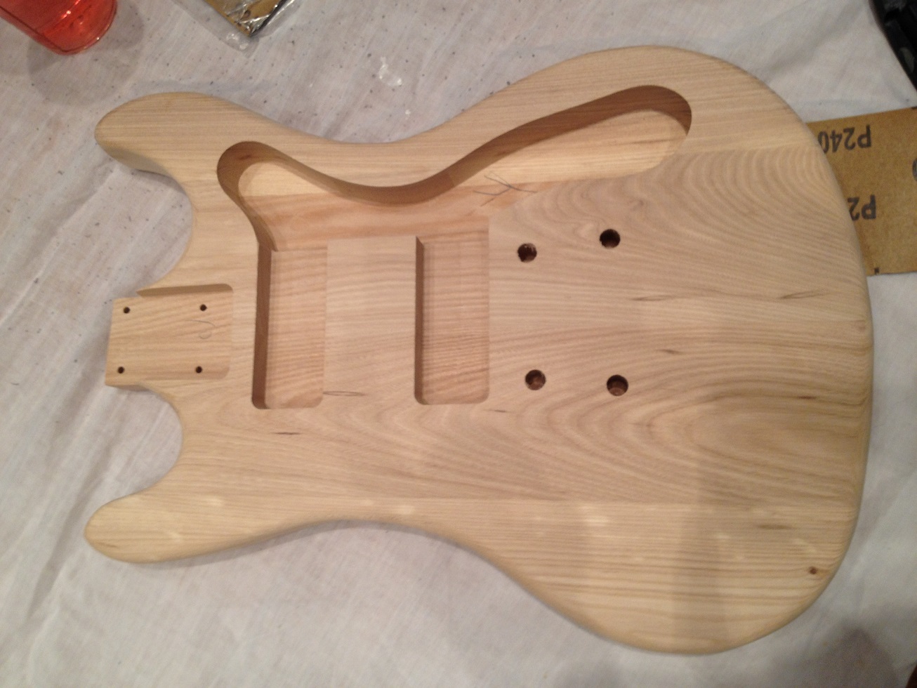

    There is absolutely no difference in the pictures, but here they are sanded... (Imagine tree bark when looking at the above ones, and silk when looking at these!)
    Mine: Click image for larger version.
    Nat's: Click image for larger version.

    Love it when folk get into the sanding
    Only thing I can say is you are best not go past 400 grit, finishes need a fair amount of tooth to hang onto.
    Sanding to 1200 polishes the timber to the extent where your finish has nothing to hang onto.

    I think that video is for rattlecan finishes. I'm pretty sure on the Dingotone video DB says to stop at 320 or 400 or something like that.
    Hi Mos-wrong, both kits look excellent. It's a shame you are going to cover that ash grain with white lacquer !
    The azure lagoon wudtone won't get really dark. You will need to get some darker dyes if you want a real deep blue. It will still look a bit darker on the ash grain though.
