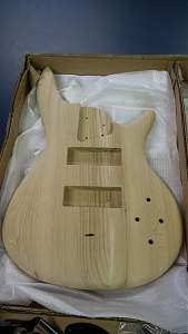

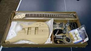

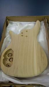

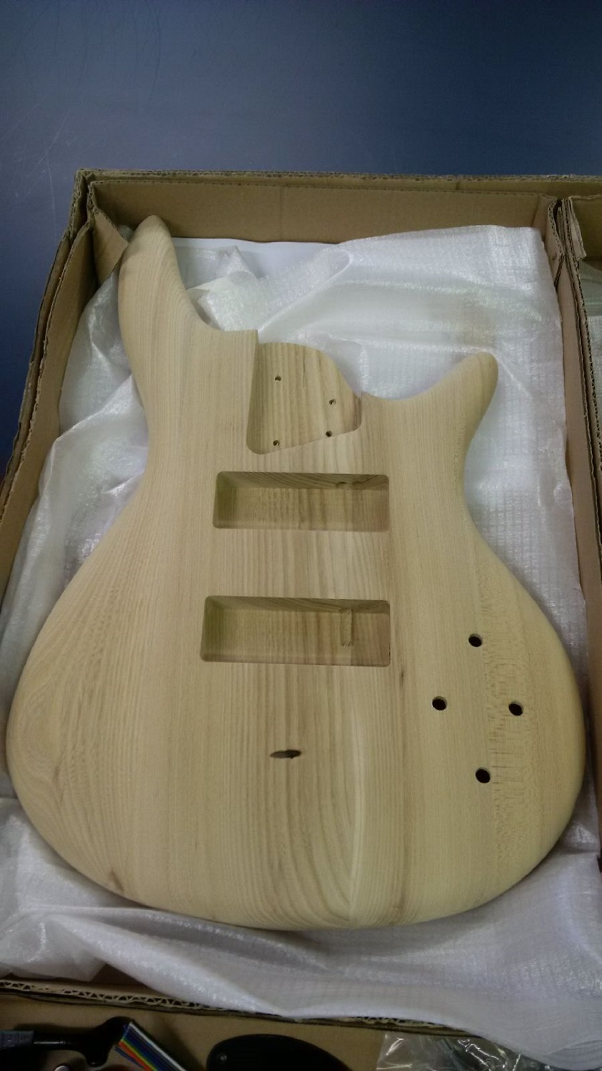

    Hello all...much sanding has been done!! Cant wait to get started on the first stain coat, which i'll attempt tonight. What kind of rag would be ok for the job? I was just going to use an old cotton t-shirt but thought i'd ask?

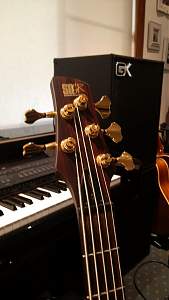

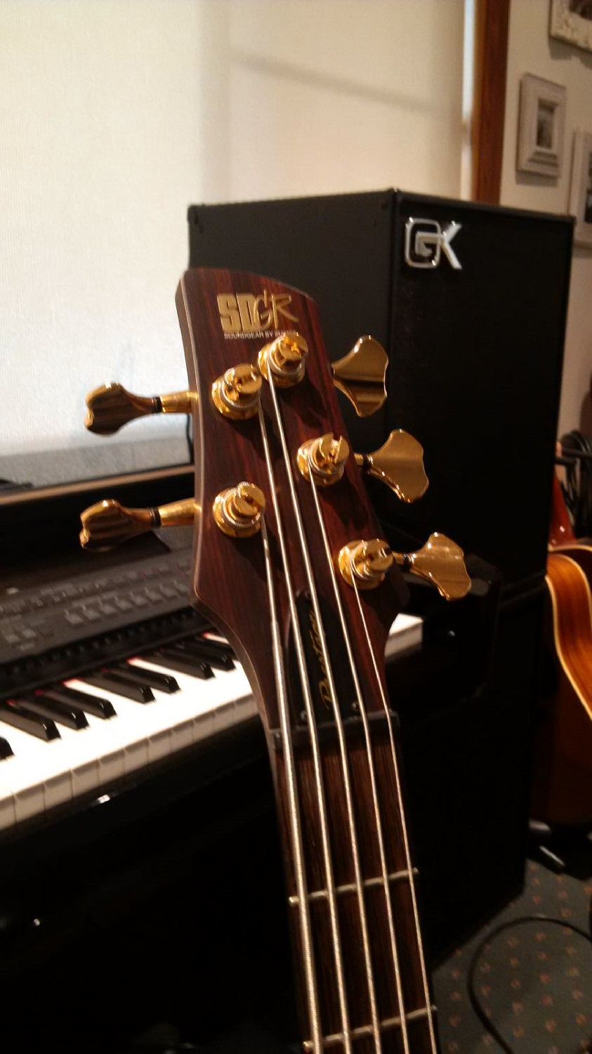

    Have included some pictures of my kit and also some of my Ibanez Prestige SR5005E-OL which I want to base the build of my IB-5 on. That's why I want to get gold hardware. As you can see, a dark timber with gold hardware looks seriously mean!

    See the Ibanez pictured has the 3 tuning pegs on the treble side of the headstock (PBG has 3 on the bass side)
