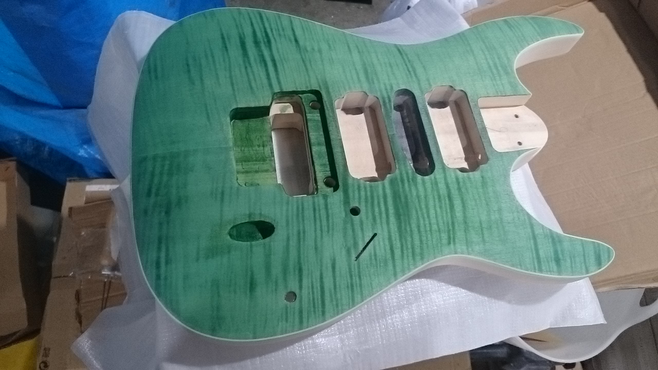

    Time to get a little colour into it.
    So far so good, I think another coat of green to bring it up a little more and I will get to staining the back and sides. Going with green for them too, might add a little black to get them a little darker than the top though. Anyway that's it for now, I'll catch you all later.
    Mulldoe.
    So, made a little more progress. The photo doesn't do the colour justice, it is more emerald green than it appears in the photo.

    ooooh minty! I have one of these in mind for later.
    looks great Mulldoe, you even stained all the visible areas some people forget to.
    I think another coat the green on the cap would look better a bit darker.
    Nice work on all the prep, it will pay off !

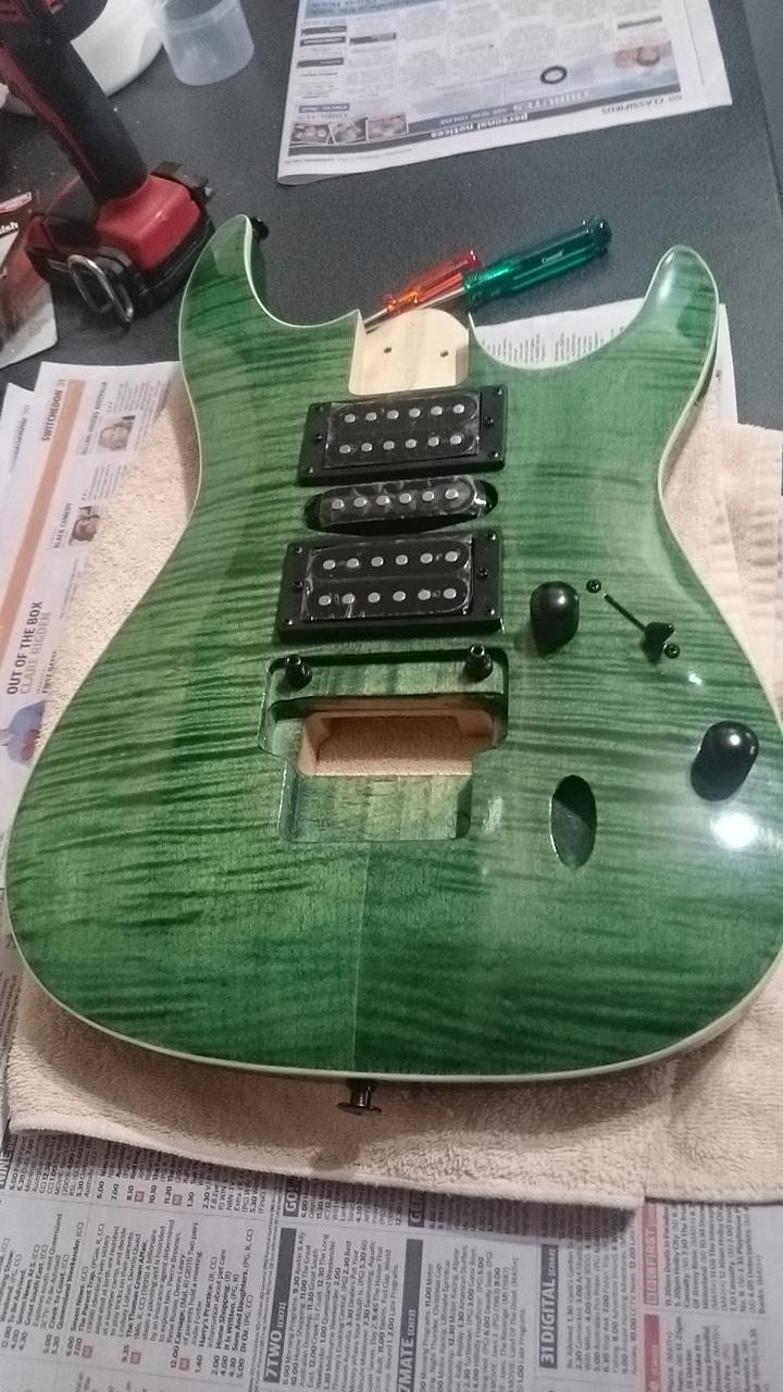

    Finished installing the electrics and got a good tip for any new builders, when you do your mock build check everything. Turns out the jack collet was too big to fit into the port on the front of the guitar, it also wasn't long enough to get thread through to the controls cavity. I ended up filing down the collet on the jack and drilling/chiselling a recess into the control cavity to get it all installed. I got it all done with no problems but it would have been easier if I didn't have to worry about damaging the finish.
    Still sorting out the problem with the machine head, but once that is done I just need to oil the neck, give it a fret job and do the final assembly.
    Mulldoe
