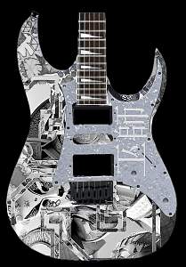

    TimHilbert Concept Art Pitbull SV7- 01
Name:	sm CONCEPT FINAL TIMOTHY J HILBERT .jpg
    This is the general direction for the Concept.
    It'll most likely be wrapped, left rough and unsanded, with natural headstock, EMGs, Hipshot locking tuners, Maybe a Floyd Special or 1000 (possibly blocked)
    So Far
    About $280US for the SV7 kit shipped to NY, USA ($75 DHL)
    The wrap and a sticker are about $82US. Colored stains are near $16 at US hardware stores, $30 on Amazon.
    The moment I invest in a bridge, the price gets up pretty fast.

    Yes - as soon as you look to a better name bridge - thoughts of other upgrades just start increasing - i've had to force myself to stop it!
    I try to go by the thought to use what there is - and then upgrade what is then seen to be necessary - given what I've read from everyone's posts (I'm only doing my first build now - so leaning as much as I can on other people's experience).
    One thing that does "make sense" regardless - is replacing all the screws - I've been caught with more than one snapped screw in a number of non-guitar pieces, so this is something to consider.
    I am intrigued though - what is this "wrap" you mention?
