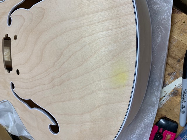

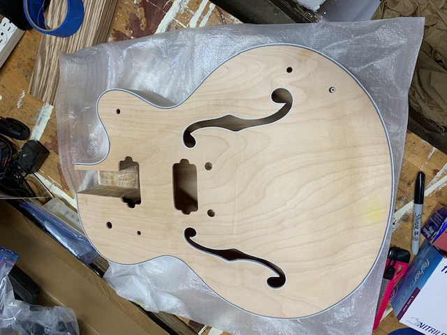

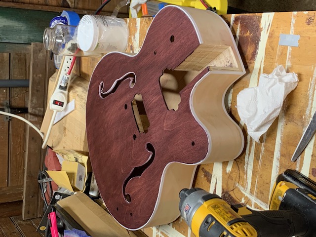

    Got this Gretsch Falcon body a few months back and finally getting around to playing with it.
    Only little blemish I found in the first look and dry fit was a little yellow splotch at the bottom. I tried to sand it out the best I could but figured a dark stain plus the Bigsby would do enough to cover it.

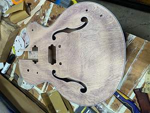

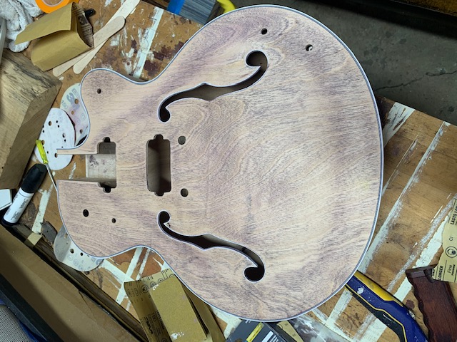

    I went for the first stain and realized there were a ton of sanding marks so I brought it back down and hand sanded them out and restained with a Black Cherry oil based Minwax stain

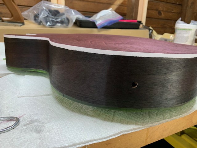

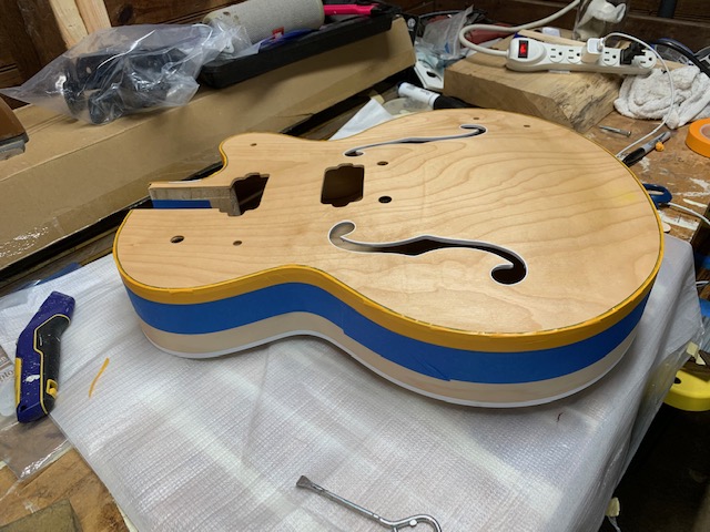

    Went with an Ebony stain for the side wall and then learned my lesson of cheap amazon tape and scraped the binding almost everywhere. (these photos were before I scraped the binding)

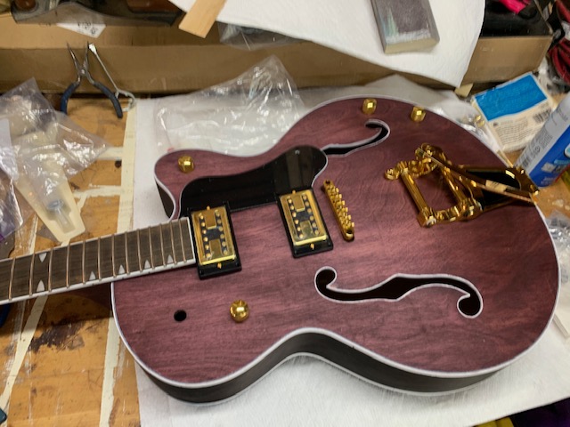

    Dry fit with the pickups sitting in to see how itll all look together.
