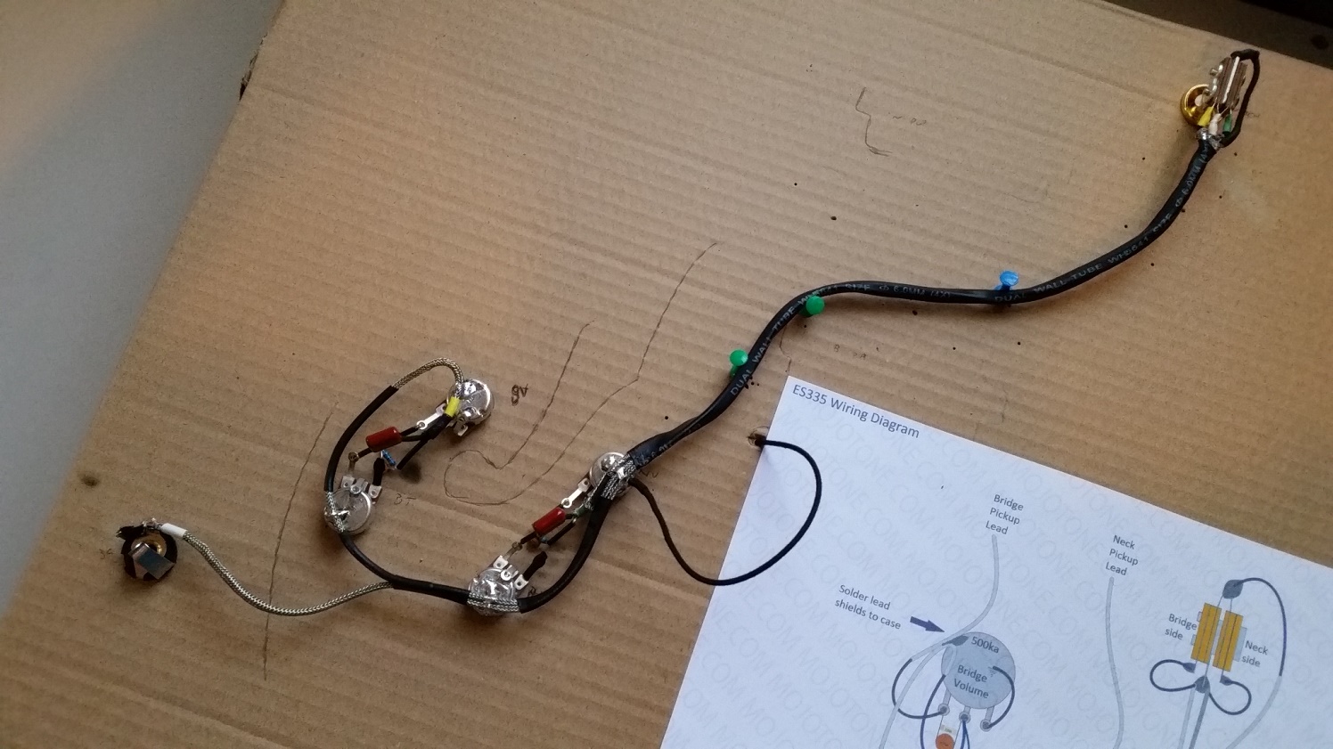

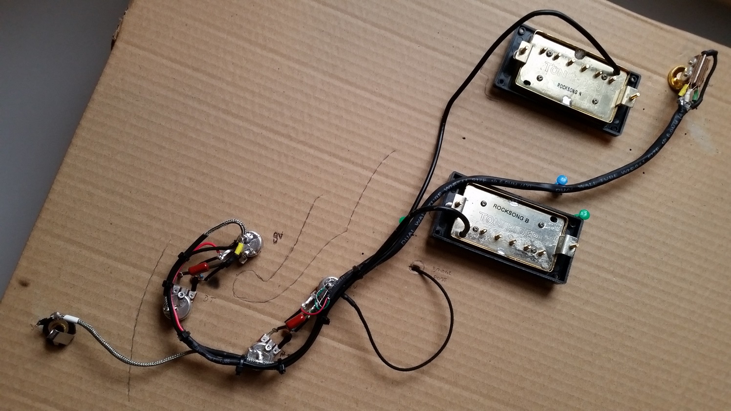

    Something to consider for the wiring is not being able to see it go across the f-hole. I did an ES-3 (now designated FH-3) a while back and made it 'loop' around the bottom of the f-hole

    I used vintage braided wire for the long runs and cloth covered wire for the rest. Braided wire can be the ground connection between the pots without using a separate wire. The heatshrink was to help shape the harness and stop the outer braid from contacting any pot tabs or capacitor legs.
    Grant

    Quote Originally Posted by neverwas View Post
    Good advice!! I had forgotten about that. You would think I'd learn from my mistakes. The only thing worse than installing the harness in a semi-hollow is having to re-install it because you forgot that you don't want the wires visible from the F-hole. I actually have the F-hole drawn on my template to remind me where it is when I am soldering the harness.
