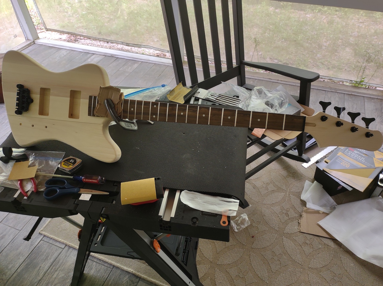

    The kit arrived quickly and everything looked good when I unpacked it. The only adjustment it needed was in the neck pocket. It was slightly too narrow. A little sanding solved that.

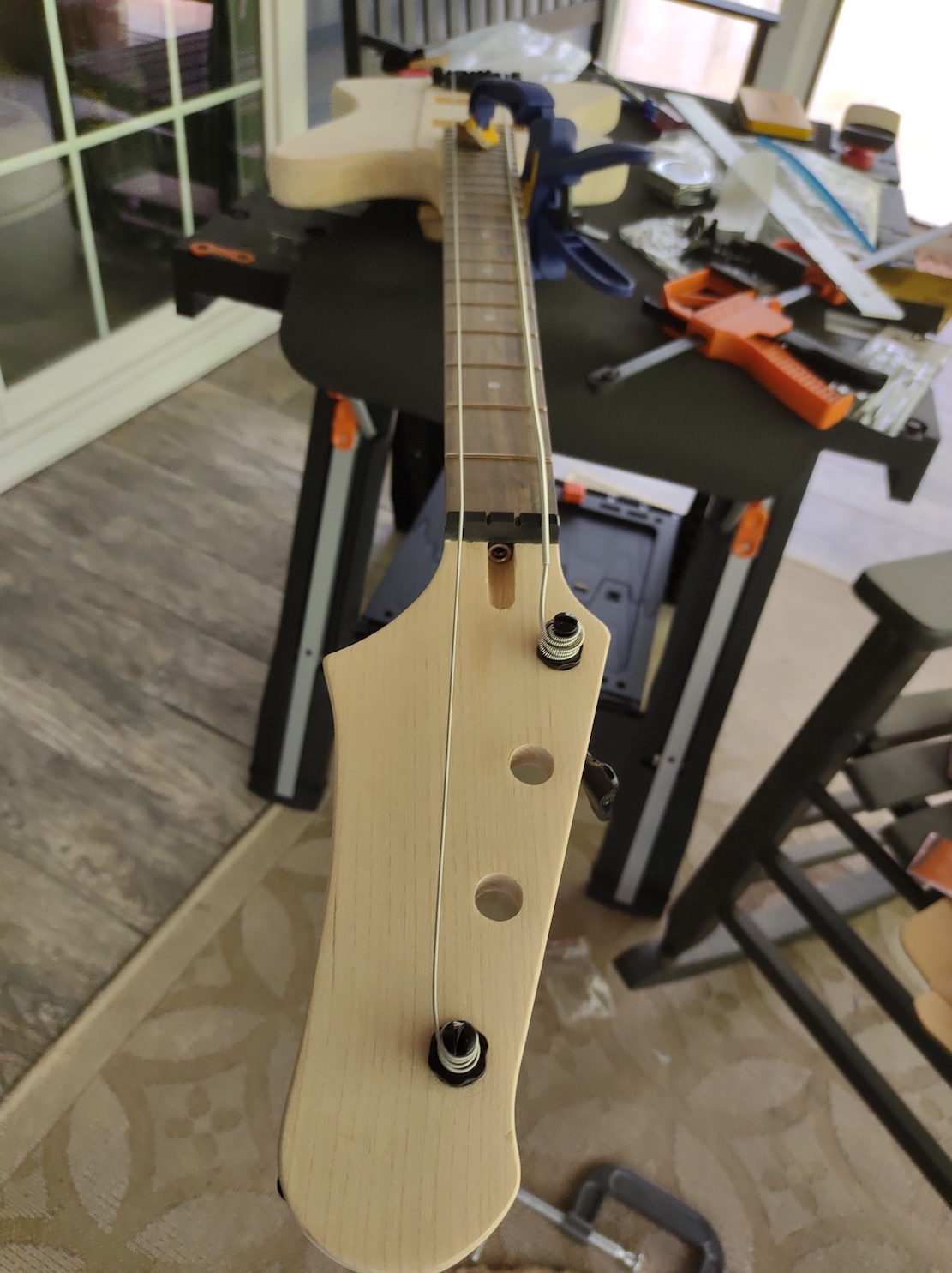

    It seemed like the action was going to be really high, and I've read complaints about the TB-4 bridges, so I got a replacement bridge from Hipshot. It barely makes a difference even with the saddles all the way down, so I may need a neck shim. No regrets though, it's a better bridge in other ways.

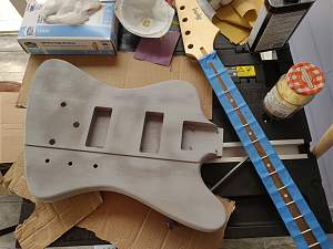

    The body (it's basswood, so very soft) has a couple of very small dings that I wish I filled before I started painting. I thought they might be filled by the paint and primer, but that hasn't happened. They're not bad, most people may not even notice, but I see them. Lesson learned.

    I'm almost done with the top coats. They've gone a lot like the poly on the neck: mostly very good but I often manage to catch a bit of something from the air, like a piece of lint or a tiny flying insect.

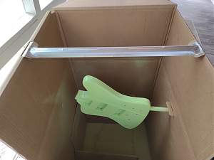

    I came up with a solution a few days ago: I have a wardrobe moving box that I can use as a spray booth. It has a metal bar across the top meant for coat hangers. A body or neck can be hung from it. Also, there are handle holes in the sides which I can pass a dowel through, then mount the body on the dowel. The other end of the dowel is clamped to my work table. I can rotate it as needed.

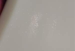

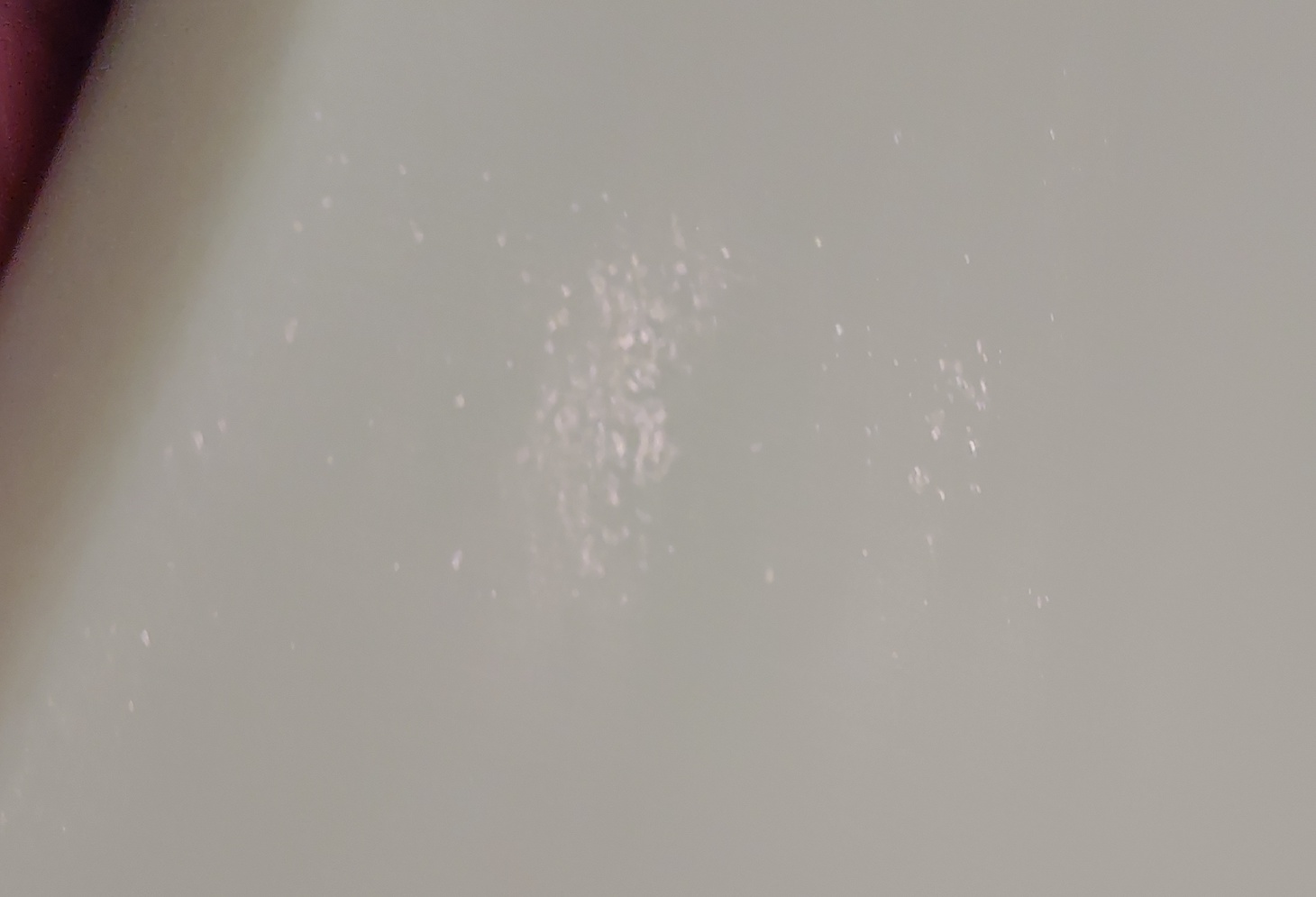

    I gave the body a thorough sanding since the last coat of paint was a little rough. It feels very smooth now, but when it catches the light the former low spots sparkle because they still have some of their original gloss.
    Do I need to keep sanding or will this not be a problem once it's clear coated?
    If you can get it flat now, it will make sanding the clear coat easier.
    Paint (unless thinned very heavily or applied very thickly indeed) has too much surface tension to fill dips. It just follows the contours of what’s beneath it. So if you leave those shiny pockets now, you’ll then just need to sand the clear back in that area to remove the matching dips in the clear, which probably means a couple of extra coats of clear to give you the depth to do so.
    It’s always best to get each type of coat as flat as possible before applying the next type. You then know that any small pits in the next layers are just in that layer, so you should be able to sand down without sanding through.
    In terms of looks, small pits as in your photo, won’t show up with flattened and then polished clear coat over the top, but you’ll need to add more coats to avoid risk of sand-through, which slows up the whole drying/curing process.
    Thank you Simon. This is good advice.

    Spraying in that wardrobe box is an improvement over spraying in the open but it's not perfect. It stopped the wind from adding "texture" and I didn't have any more insect suicide squads to sand out (this paint job is not vegan). But the box only has one open side so overspray swirls around inside and deposits more droplets of paint over time. I think that contributed a lot to the orange peel. Maybe some vents would've helped. In the end I sprayed a lot of coats and did a lot of sanding.
