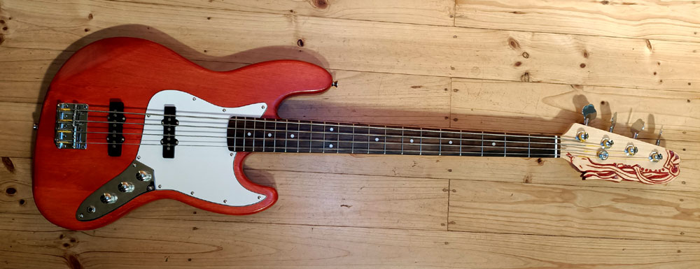

    All Done, came out well!Click image for larger version.
    1,839
    Looks good hIPPYsHAKE. I love the snake on the headstock.
    thanks I was thinking of entering it in the guitar of the month thing, how do I do that?
