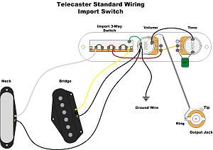

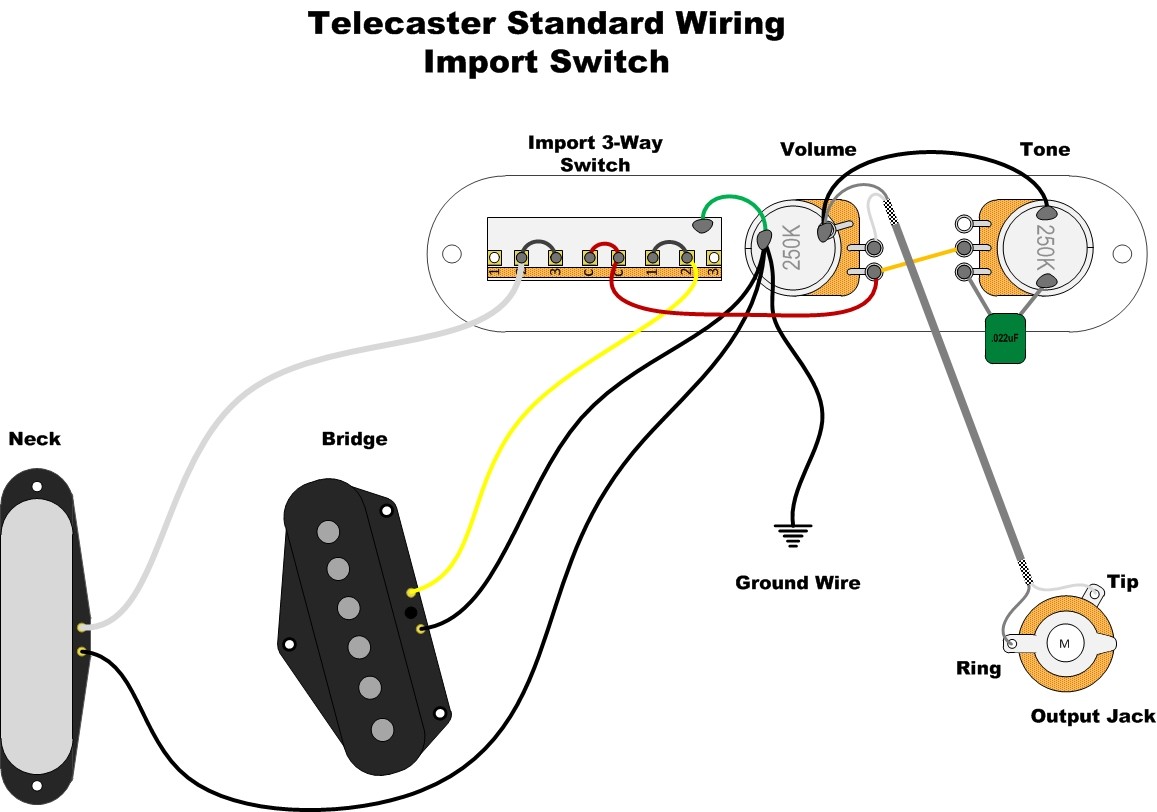

    The switch is not wired correctly. You have lugs linked like it was a CRL-type lever switch.
    The internal routing of the "import-style" switch is different.
    Try this diagram for a tele with 8-lug import switch:

    Thanks mate I saw your previous advice in another thread on this. I had tried the initial wiring that came with the switch and put in both sets of pickups using that wiring. Then after I saw your comments on this in another thread I rewired for the import switch. Still no dice.
    So then I bought a new 3 way fender switch and replaced the import and tried wiring it again and no dice.
    I have it currently wired under Broadcaster wiring diagram. But have down modern Tele and Nocasters recommended wiring using these same new pots and switch. Still just buzz.
    Just buzz, no sound from the strings.
