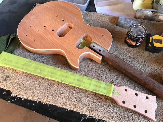

    I purchased a DSCM-1 kit in 2020 with the aim of trying to make something like a Truckster, or something inspired by a Truckster. I'm not sure how reliced (!) it will end up, but I have finally got around to starting.
    So far:
    lots of sanding up to 240 g.
    levelled, filed and polished the frets.
    shaped the headstock.

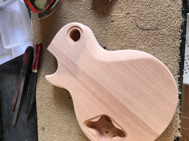

    One belly cut.
    One belly cut.
    Good move on any LP-style body IMO! (and tele's too!)
    I don't have a particularly prominent belly, but I still find it more comfortable. Especially playing sitting down.
    Hear, Hear! Yes, I play sitting down a lot. Until the red strat' style build from earlier this year I had never played a guitar with a belly cut - but I did find it more comfortable.

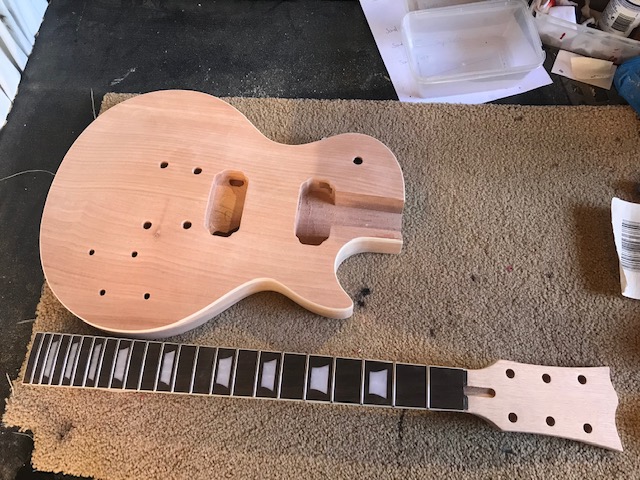

    Are the control cavity routs big enough to take full-sized pots? On some kits you can only fit mini pots without enlargement of cavity walls.
    2,000
    I'm not sure. I don't actually have any full-sized pots to check. What are the advantages to using full-sized pots?
    They last longer, plus you've got more real estate to solder ground wires to. Because the carbon track is considerably longer (probably about double that of a mini pot), the taper is supposed to be smoother as well (though if you are a 10 or 0 person it doesn't really matter).
    I assumed that if you were making a tribute, you'd be using similar electrical components throughout e.g CTS pots.
    2,000
    Thanks Simon. This is not a true tribute, more an inspired by. As long as it looks similar, I will be happy.
    I'm still not even sure if I will have the same 2 switch wiring or just stick with the standard style LP wiring. More research is needed!

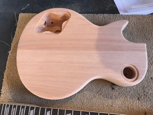

    I have applied 2 coats of FW sanding sealer using a brush, with 400g sanding after each coat. Feels nice and smooth.
    Now waiting for some good spraying weather!
