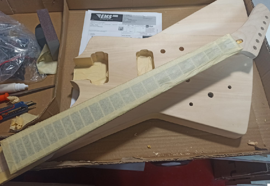

    Ready for stain, oil and wax..............
    dome some test on a simliar wood piece and I do not fell sure about the color... tomorrow need to go to the shop to look for another one
    Before you put any finish on, see how the neck feels in your hand. My EX-1 has a very 1950s feel to it, more a chunky D rather than a modern C shaped rock neck. I think I'll be sanding my neck down and refinishing it to make it a bit thinner at the sides, so more of a C shape than a D shape.
    It's hard to tell exactly without strings on, but swap between the EX neck and one on a guitar you like several times to get an idea of how different they feel. You may like big 50s Gibson style necks (the Explorer was designed in 1958 along with the Flying V so the originals had a similar big profile to a 58 Les Paul), which this kit seems to copy, but whilst comfortable, it's not particularly 'fast' to play.
    So you can sand the neck down to get a better feel for you, if you want. Don't take too much off the very back of the neck, but you can thin down the sides. Increasing the angle of the sides where they touch the fretboard can make a big difference to feel, so that they angle in instead off dropping straight down for a bit.
    \ rather than |
    \\ rather than|

    Thanks Simon... will check it today at night. It is a good idea... and I do not mind to spend someextra time sanding.
    First I will compare it with an ST ( mi first guitar and the only one for years) and a LP ( Harley Benton )
