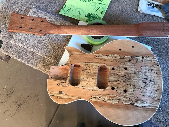

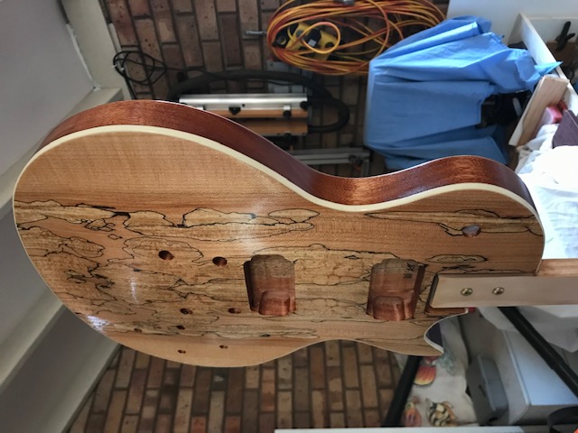

    Started my second build after managing to get hold of an old LP1ss kit which had been collecting dust at the back of some ones cupboard. Plan is to tru-oil the spalted maple, and use Dingotone Nullabor Ochre on the back of the body. I will possibly upgrade the pickups at a later date.
    So far have given a few coats of TO and given a light sand. I filled a couple of holes on the maple veneer with CA glue.

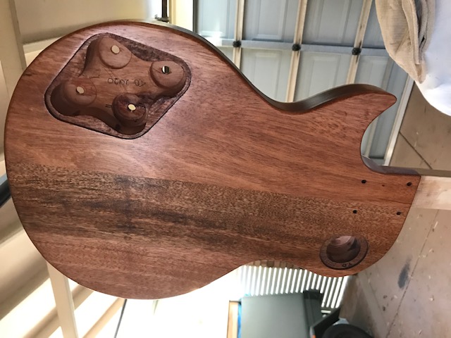

    I have been adding a few more coats of tru-oil to the maple veneer. Also added the DT Nullarbor Ochre to the back and sides. Now thinking about the shape I want for the headstock.

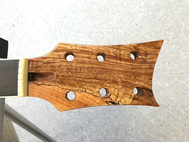

    I have cut and shaped the headstock. I wanted it to be different to the traditional LP open book style.

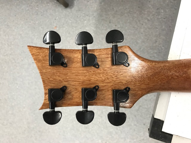

    2,036
    Smile
    Nice interesting shape.
    That G tuner will be quite close to the end.
    They all fit.
