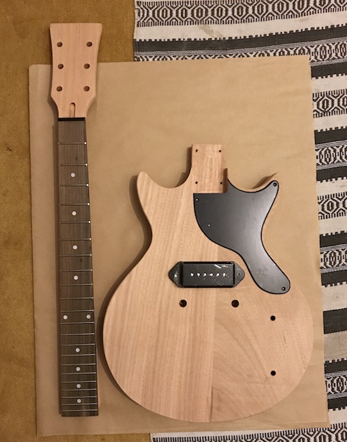

    Day one:

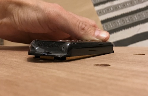

    Test fit neck, machine-heads, P90
    Neck fine, tight with a little gap, pegs fine so far, pickup is too big for routed cavity, so some adjustment needed there.

    Day two:
    (a week later...)
    Tiny bit of sanding with 180 on the sides of the neck pocket and the neck fit is much better.
    Either the wood adjusted to the house conditions or its the awesome power of gentle sanding - either way, this feels like a small victory ;-)
    Got the neck safely clamped, measurements next.
    Want to see if the (too small) pickup cavity is centred ok before I start sanding/routing at edges...
    Onwards.
