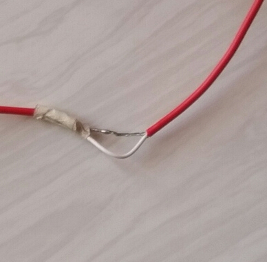

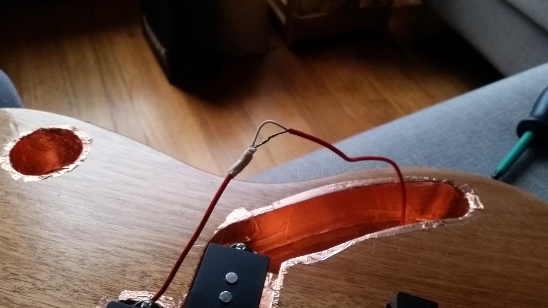

    Quote Originally Posted by ross.pearson View Post
    There is this bare wired section on the wires going to the switch. The fact it is bare implies it's expected that it will be soldered to something but I'm not sure.
    I can't tell what that wire is coming from or going to, so not sure what's going on there. If it came that way from the factory, I'd say it's just poor workmanship and needs insulating.

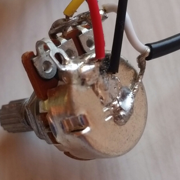

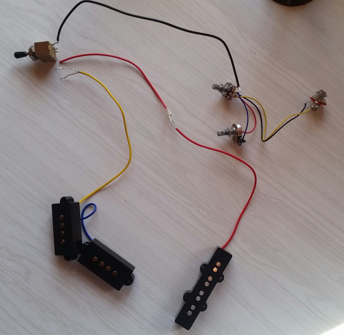

    I think I understand that both dual core wires from the bridge and neck picks up go to the switching pot.
    I'm guessing the bare wire/braided bit gets joined either with the earth from under the bridge or soldered to the tab on the empty tab on the pot closest to the camera (that has been bent over and soldered to the body of the pot.

    All the braided wires will be for ground, the centre core (white insulated) will be your signal.
    In the case of that red wire coming off the pickup, they obviously cut it too short to reach the switch so joined it (really badly) to get the extra length. Whilst the exposed bare portion might not cause any problems if it contacts the shielding, it's bloody poor workmanship to leave it like that. They could have at least wrapped some tape on it!
    Your ground wire coming from the bridge can be soldered to the back of either pot like the ones already attached there.
    The braided wires from each pickup will get soldered to the single lug on the switch where the braided portion from the black wire is already soldered as well.
  13. #10
    As it stands you could still slip a piece of heat shrink tubing over the exposed joint.
