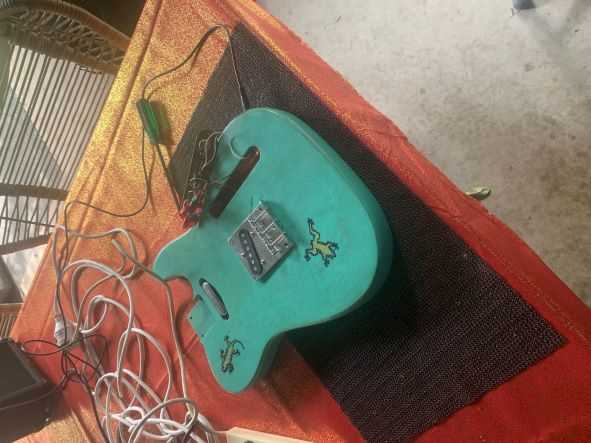

    First build and I am having problems with wiring. Been through all of the wiring threads and I seem to have the wiring right, but I am possibly doing something silly.
    Completed a "tap test" - when the 3 way switch is set to the front position I only have the bridge pick up. In the centre position I have both pickups working. However, when the switch is in the rear position I still have both pickups working?
    Have I done something silly or have I got a crook switch?

    Hi Darryn,
    the pdf isn't showing anything. Can you post another picture of your soldering?
    From your description, I'd say the switch was faulty. If you have a multimeter, I'd check by disconnecting the two input wires and checking the switch positions.
    I presume it's a 'box' type toggle switch, and they aren't the most reliable type of switch in my experience.

    Sorry Guys,
    Technology beat me with the photo. Still having trouble getting them to a small enough size to fit in the forum.
    Thanks very much for the feedback - where would I check with a multimeter please Simon? From earth on the back of the volume pot with the black lead to the points I have soldered on the switch with the red lead?
    Darryn

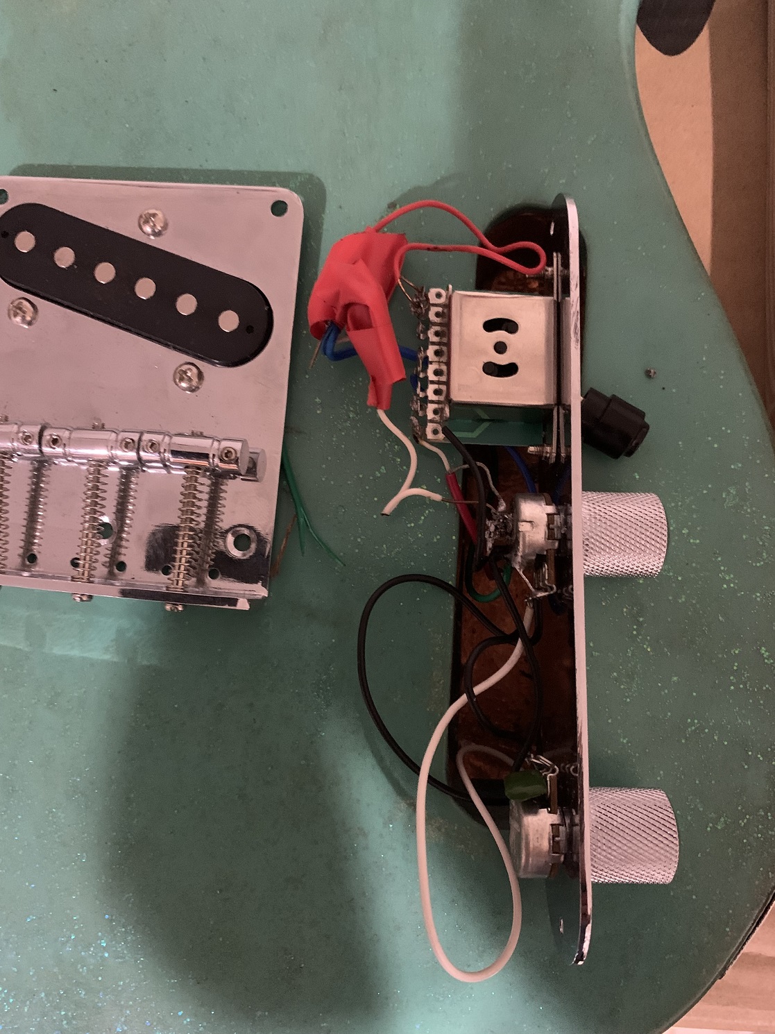

    OK, so it’s a Tele, so not a box switch. You can make wiring mistakes with those, and it’s easy to get a loose wiring strand bridging contacts, so we really need a close-up or two of the switch wiring.
    Photos need to be resized to be 1500 pixels (or less) on the longest side. It’s a right-click option on the standard Windows photo viewer, or if using a phone or tablet, there are free apps to do it. The Tapatalk forum app also resizes photos.

    Got the photos working!
    Thanks for the advice guys, and sorry I am a little slow. That 4 nasty letter word (work) has been getting in the way......
    I have only tacked the wiring at this stage to make it easier to remove if I have made a mistake, so it is a little bit rough, but there look to be good contacts there. Other wire has been earthed under the bridge as per instruction guide. Should I solder this on to make sure I get a good contact (I did have it twitched through a screw hole, so pretty confident about the contact)?

    Got it! Didnt quite have a reliable connection with the earth to the back of the volume pot!
