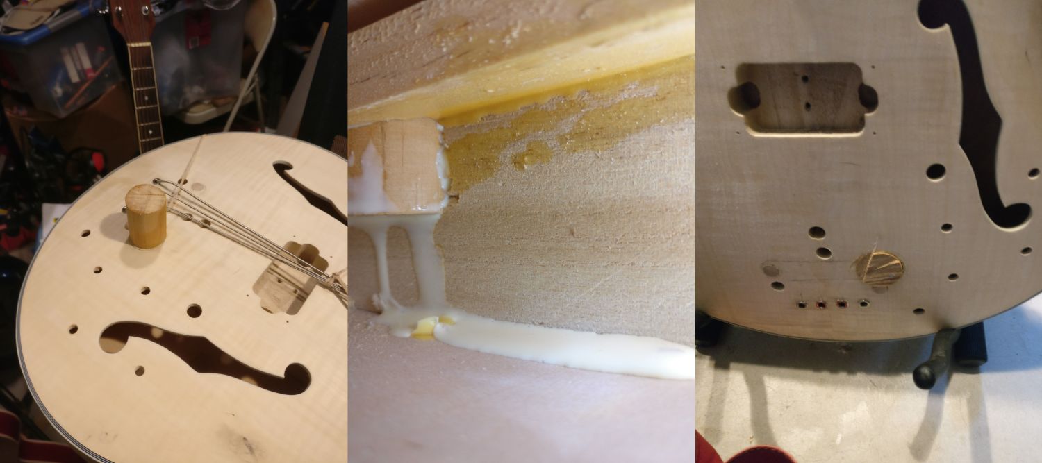

    Plan D is shockingly invasive, but it worked well for me when I needed to align one of my posts entirely off the center block. I used Titebond for everything glued.
    First I glued a piece onto the side of the center block as in plan C, and let it dry for a full 48 hours. Then i drilled a BIG hole with a Forstner bit. I centered the hole so the middle would be on the center block, but not by much as you can see in the photo on the right below. In the photo on the left you can see the bar that I glued onto the side of the center block. The gap between the top and the glued piece (due to the top's curvature) is really clear in this pic.
    All the glued piece does is give the plug a little more lateral stability.
    The pic on the left shows the wooden plug that goes in the hole. This plug is recycled from a remodeled closet. In the middle pic, you can see how the glued piece at the top supports the plug, and how excessive I was with the Titebond. Pic on the right is after I used a Japanese saw to cut off the top of the plug as flush with the body as possible. I got a little beyond flush in a couple of places, but once filled you can't tell under a solid finish.
    Pic on the right is how it looked after filling, sanding and dry-fitting the hardware. Pic on the left is how it looked with the finish on but the hardware off.
    I think this approach works pretty well. It won't preserve the the veneer like JimC's approach...but it worked for me.
