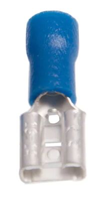

    You might be able to find something like these clips. You squeeze the blue part to clamp onto the wire, and the slip the clip over the output jack tabs.
    I should say that I don't think this is a good suggestion. It's bound to come lose at some point, but it would be better than just wrapping or gluing.

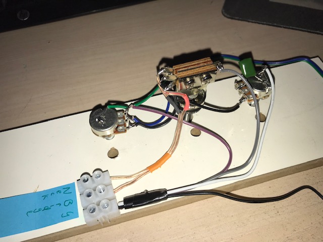

    Can you solder some wires to the output jack when it is not on the guitar, and then connect the wires to the pot wires using a terminal strip. This is the way I've done it so that I don't need to solder while the components are mounted on the guitar.
    I used this to connect the pickups on my FVB-4 (see pic below), and AG2 kit so that i can easily change the pickups at a later date.
