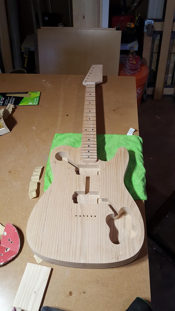

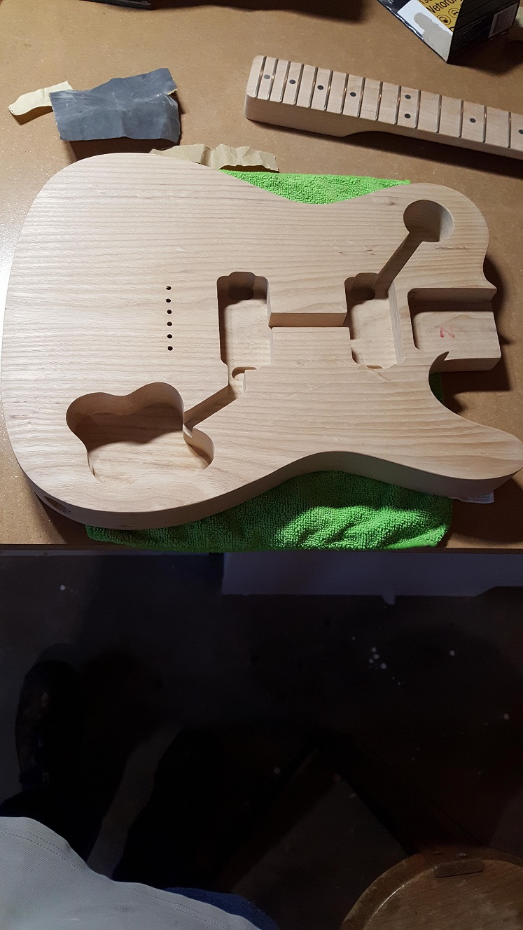

    It took longer then I had anticipated, but I was finally able to get started on my guitar kit today. I had previously done a mock build to ensure everything was included, so today I worked on doing some initial sanding, and getting the neck to fit into the body. It took a little more work then I had hoped to sand the neck pocket so the neck would fit in, but I am happy with how it fits, and I think it has a good fit. Aside from fitting the neck, I started sanding the body of the guitar, I started with a 180 grit, and after that, I used a 320 grit. I am planning to do some more sanding with higher grit, the next time I do work on the guitar.
    Does anyone have any recommendations on how high of grit I should sand with prior to starting the finish?
