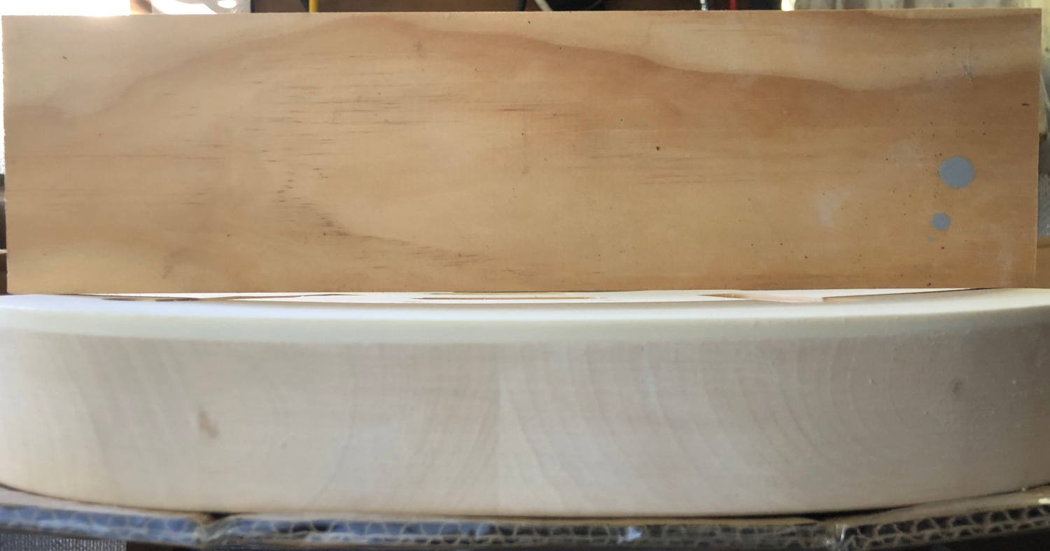

    Unfortunately, the body has a bow in it. It didn't when I received it - I think it's a result of me storing this kit in my shed for the last few months, while we've been having near 100% humidity in Sydney.
    Right now I'm thinking I just need to put this somewhere with low humidity, and hope it fixes itself (a bit.)
    1,981
    Hi Jon,
    shame about the bow - hopefully it can be sorted out. It was not noticeable in the first picture.
    Has the body also bowed on the back? Is it the whole body that has bowed or the ply top? Would clamping it help? Just typing out loud here!
    Member jonwhitear's Avatar
    Sydney, Australia
    262
    Yes, the whole body has bowed, so the back is convex. Clamping it sounds like a good idea.

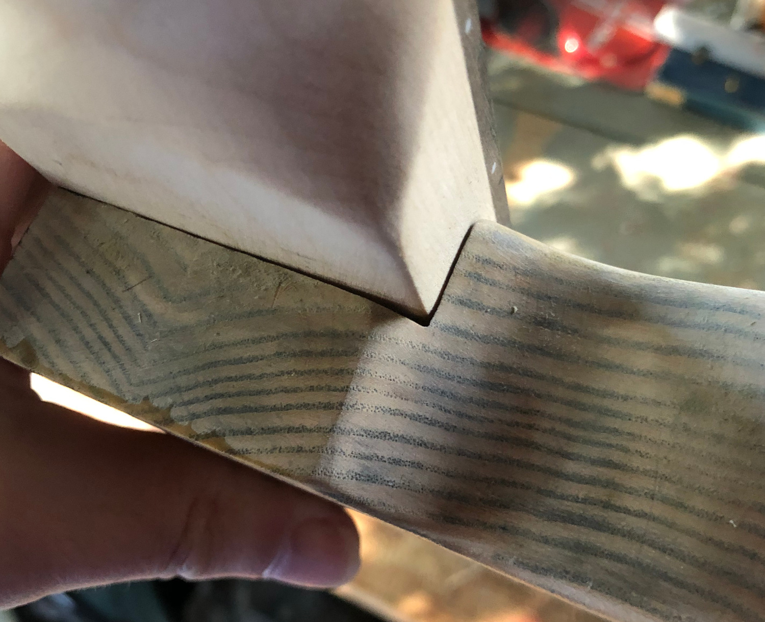

    Just getting going on it again, and I'm struggling to get a nice fit with the neck. Here are a couple of photos. This is with a different body -one that I know has an OK neck pocket.
    It looks like to heal of the neck is curved. How would I go about flattening that out?
    1,981
    Hi Jon,
    sorry to hear that you're not having much luck with this build.
    With my PB tele style necks the neck heels are close to 24 mm (only measured with a mm ruler and bad eyes!). Is it that your neck is less than this on the short side , or more on the high side. This may help to determine whether you can take material off, or if you need to add a shim.
