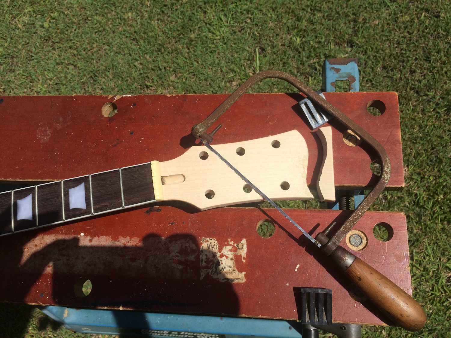

    First job shape the headstock. I avoid using propriety shaped headstocks so have decided on something simple. So out with the trusty/rusty fret saw.

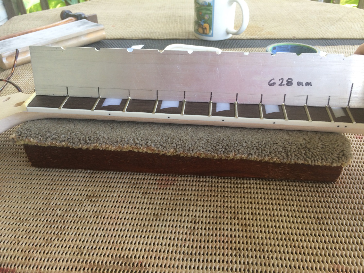

    Then I used my DIY notched straight edge and adjusted the truss rod.

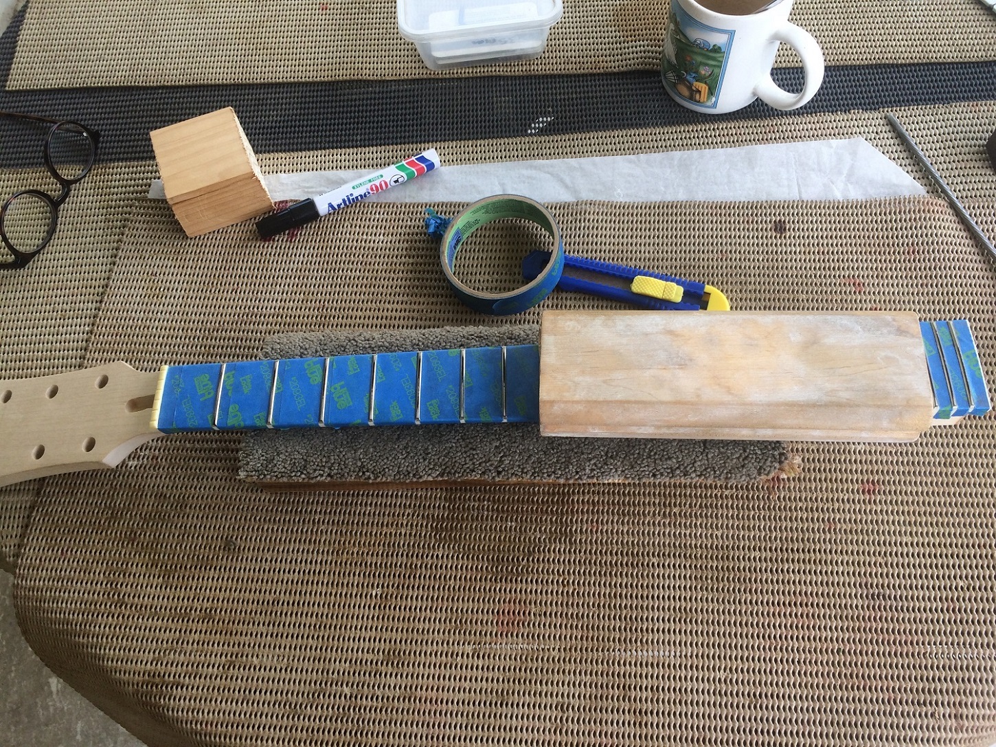

    I make sure the all frets are seated properly, tape off the neck, and level the frets using a 12” radius block.

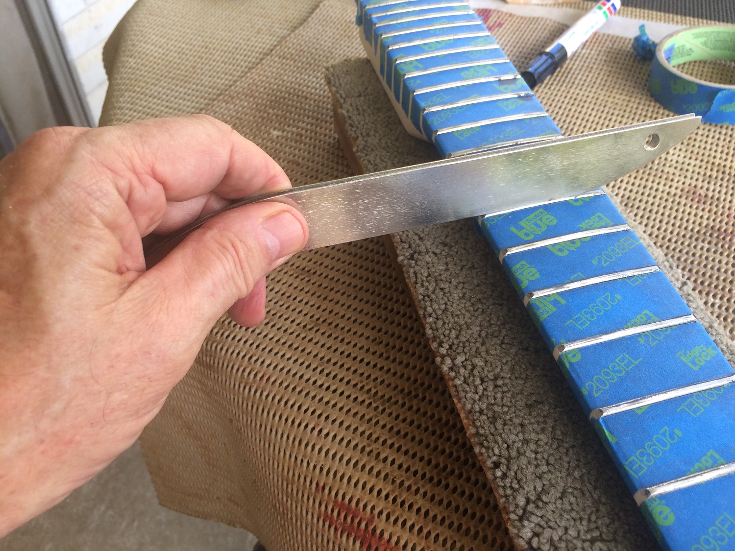

    After levelling the frets I re-crown them with a fret file.

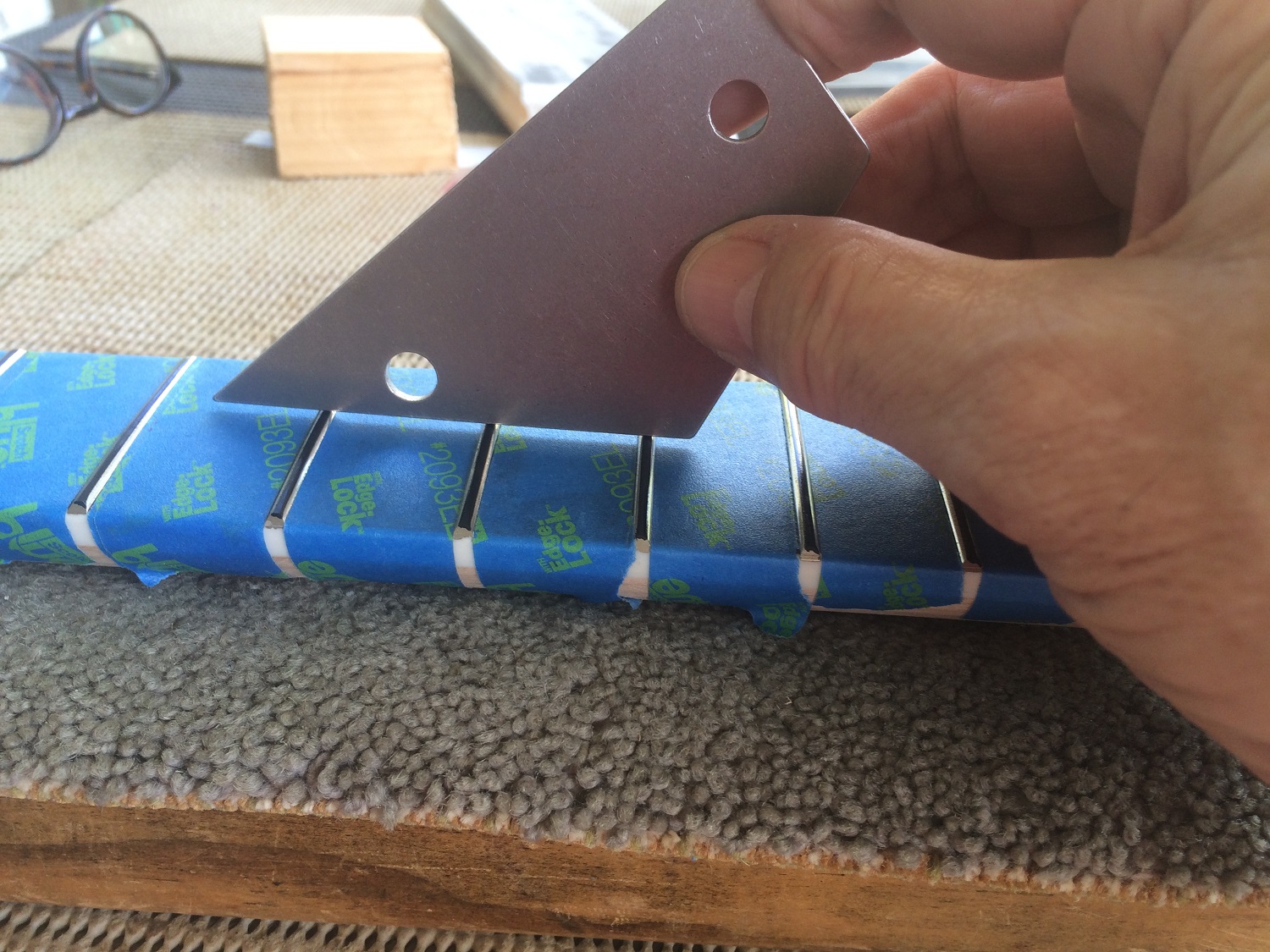

    I then like to double check everything with a fret rocker.

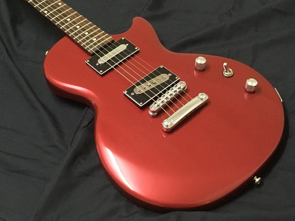

    My take on this concept last year resulted in my "Les Tele".
    Not a scratch build, but it was made with heavily modified pieces and parts.
    Look forward to seeing where your journey takes you.
