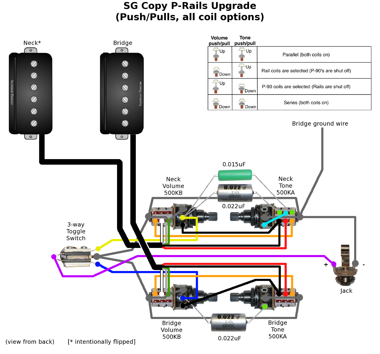

    Thanks WeirdBits, that sounds like what I need. Do you have a diagram I can follow? The closest I can find is a jimmy Page mod
    This will hopefully have you covered:
    It’s a layout using P-Rails with standard SD colours: black +, white/red, green -. The neck pickup has a little extra with capacitor switching: series humbucker & P90 uses a 0.015uF and it swaps to 0.022uF for the parallel humbucker & rail. If you don’t want cap switching just use the bridge pup configuration for the neck as well. Here’s the relevant post in my build thread.
    If you need something more specific for your build, just ask.
    Linear pots on the volume, Weirdy? Not normal. I’ve got one P-rail pickup on a guitar and that works just as expected with audio/log taper.
    Some like linear pots on volume for a more consistent taper. Volume doesn't jump so much between 10 to 8 and then shelving below. Way more gradual which some people prefer. I like 500ka with a 220k resistor across the input and output lugs for a more gradual taper which turns out to be something between a log and linear taper.
