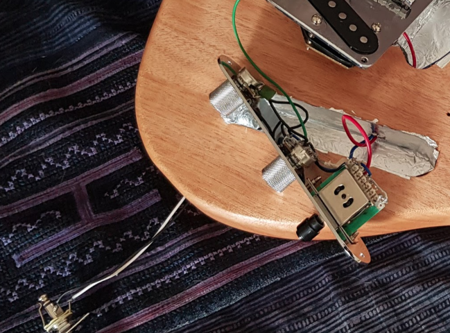

    I have just about completed building a TL kit and have a strange problem with the electronics. Everything works, however have 2 things happening that seem strange to me.
    1. When volume is on full or off completely the guitar is silent, ie no background hum, which is good. When volume is in the middle though there is a significant hum. So when turning the volume knob from 0, hum increases as volume increases, until it reaches the middle when it then start decreasing and is gone when it reached full
    2. There is no hum when selector switch is in the middle, however slight hum when in either bridge or neck pickup position
    This hum is a much lower hum than in 1. above.
    So overall best situation is with volume on full and switch in the middle, guitar is then almost completely silent
    Any idea what might cause this?
    I shielded all the cavities and be the pick guard with aluminium tape, and connected them and tested all over for continuity with a multimeter, so think my shielding is pretty good
    Thanks

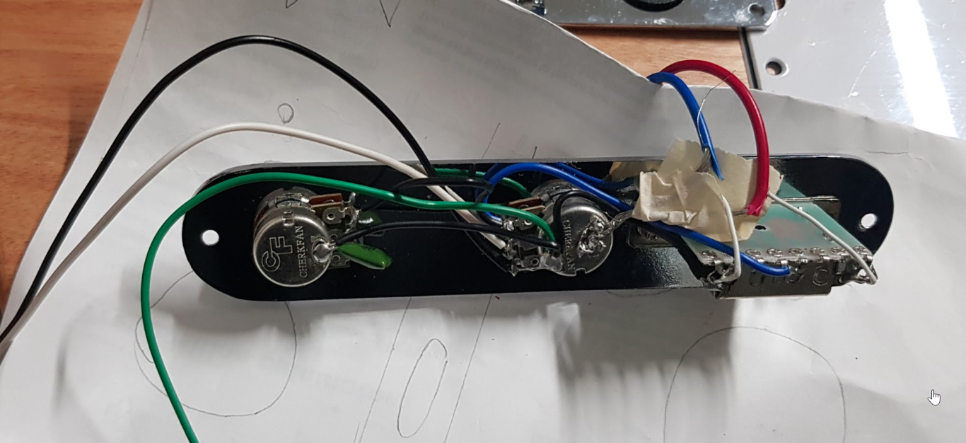

    Posting some pictures of the wiring and shielding will help us to see if anything obvious is amiss. I know its partly pre-wired at the factory, but they don't always get it right.
    Thanks, really appreciate the detailed response.
    I haven't even opened the cable that came with it, but will take your advise and chuck it out! The cable and amp work fine with other guitars so don't think there is any problem there.
    I have a multimeter and did test the grounding but am now doubting myself and will check it again.
    I think my soldering on the back of the volume pot leaves a lot to be desired so that could well be the issue.
    Some pics below. I actually ripped offl all the shielding shown in the pics and did it again much better, so disregard that. i also ran some bare copper wire between the cavities and tested continuity

    All the connections look OK and the output jack is correctly wired.
    What solder did you use? The pre-wired stuff will be using lead-free solder. I still use 60/40 lead solder at home as it's easier to use and melts at a lower temperature, so is less damaging to electronic components. But it doesn't mix with lead-free solder, so if you are using leaded solder, then I'd make the back-of-pot connections on a different part of the pot to be sure of a good electrical connection.
    But if your ground path resistance measurements are OK, then it may be down to a damaged volume pot (though I've not experienced this particular issue before). I'd be tempted to get another couple of mini pots (250k log/audio short split shaft - 18 spline) and re-do the controls. I'd also modify the pickup leads so that there was a short length of braided wire that goes to the rear of the volume pot and a much longer length of the insulated central core signal wire that runs to the selector switch. It saves having to use masking tape to stop any inadvertent signal shorting.
