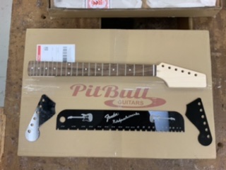

    I created on Illustrator two files, one is a jig for the guitar headstock. The other jig is a notched straight edge that I figured I may need for straightening the neck.

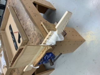

    The third jig i thought would be beneficial is a notched clamp. That way throughout any work on the neck, I could easily clamp without worrying about damaging the frets. I created this first by aligning a piece of wood with my guitar neck, using a tri-square to line the timber, and then used a coping saw to cut out the notches. After messing up a few of the measurements, I gave up and cut and fixed that line work on a radial arm saw.

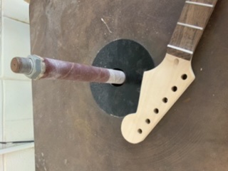

    I decided on going with the 50s Classic Strat headstock, for the most part...I wanted the classic look, but didn’t worry if it wasn’t exact. Good will be good enough for this. I clamped to the table, using the jig and some of the cardboard provided in the box, and used a coping saw to cut the neck to shape using the headstock jig i created earlier. I then used a bobbing sander to ensure i had a straight cut and to sand it down. I’ve yet to round off corners or hit it with anything other than the sander, so various grits of sandpaper await me tomorrow.
