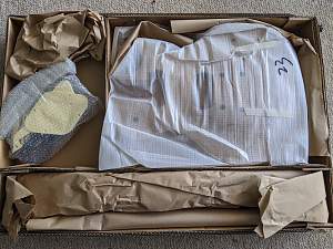

    Obligatory arrival and impressions pics:

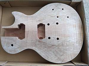

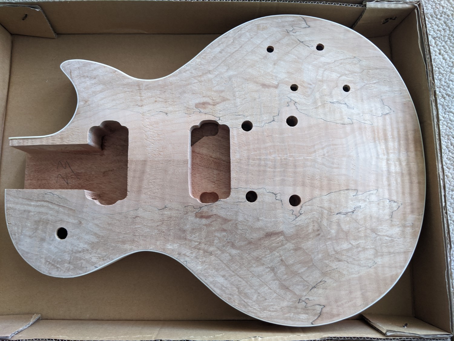

    I'm super duper happy with the Spalt top. Still got some flame, and a not-super-crazy spalt through it.

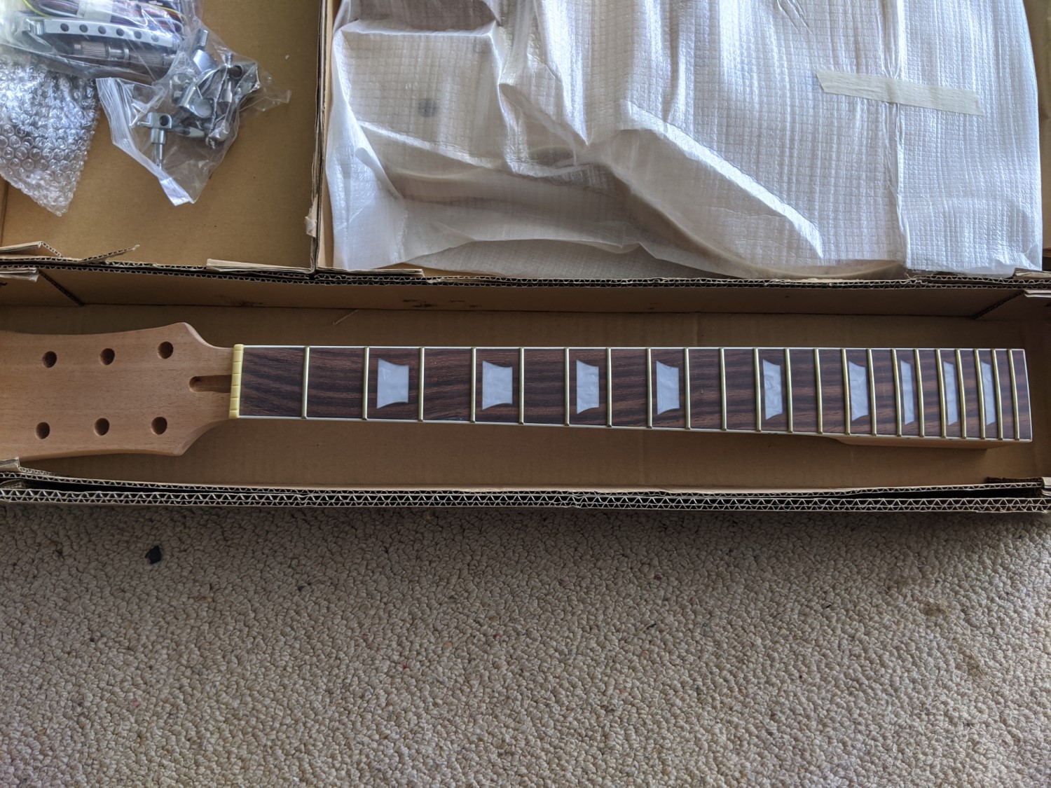

    And likewise with the fretboard. I like the grain on it a whole lot.
Name:	IMG_20200310_133128 (Custom).jpg

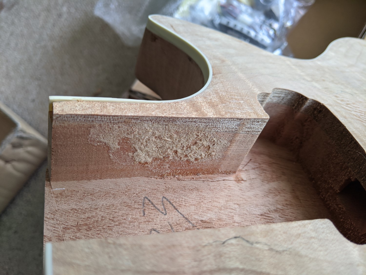

    I got a bit concerned by this at first, thought it looked a bit sloppy, but test-fitting the neck in there it fits together and covers it up properly.
Name:	IMG_20200310_133507 (Custom).jpg
    Yup that's some excess glue alright. Haha
    Happy with how it's looking so far though.

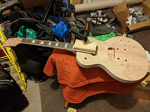

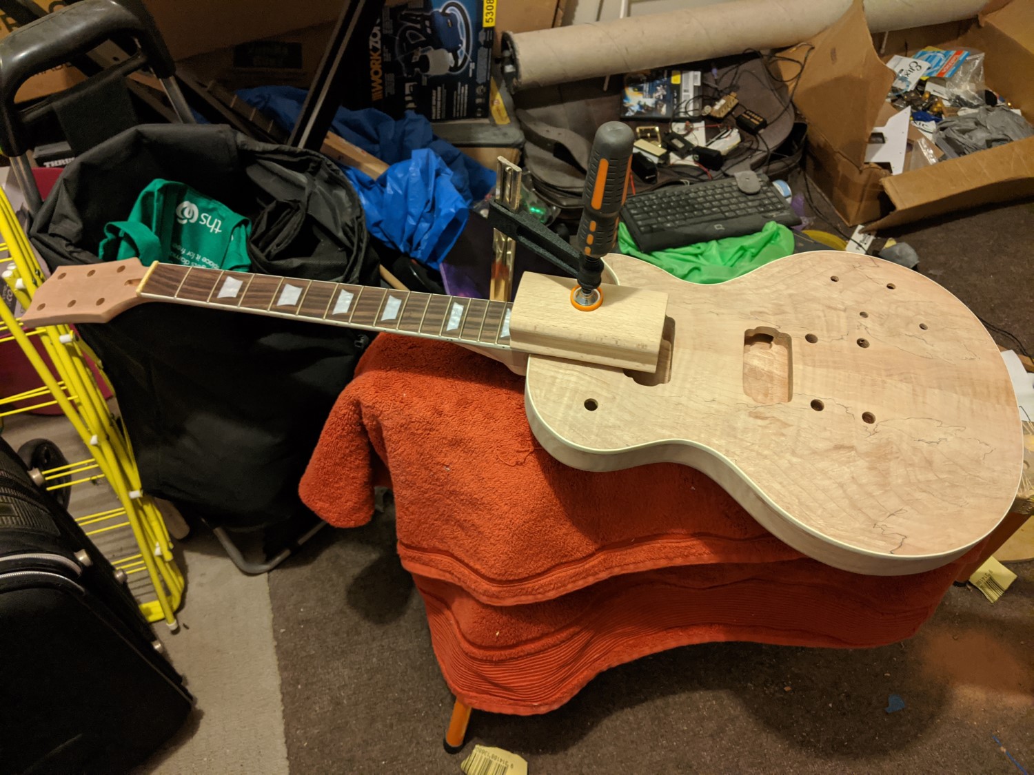

    Neck glued, and drying right now:

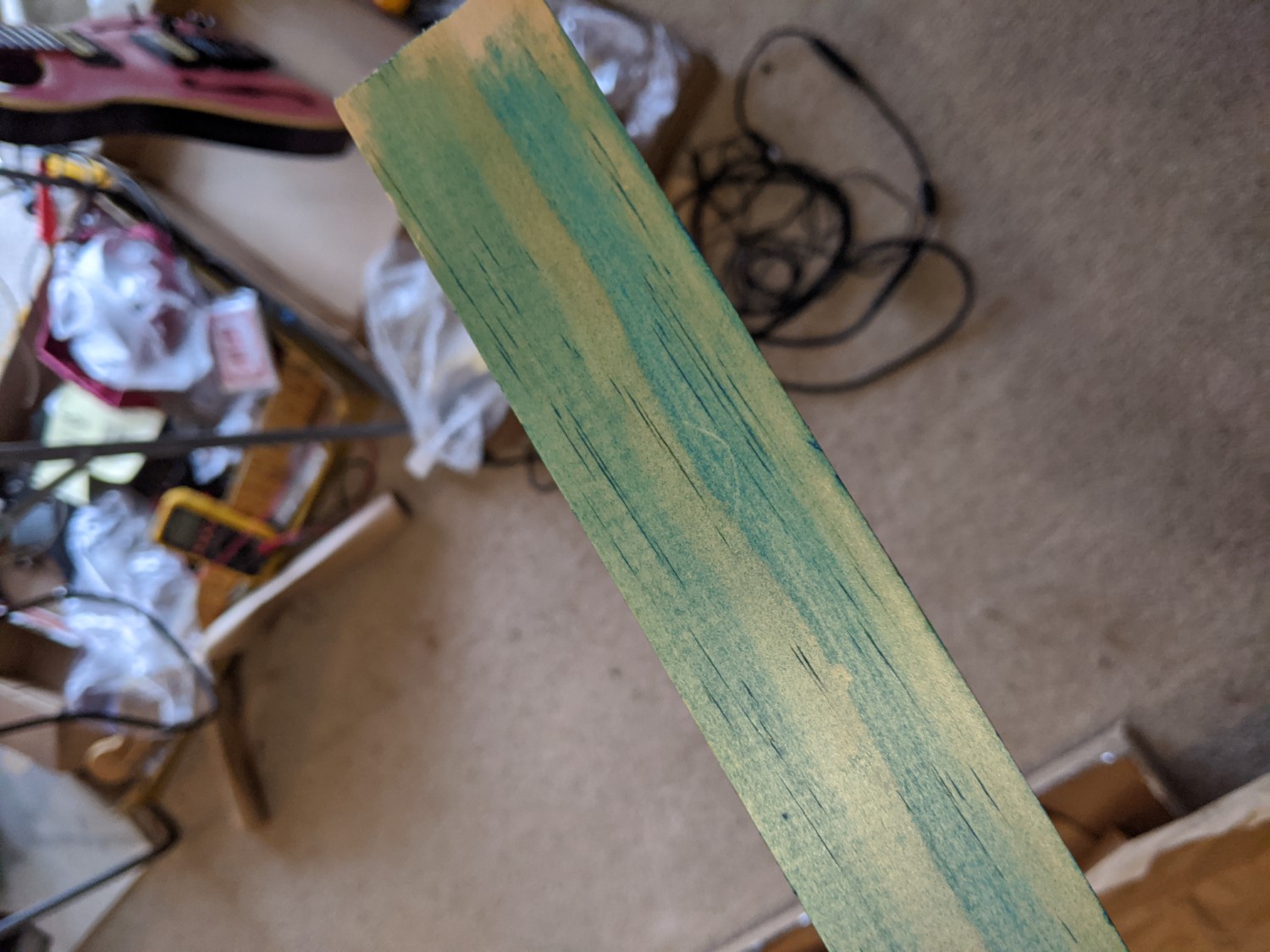

    On that topic, I did a couple of quick tests last night on a spare piece of pine I had. Not the greatest analogue for either Mahogany or Maple but I just wanted to test ratios, and techniques. You can do it either by going paint straight on to wood, pushing it around, and then oil on top, which thins it out to more like a stain. Or you can straight mix them.
    These tests were small amount of Blue mixed in, large amount of Blue (basically JUST enough oil to mix it in properly). The small amount test does border more on green and isn't much of a colour change, but the large amount looks fine.

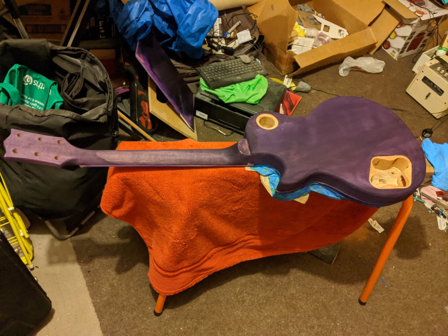

    Turns out I can't resist making things purple...
Name:	IMG_20200314_203741 (Custom).jpg
    God the lighting in my garage is awful... But yea since I had some left over after my Headless kit, thought I'd opt for this.
    So it's only the back done purple, and there is justifications for it. 1) I'm not as certain how the Blue will go on the Mahogany, 2) I'm not sure how much that little tube will cover, 3) A darker colour on the back will make the lighter blue pop a bit more, 4) The purple stain I have goes on a bit easier, and will be easier to scrape from the Binding. And 5) I just like purple.

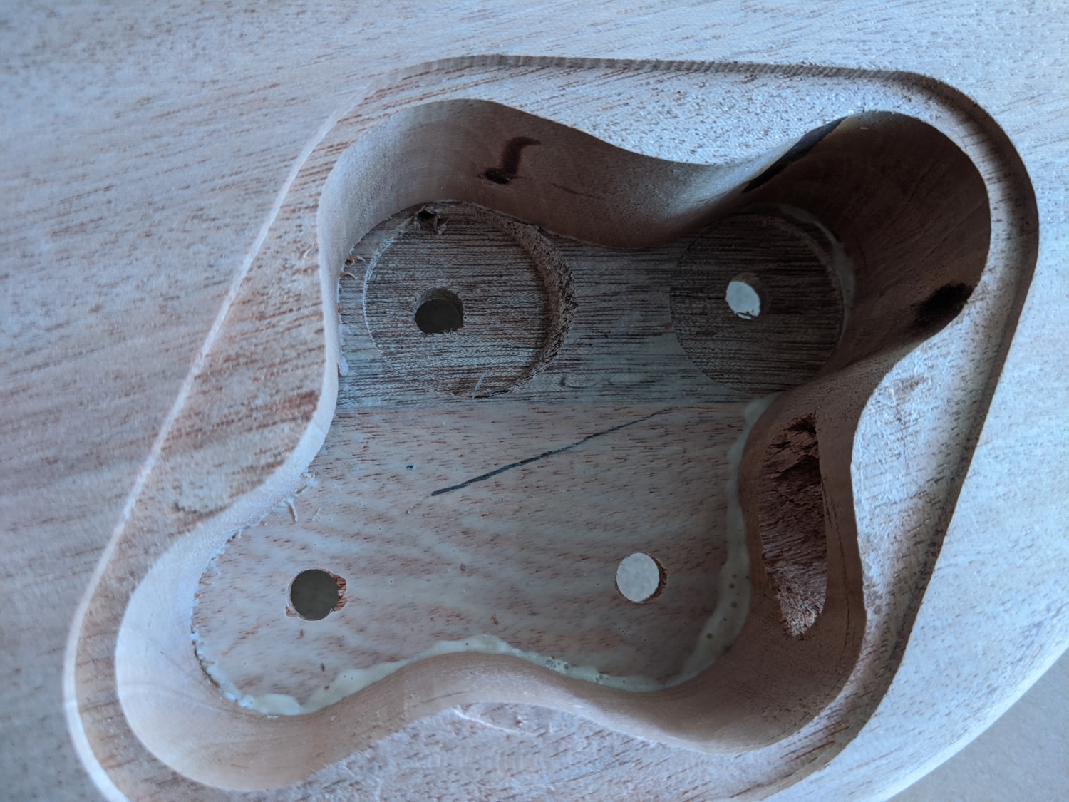

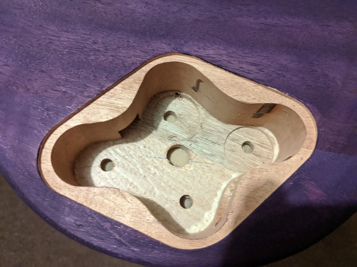

    S/S/P Toggle hole drilled.
    Doot doot first layer of paint on.

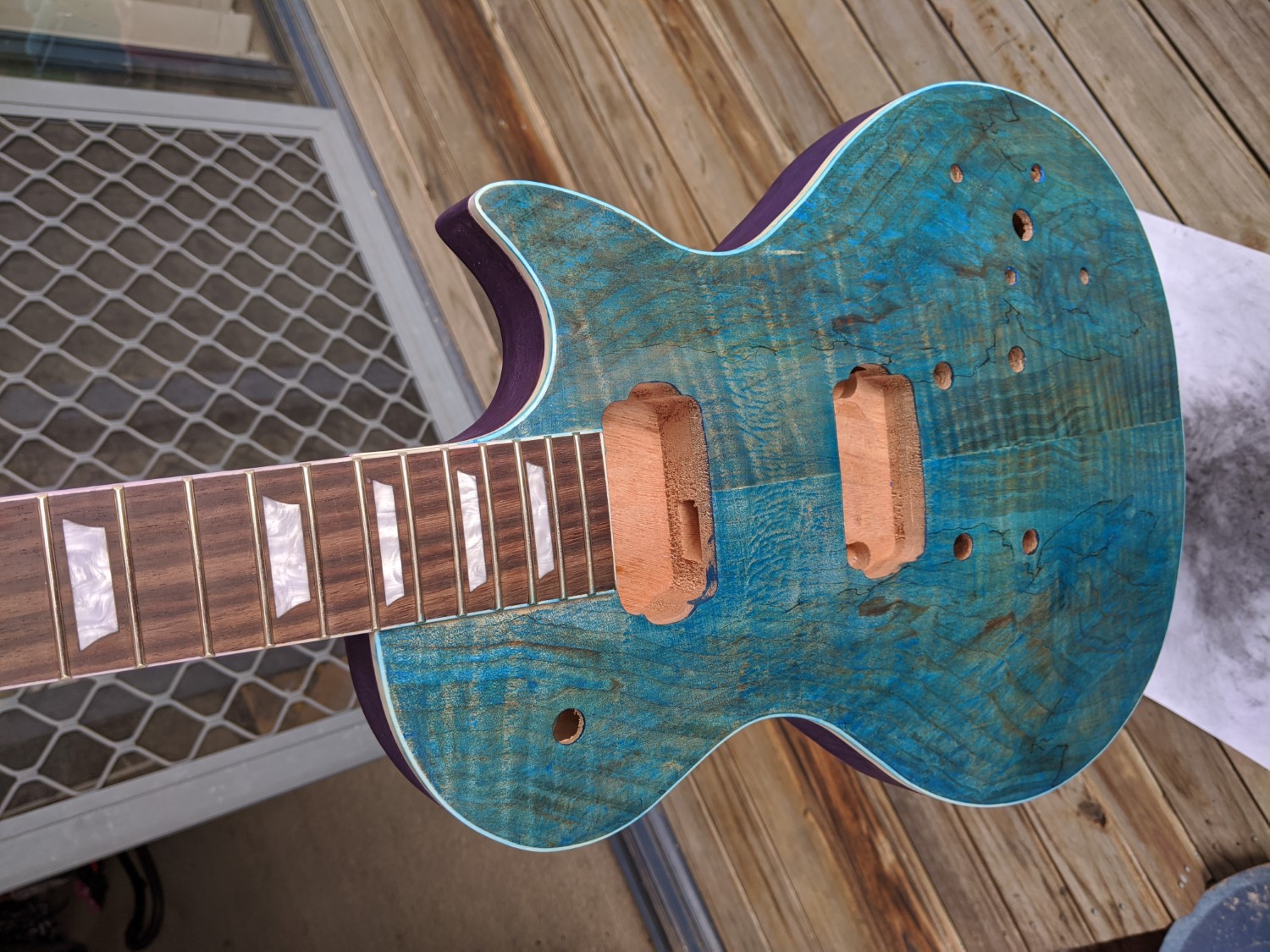

    I opted to do this by rubbing the paint across, then Tru Oil on top
Name:	IMG_20200315_172435 (Custom).jpg
    So yea, didn't come out like the Manganese blue that it was, more of a Denim blue
Name:	IMG_20200315_172442 (Custom).jpg

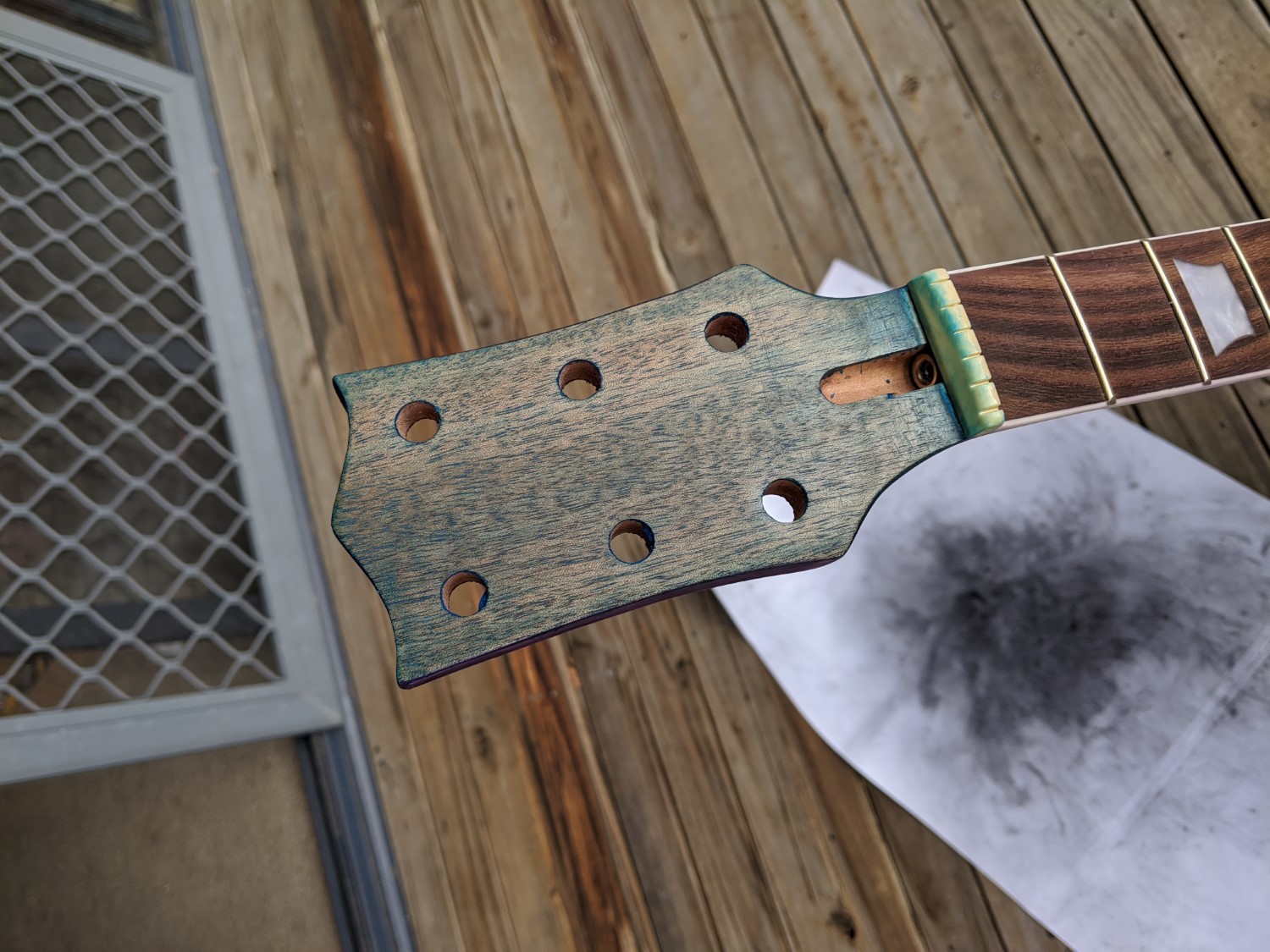

    Headstock matches pretty decently, bit more than the pictures show

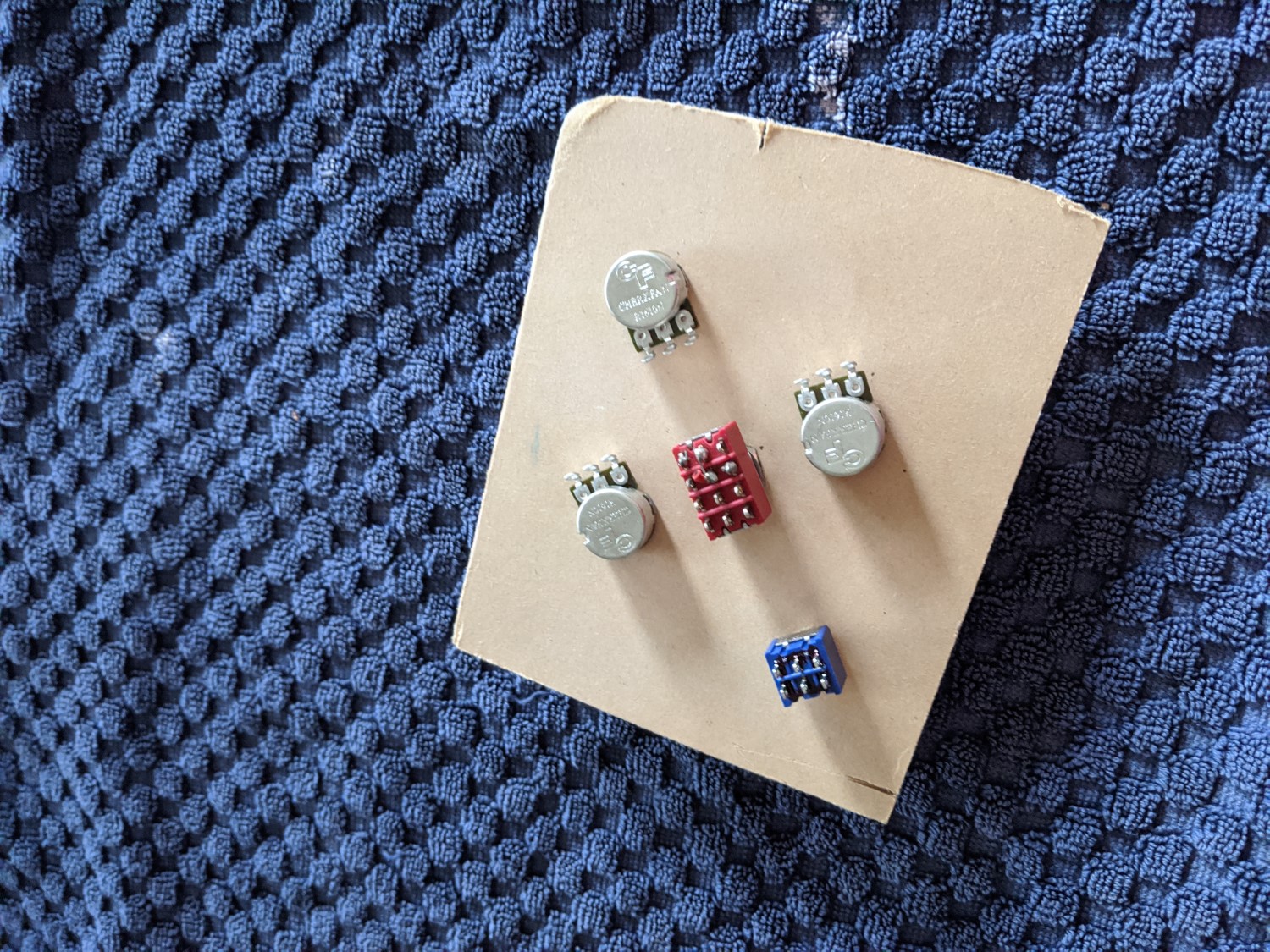

    Also gonna be more sensible for a change and prep most of the wiring outside the guitar
