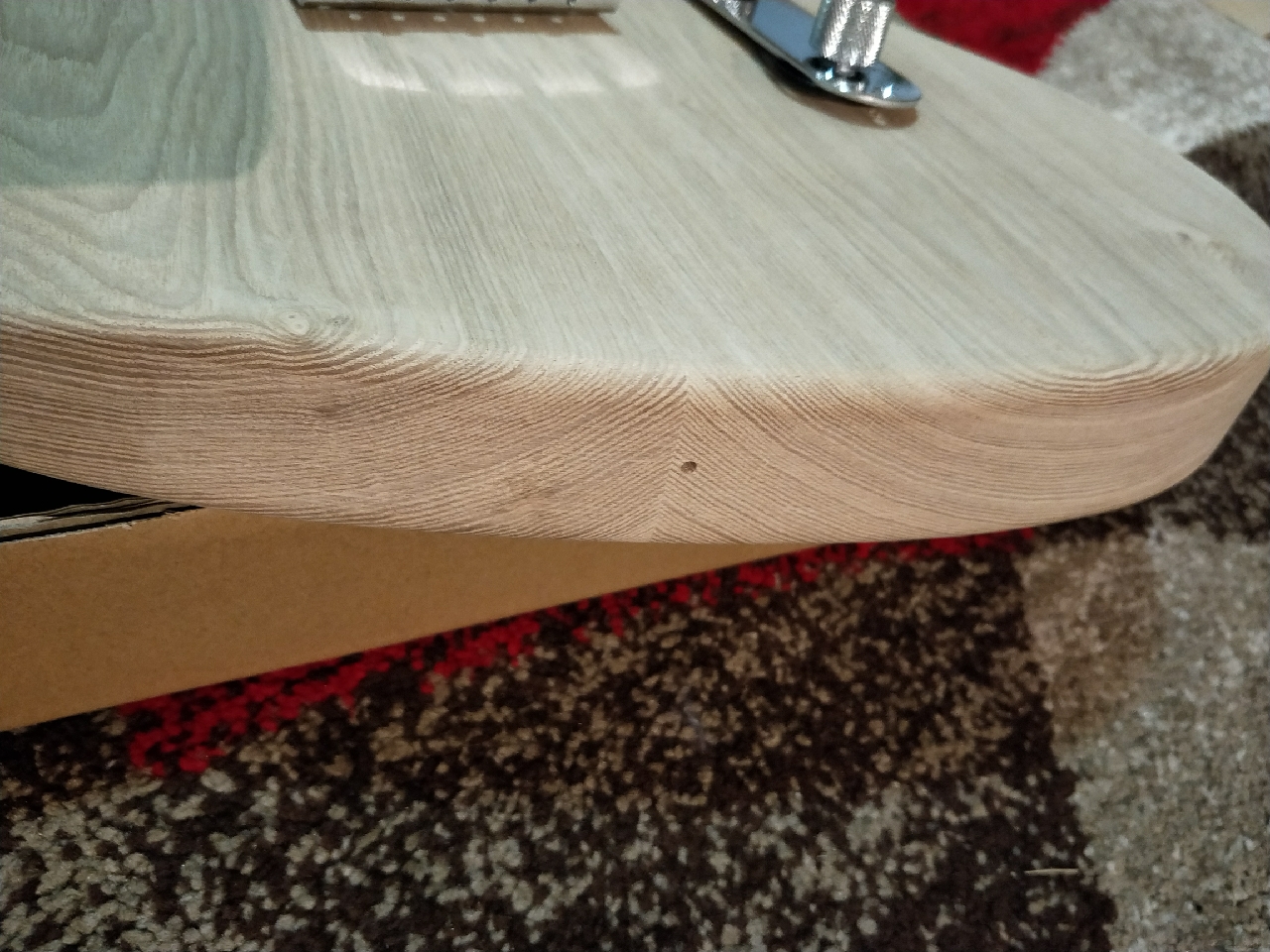

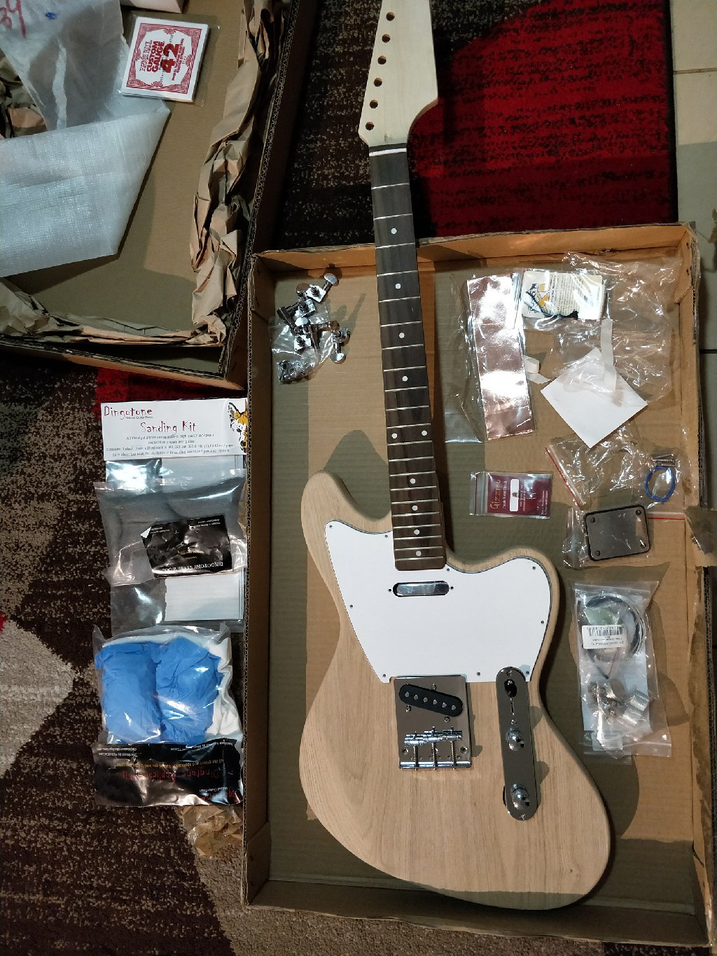

    Having played Fender Jaguars & Teles for 20 years, I wanted to build something along those lines. The JTL-1 kit was the best of both worlds for me, offset shape, and simple tele controls.
    The jaguar tremolo was a must though, as I use it in a lot of the songs I write (shoegazey MBV/Ringo Deathstarr etc). So, this is where the challenge for me is going to be.
    Box arrived in good shape and thanks to Adam for swapping to a rosewood Fingerboard.

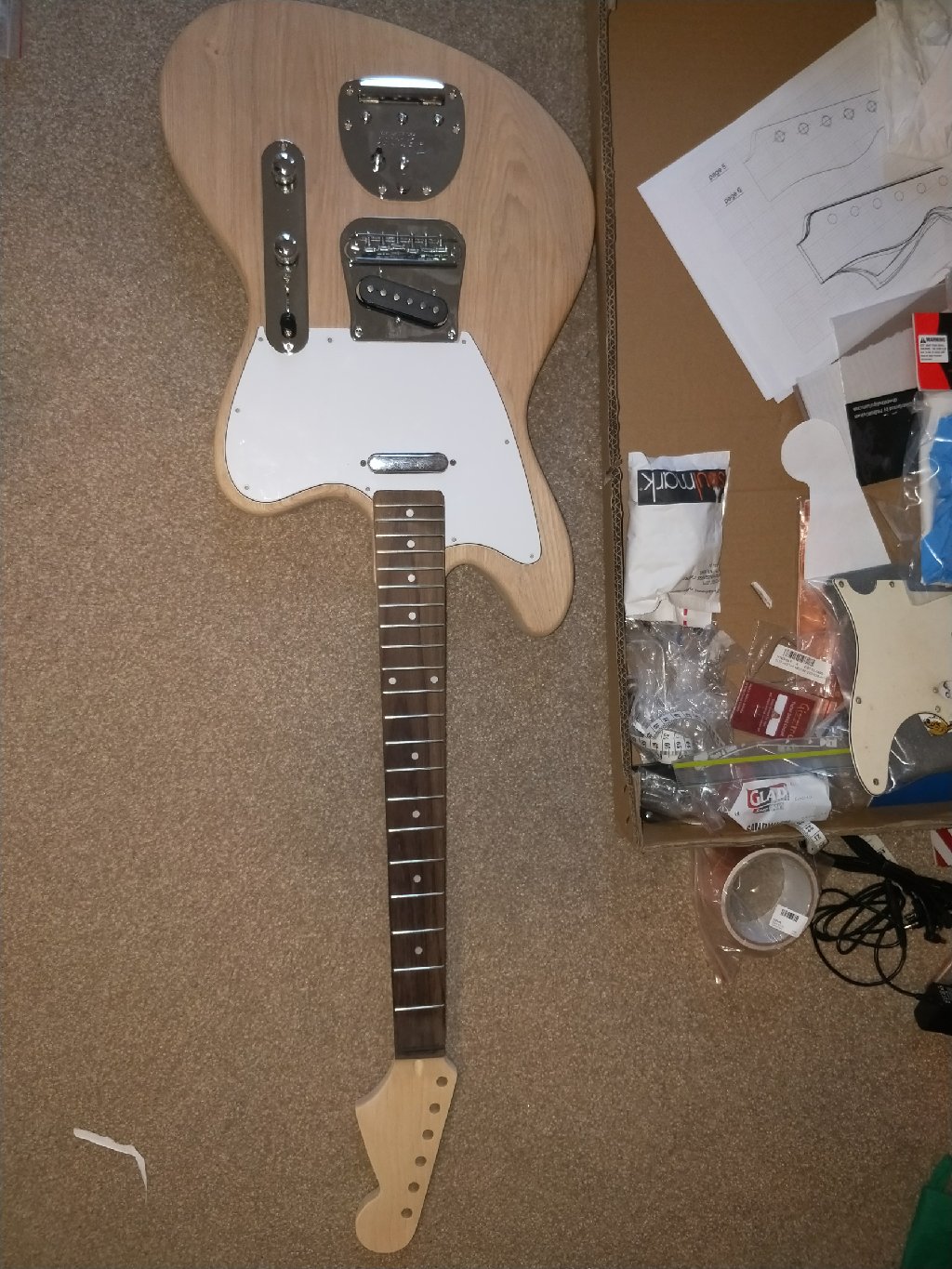

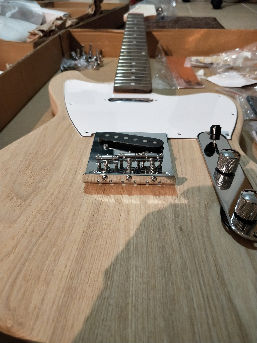

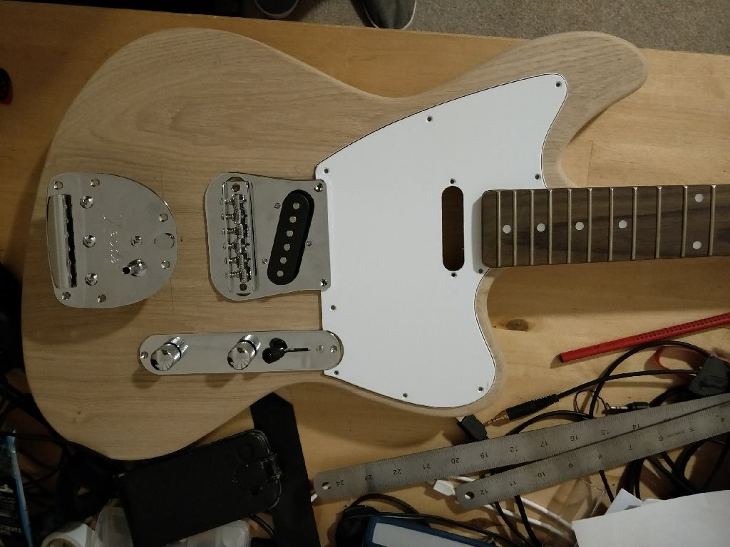

    I've upgraded to the gotoh tuners, and got the tele controls upgrade kit from PBG, along with a Tusq nut.
    I got a 62 reissue fender jag/jazzmaster tremolo off ebay, and after much deliberation, went with a WD Bigsby Bridge and plate. I went with the vintage style bridge as it gives me the option of making small adjustments in the string spacing like my mij jag 62 reissue(the am pro jaguar, my main guitar, has 55mm string spacing at the bridge and it leaves the two E strings too close to the edge of the fretboard imo). Anywho, hopefully turn out like this pic, when I figure out how to route the tremolo pocket with no router heheh

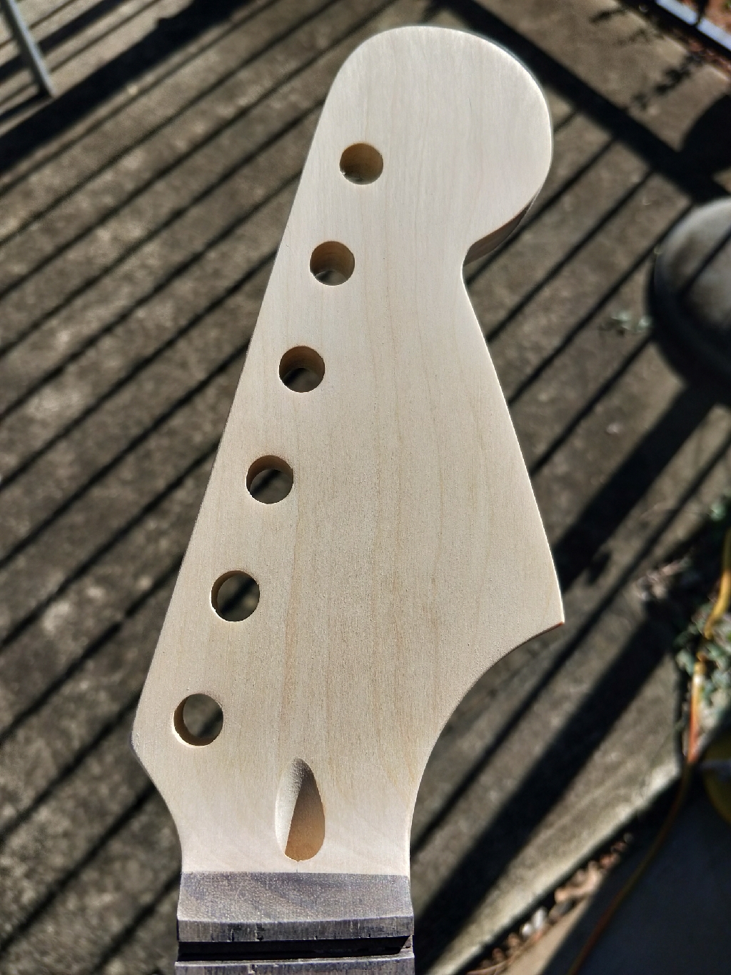

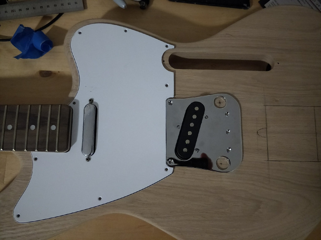

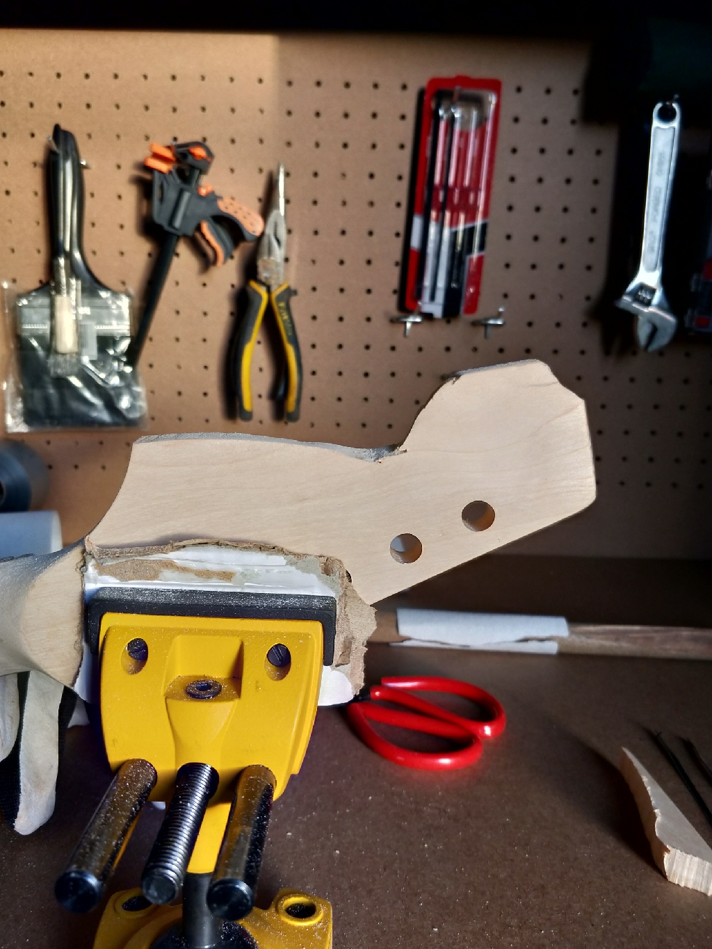

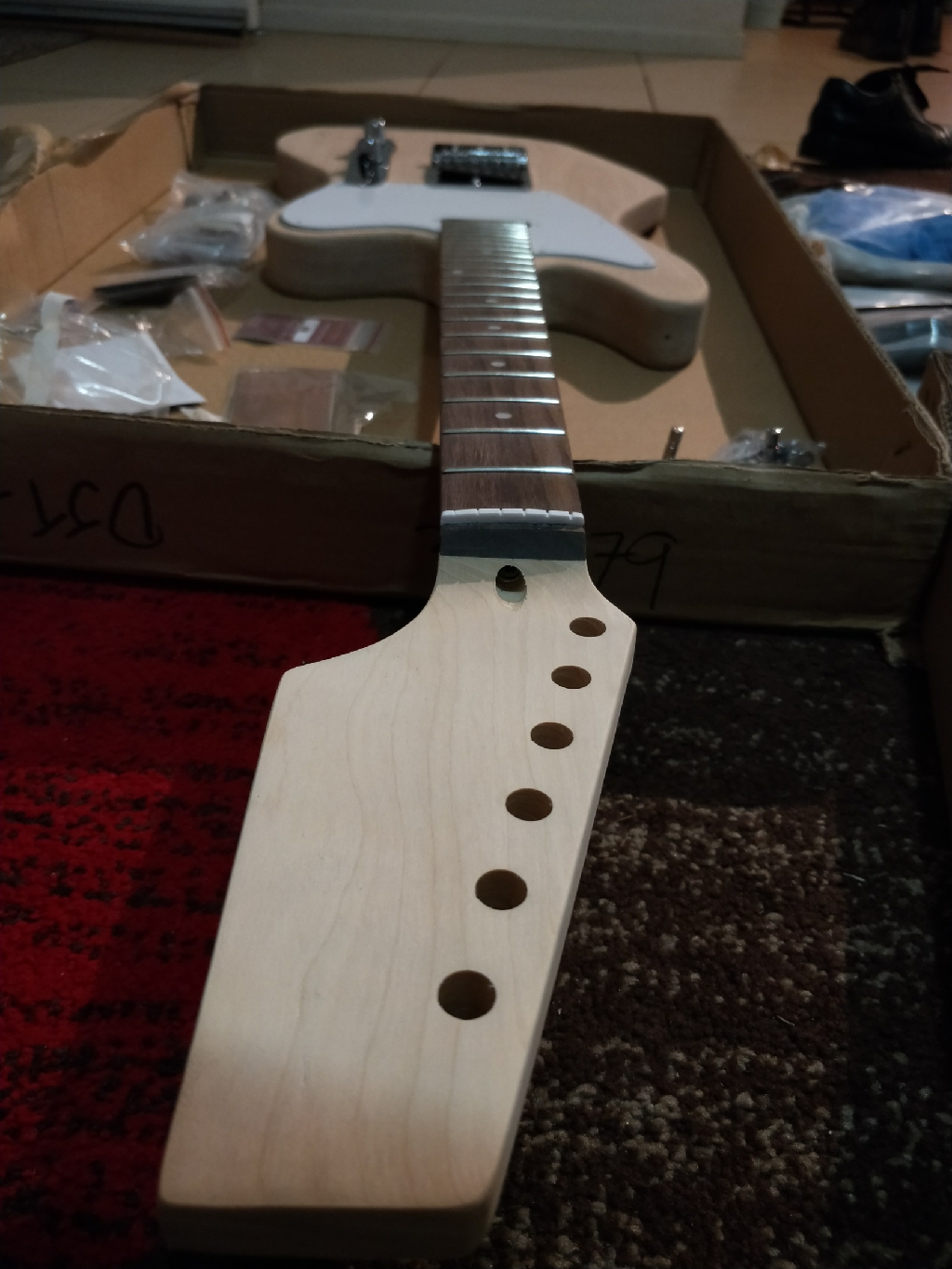

    Over the weekend and yesterday(show day holiday in Brisbane), I got stuck in to cutting the headstock, and a bit of pickguard reshaping to accommodate the bigger bridge plate. Went through a couple of coping saw blades, I think they melted. The blades seemed to get super hot. I was happy to get a reasonable looking headstock shape & taking it super slow on the pickguard, it came out OK too.
    I had a 1991 tele neck pickup left over when I had a push pull split humbucker put into my tele years ago, so I thought I'd use that. Seems the pickguards pickup hole and screw holes were about 2mm too short for this pickup, so I lightly sanded till they fitted OK.

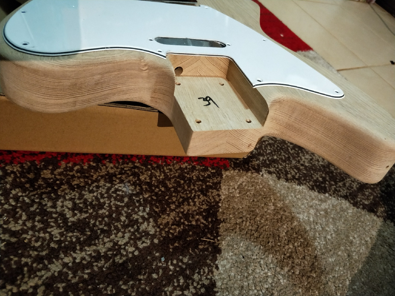

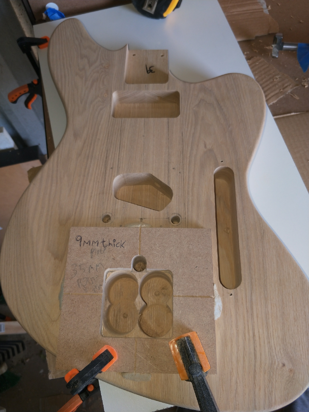

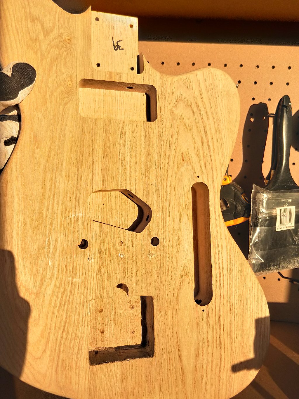

    Over this last weekend I routed the jazzmaster style tremolo pocket without a plunge router, which I thought I would mention in case anyone else tries the same.
    Using a routing template I got off ebay for $20 to help with alignment, and a set of forstner drill bits, for around $15 off ebay, I set about drilling 4 holes for the main section using the 35mm forstner bit, and the 15mm forstner bit was perfect for the "bump" at the top of this rectangle.(where the locking switch on the fender trems are)
    I taped some painters tape to a depth of 35mm on the forstner bit, to give me a depth guide so I didn't drill right through the body. Then a few smaller holes to catch the corners with a Bradford bit. Tiding up from there, I used a set of chisels, which went a lot better than I was expecting. Little bit of sanding just to smooth it a bit. I'm not too fussed with the perfect hole since it's going to be covered, so just needed to be neat-ish.
    When I first started this, I used a drill guide, as I had just drilled the new bridge post holes. I found the drill guide more of a hindrance than a help. As I was going to have to clean up the cavity anyway, I didn't mind if it was perfectly straight, so free hand drilled these.
