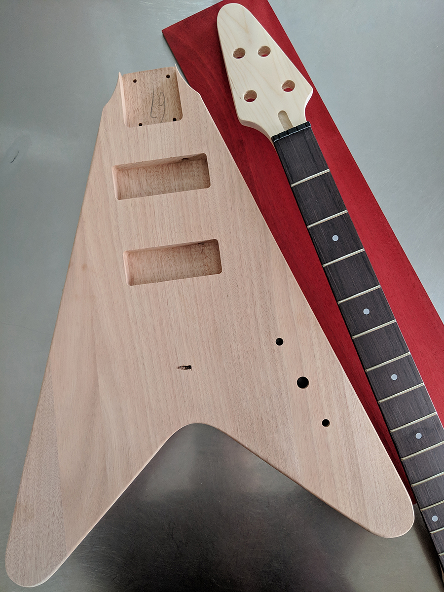

    Received my FV4 kit this week! I had been checking this kit out for a while. When I saw it was available in mahogany, I finally pulled the trigger.
    I'll be upgrading the pots, switch and jack. The jack has a radius to it for a rounded body, not flat like the wing of a V. Not sure about the pickups yet. I'll test them first, but will likely go with ceramic humbuckers like the ones in my old Thunderbird.
    Impressions out of the box:
    I could have sworn I opted for the bone nut and copper shielding, but I can find no evidence I did. I can live with the plastic nut and have ordered shielding, because you just can't not shield.

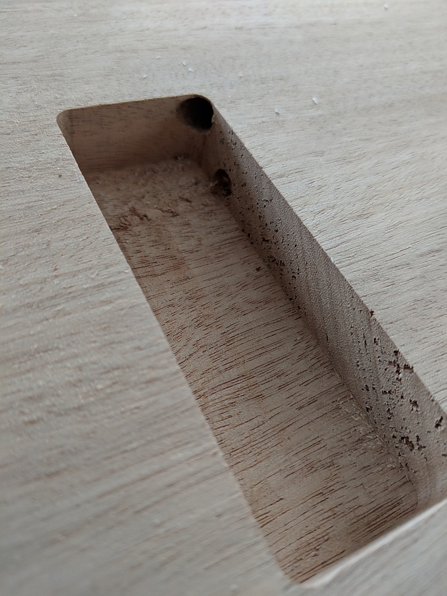

    There's some inconsistent routing, but nothing I can't deal with:

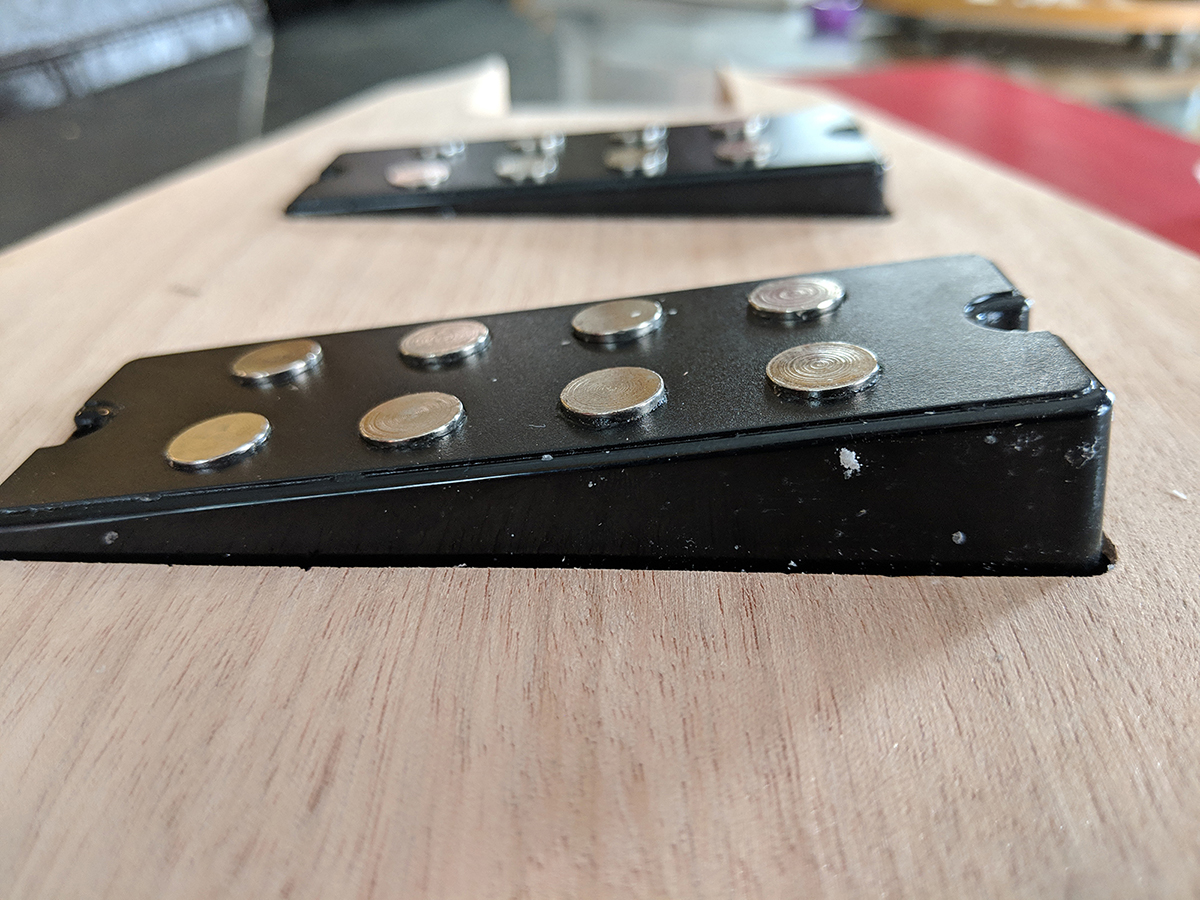

    Here's something, though:
    The channels for the pickup leads are so high, I'm going to need action of ~1.25 cm above the fretboard on the G string:
Name:	pick height.jpg
    Or I will just drill new channels.

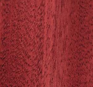

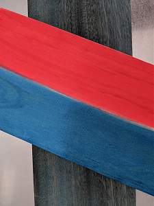

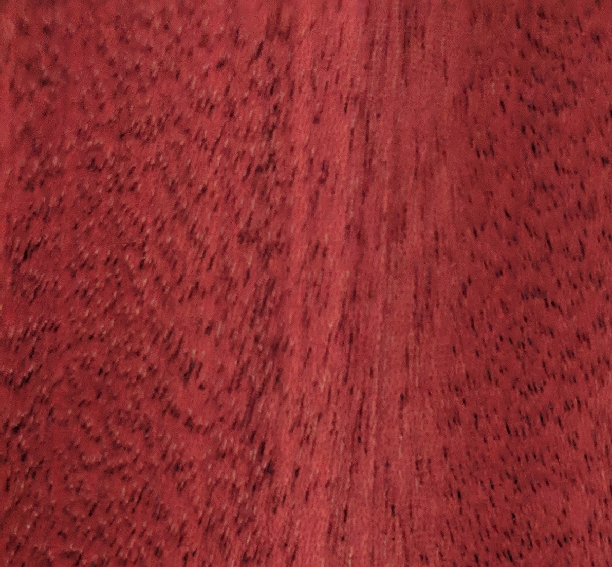

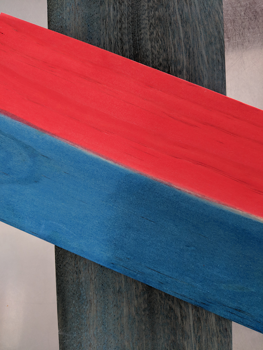

    For the finish, I am using Keda wood dye (www.kedadyeinc.com). It's a powdered dye, I'm using an isopropyl alcohol/distilled water mixture.
    I'm testing on a few woods, as the mahogany of the body is much lighter in tone than any of the pieces I have been able to get my hands on.
    Red:
    Blue:
    Once dyed, I will use a water-based grain filler (AquaCoat) so I will be able to get a smooth finish.
    I haven't been able to locate any polymerized tung oil - which would be my first choice - because I can't get it shipped to my state. I will be testing tung oil finish (not pure tung oil), Tru oil and Danish oil. Will post pics when those tests are complete. Unfortunately, it is -6°F/-21ºC today, so that's going to be delayed a bit.

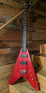

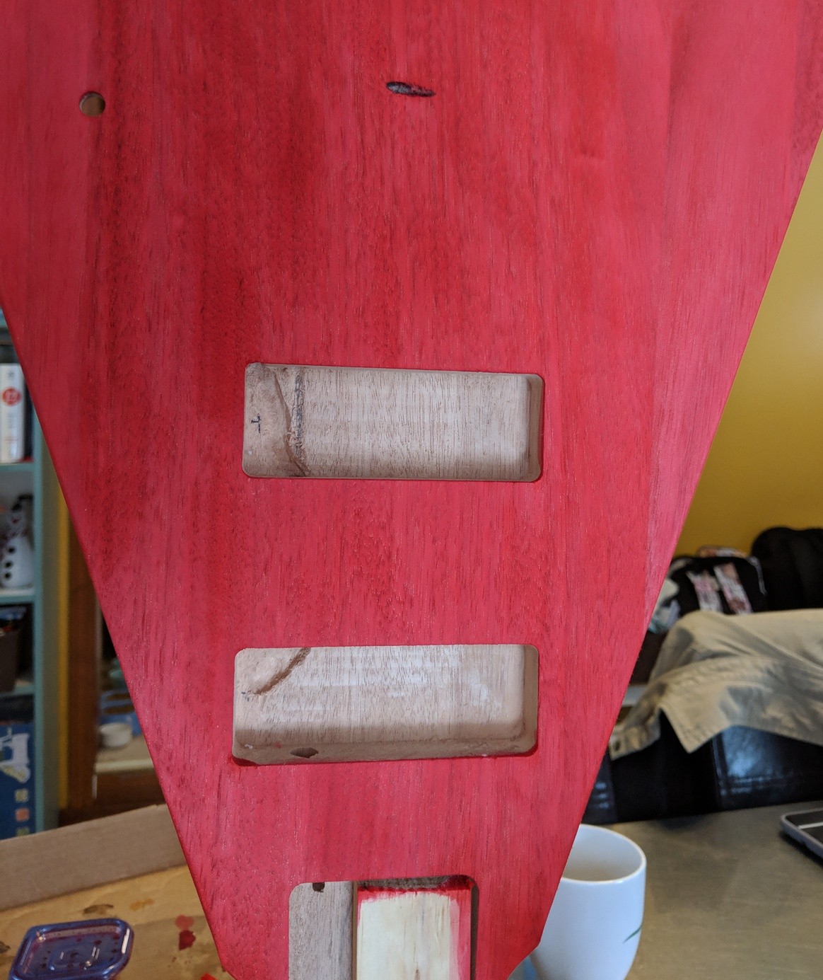

    And the winner is... Red dye with Tung oil finish.
    Next up: working through the body issues. I discovered the stock pickups are somewhat unique and I can't seem to find any after market pups that fit in the cavities without adding a pickguard. If anyone has any suggestions, I would greatly appreciate them. Or let me know if I'm nuts because the stock pups are actually good.

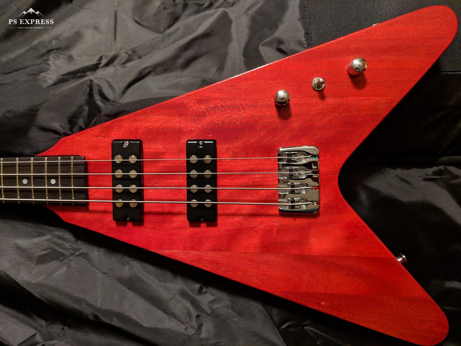

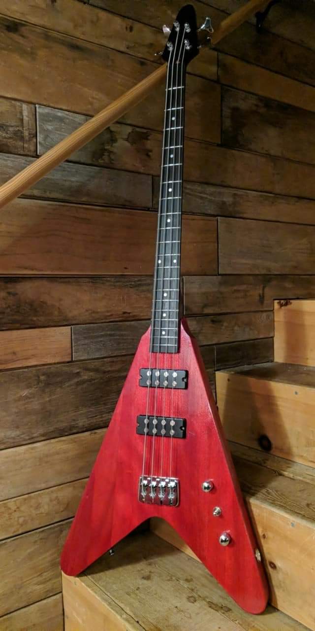

    10 coats Tung oil + 2 coats slurry

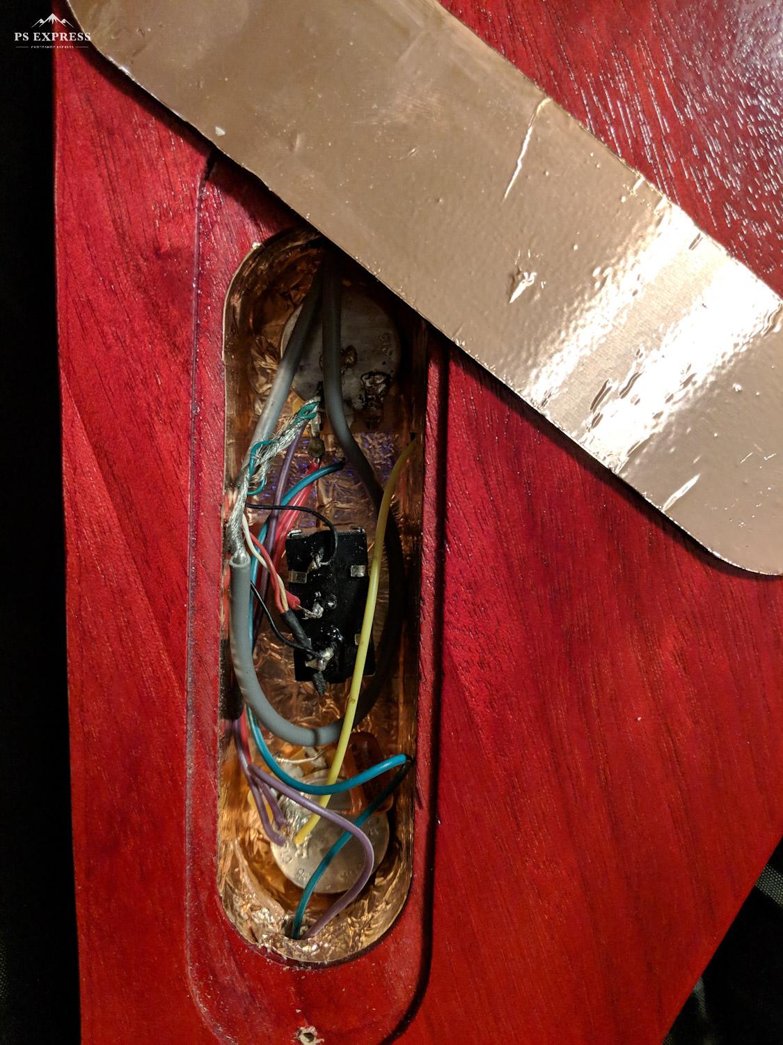

    Upgraded pots, switch, Jack and orange drop cap
    I surprised one if my bands at a show. They were blown away. It sounds as badass as it looks.

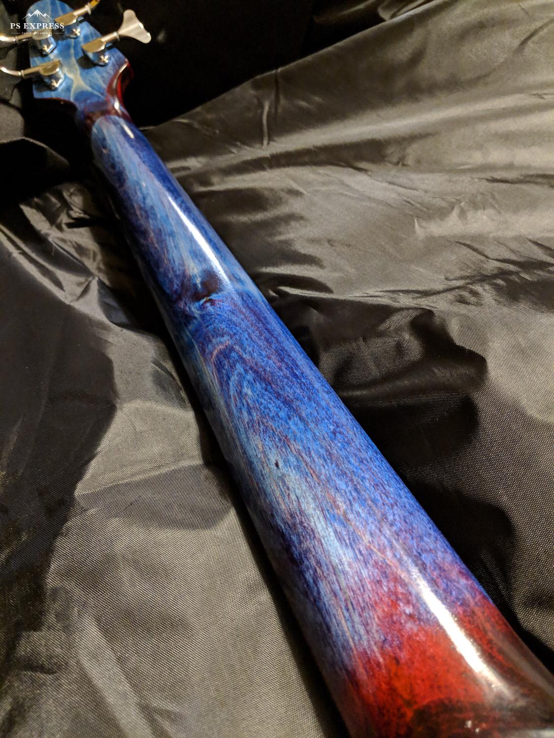

    More pics:

    Looks killer! Love the surprise of the blue neck and it seems like it came together really quickly for you.
