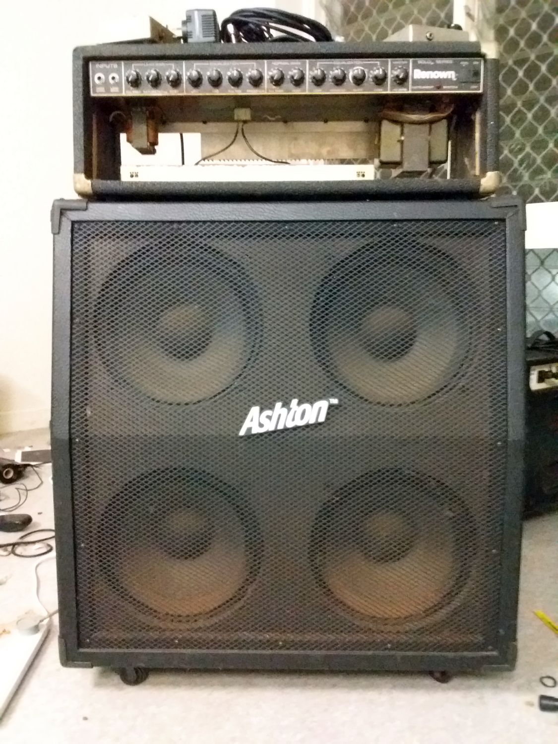

    Here's a pic of the Peavey Renown amp sitting on top of my Ashton quad box:
Name:	Peavey Renown Stack 2_resized.jpg
    The Peavey Renown is a 160 Watt solid-state guitar amp, I think it's probably about 80's vintage, seems to sound pretty good through the quad box and the clean channel appears to take pedals pretty well, I need to make a footswitch for it cause it doesn't have one, although there is a footswitch socket on the back panel, I'm going to see if I can buy a plank of wood from Bunnings this weekend so I can make a front panel for it, going to cover it in Paisley cloth if i can find some in Darwin, should look cool once I'm finished working on it, the red power indicator Led on the front panel will be swapped out for a blue one, my way of customizing it further.

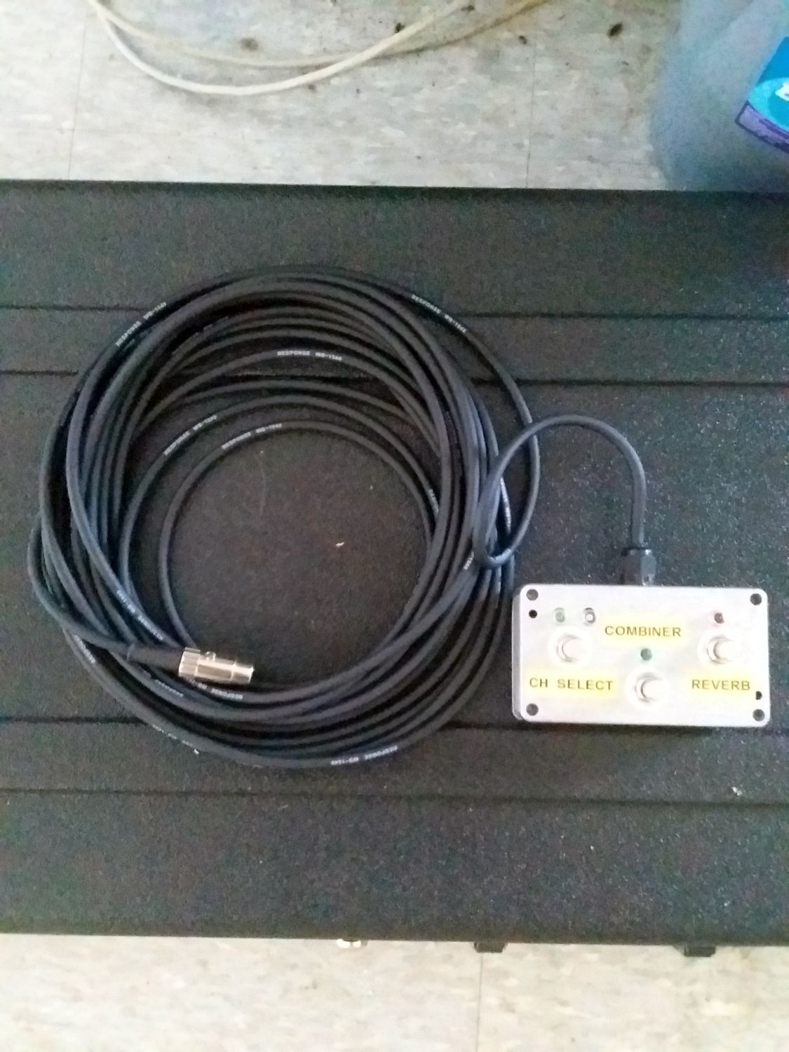

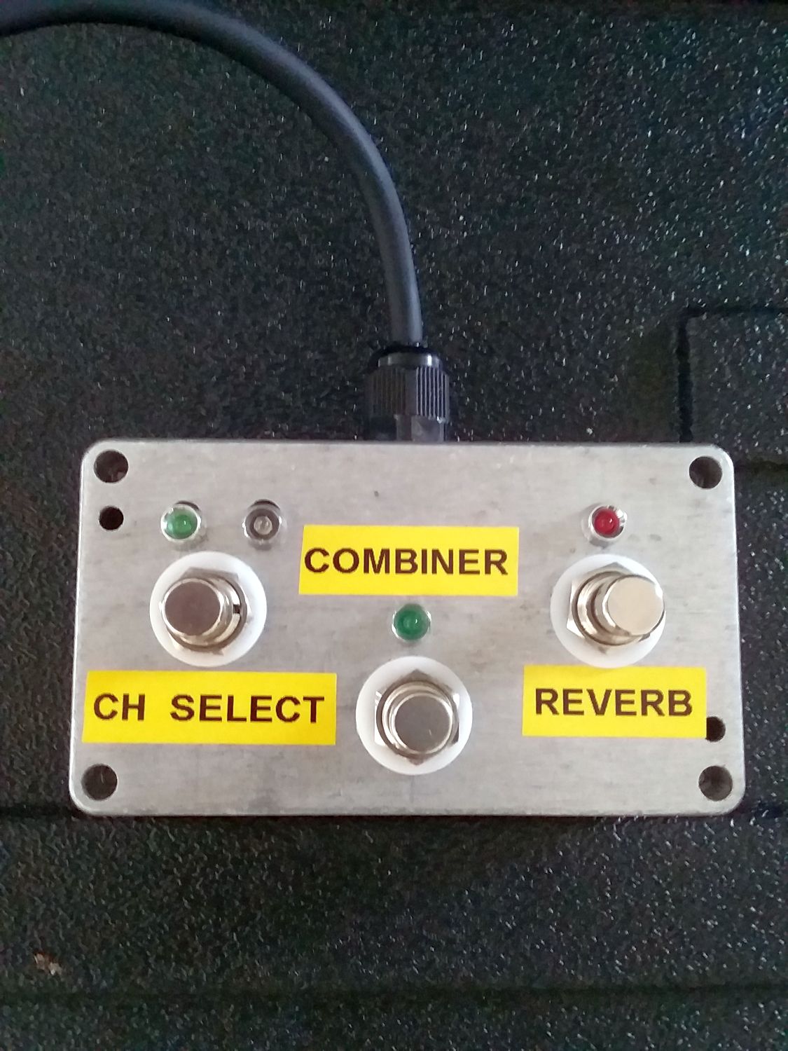

    I'm going to be doing some more servicing work on my Peavey Renown amp today, had to completely replace the cable for the footswitch since one of my cats decided to chew on it, why some cats have a penchant for chewing on cables I'll never know, anyway, I decided to make the cable 10m in length.
    Here's a couple of pics of the footswitch after replacing the original cable:
Name:	Renown Footswitch 1_resized.jpg
Name:	Renown Footswitch 2_resized.jpg
    Here's what the three footswitches do:
    Ch Select......Pretty self explanatory, it allows you to select either the Normal (Clean), or Lead (Saturation) channel, when the Normal channel is selected the Green Led lights, when the Lead channel is selected a Blue Led lights.
    Reverb.....Again, self explanatory, it switches the spring reverb on or off regardless of which channel is selected, when the Reverb is switched on a Red Led lights.
    Combiner.....When the Combiner footswitch is switched on, both the Normal and Lead channels are selected so you can get a blend of both channels, a Green Led lights when the Combiner is switched on.
    Next job to tackle is to make a new speaker lead with a right-angle 1/4 inch Tip/Sleeve plug on each end, the original speaker lead I made also got chewed by one of my cats.

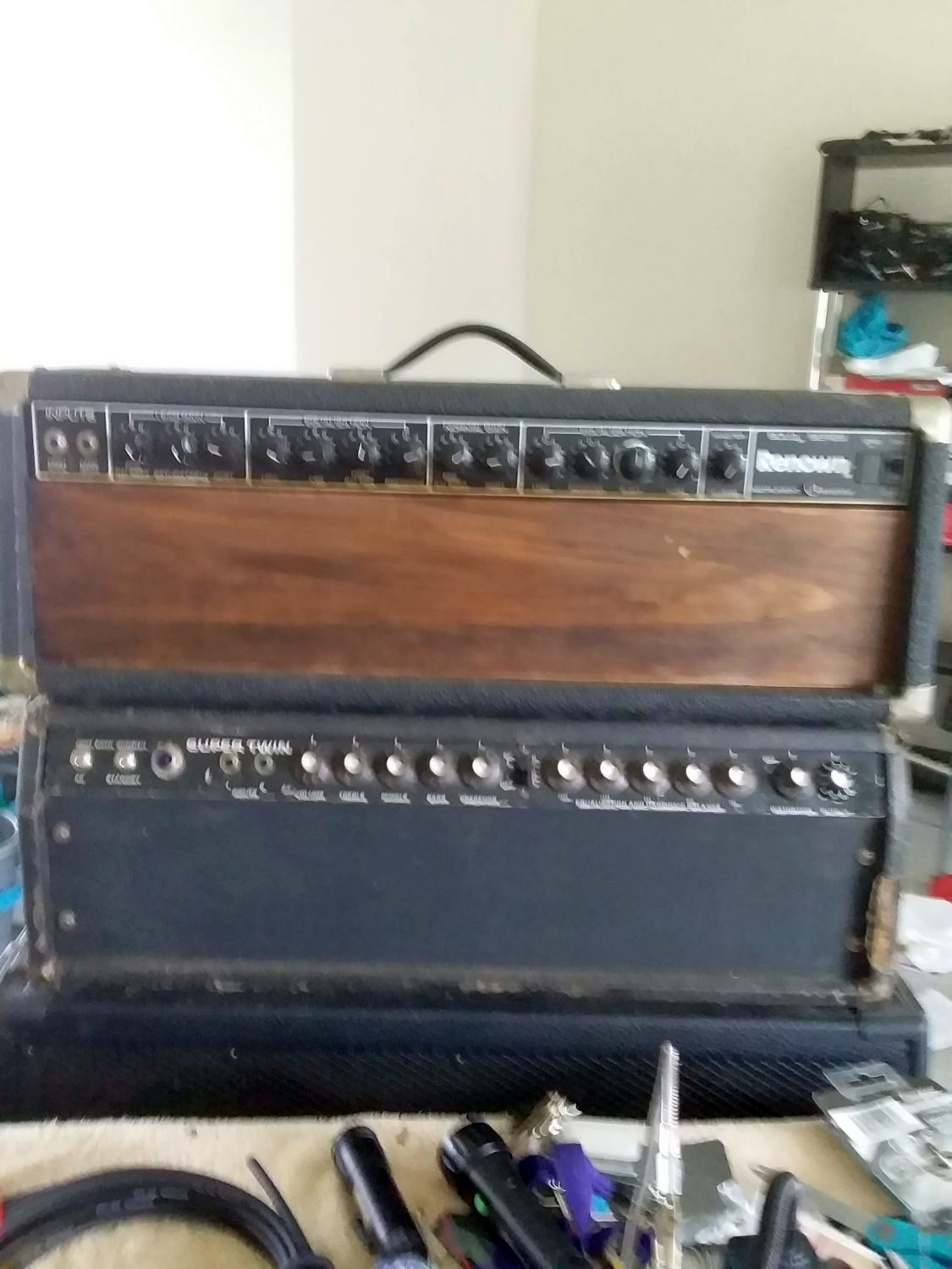

    Here's a pic of the Renown after I put it all back together after re-installing the wooden front panel, all it needs now is a silver Peavey logo to go on the front and then it'll be complete:

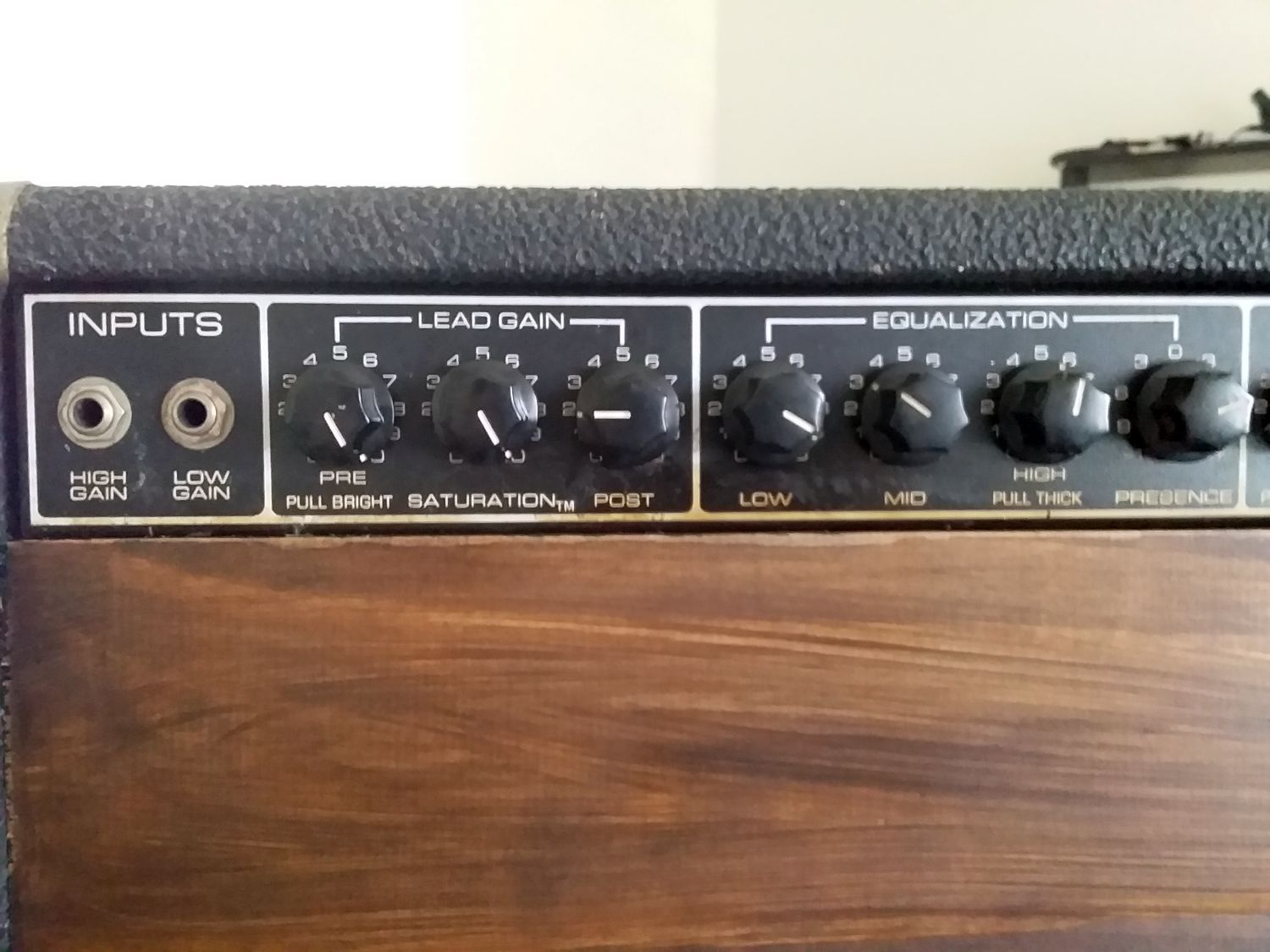

    Since the Lead channel of the Renown has a control labelled "Saturation", I find that the amp doesn't have to be cranked much at all, the three controls on the Lead channel are "Pre", "Saturation", and "Post", Pre is basically a pre-gain control, Saturation controls how saturated the distortion gets, and Post is basically the master-volume for the Lead channel, in addition to that, you have the choice of plugging into a low-gain input or a high-gain input, Pre also has a "Pull-Bright" switch on it as well.
    Here's a close up pic of the Lead channel controls:
Name:	Lead Channel_resized.jpg

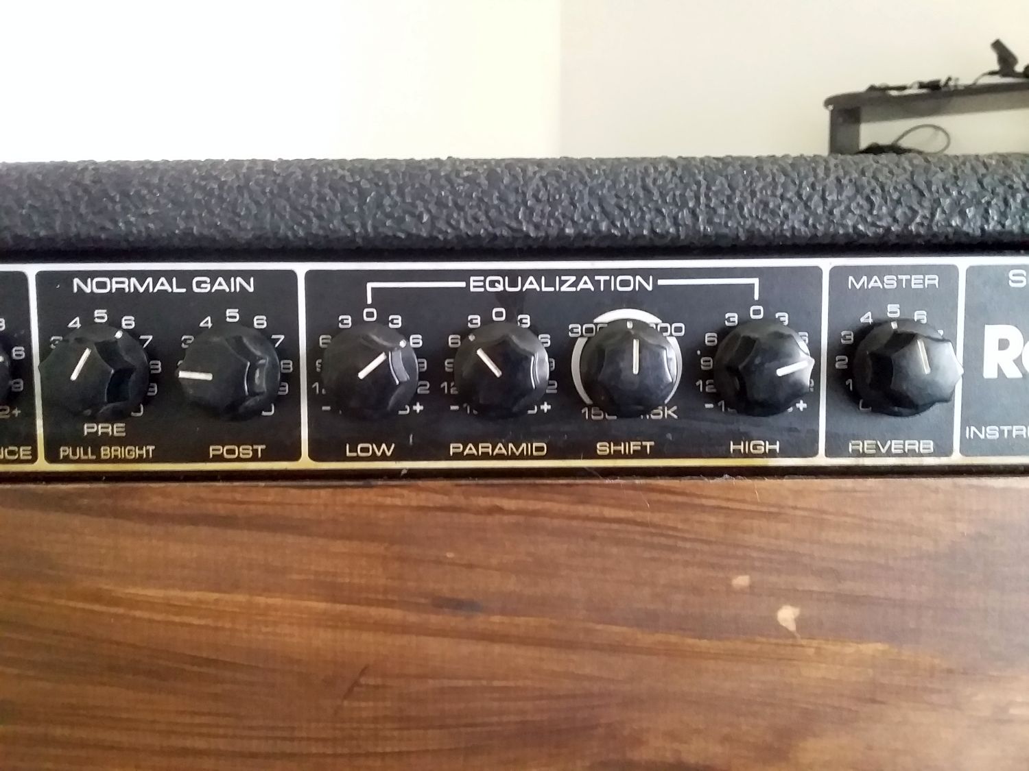

    And here's a close up pic of the Clean channel controls:
Name:	Clean Channel_resized.jpg
    On the Peavey Renown, the Clean channel is called the Normal channel, the built-in Spring Reverb effect works on both channels.
