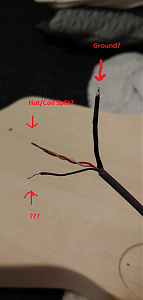

    I'm new to building and are trying to put together an ex-4 bass. But I can't put my head around the wiring of the pickups. I don't have a multimeter. Can some one please tell me what the different wires are?

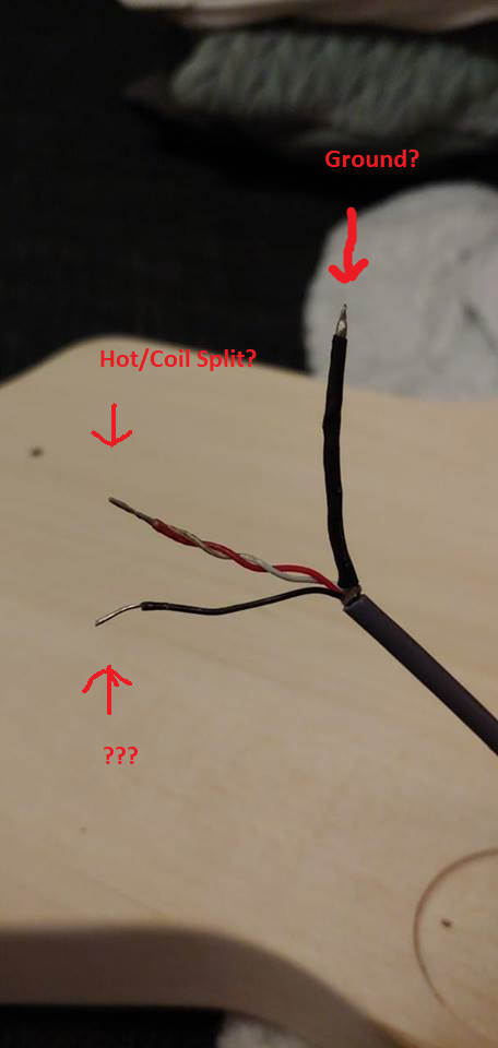

ID:	29631 From what I've read I think this is part of the wiring. I saw somewhere that I can connect the small black wire and the ground wire together. Is that correct?
    Single black is your ‘hot’.
    Red & White is the series link between the coils, just insulate/tape the tip so it can’t short if you’re not splitting.
    Bare & Green (fat, looks like it’s got heat shrink on it) is your ‘ground’.
    The wiring diagram was created when the supplied pickups just had 2 wires, but now the kits are shipping with 4-wire humbuckers. Just match the above to the diagram and you should be fine.
