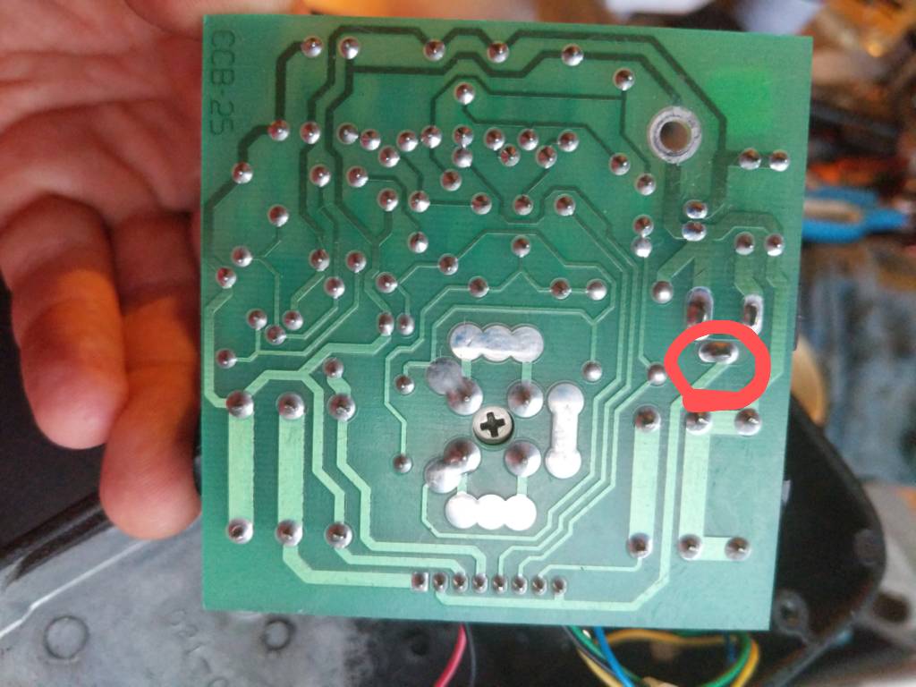

    So I was digging through one of my many boxes of cables and gear recently and came across this old wah pedal I'd completely forgotten about. It was given to me like this and apparently there is some problem with the power supply. I have done a little bit of googling and it is supposed to have a 9v connector attached to the board. I have one, as per the pic, but I'm not entirely sure where I should be soldering it on the PCB. There are a few different versions of the board and I can't find a clear pic of this one.
    So I guess I'm just after a bit of advice and direction. Is the above a reasonable place to start? Should I just buy another PCB? Who's a good local supplier?

    Don't know if this will help as mine is a different PCB, but where I have marked with a circle traces to where the positive of the battery goes. Looks like the third lug in from the edge on yours is the same connection ...Click image for larger version.

    Cheers guys, further googling reveals that the battery connection is on the two outside lugs on the board connector. Again I can't see my specific board with a battery, but this shows the connections here. This ones been modded for bypass as well....
    So I might try that. A replacement board is only $52 on that pedal parts site, so I can always go that way if I can't get this one working.

    OK, so I found a 9v power supply with the headphone style jack in amongst all my bits and pieces. I definitely have power, I can get sound through the pedal. Clicking the switch activates the pot and it makes some noise as I turn it by hand (like an old dusty pot would) but there is no 'wah' effect, although the guitar still makes sound through the pedal.
    I'm tossing up replacing the PCB. I am pretty sure I can score one of these pedals - working- for a little bit more at Cash Convertors, but then I don'y really learn anything.......
