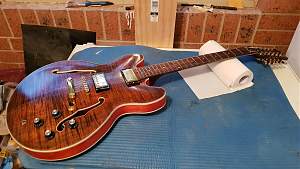

    First step.
    Take one perfectly good guitar

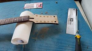

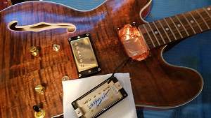

    Start to strip it down

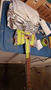

    Get out the ozito heat gun, and give the body some protection fro the heat

    Onto step 2.

    Nice one, looks like it came off pretty cleanly.
    Yes it did, just need to clean up the glue residue, and then see how it seat, make sure nothing funky has happened.

    There is some awesome skill work going on here.
    For posterity Rossc0:
    - The heat gun, was this a temperature adjustable model? Was sort of temp setting did you use?
    - Did you direct the heat flow straight at the joint or across the top of the board?
    - How long did you heat for?
    - Did you pull up or wiggle the neck joint at all to release?
    - Did you have to employ any other tools (Spatula, putty knife etc) to assist releasing the joint?
    Cheers mate, inquiring Igors wish to know!
    Thanks Frankie,
    - Yes, it was adjustable, but just a cheepie Ozito from bunnings, it comes with a variety of nozzles one of which is fairly small and focused, I had it set about the middle of the range. I could hold my hand about a foot in front of it without too much trouble.
    -I concentrated the heat on the tongue to start with, when I could wiggle the neck and see some movement there I then tried to direct it back up the joints on either side of the neck,
    -It probably took me 20 mins, suppose depends on how much glue you have used initially
    -There was lots of wiggling, at one point I applied a bit of pressure with a clamp, guitar upside down and clamp on heal of neck pulling down to a foxed point.
    - No other tools
    There is a bit of splintering inside the body, a few small pieces have come out attached to the neck joint, but not a lot, and nothing that will cause any structural issues.

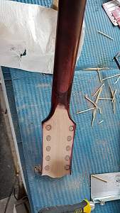

    Dowels in and glued

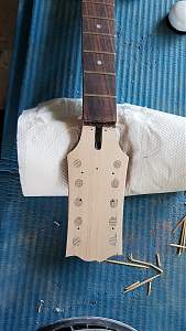

    Headstock shape roughed out

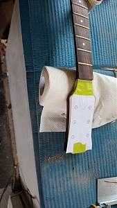

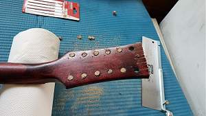

    the power of tooth picks, original screw wholes filled and sanded back with 60 grit to start and even out the dowels

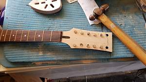

    Pilot holes for the new tuners, will drill out once I have them to ensure I get the right size, probably be something like
    https://www.realparts.com.au/tuning-...ckel-4308.html
    Will hand finish the headstock shape to get the open book as best I can, then sand up to 320 probably.
    Interesting fact: Finished this build originally in June. Sanding the black of the headstock, it still wasn't fully cured underneath. gummed up everything. Obvioulsy my painting technique leaves a lot to be desired.
