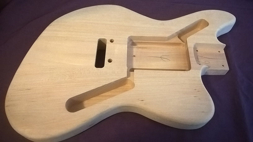

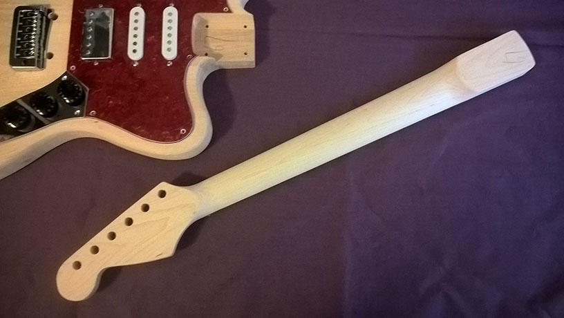

    Finally got my hands on my first kit guitar (bit of a wild goose chase with Aust Post that nearly ended my guitar building ambitions prematurely). Here are some out of the box shots:

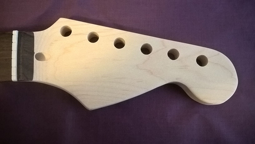

    I have to admit, the pre-shaped headstock was a strong selling point.

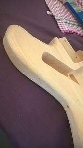

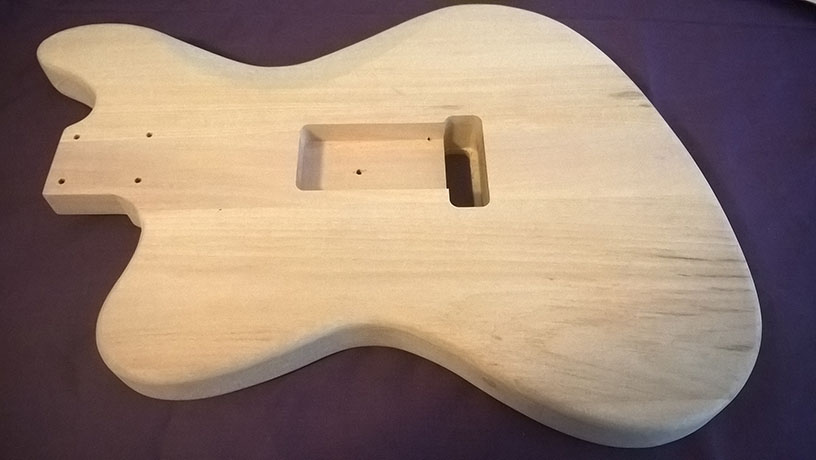

    I'm quite impressed overall. There are some dark scrape looking marks on the body - I'm assuming these will come out with sanding, or are these a feature?

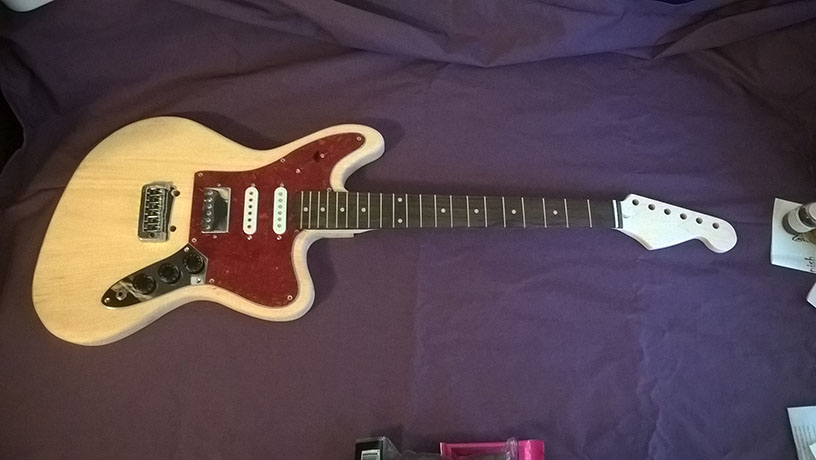

    Mock Build
    This was the start of my mock build. I did fit the tuners (Grover upgrade) and strings but I guess I forgot to take a photo. The locking machine heads made it super easy to string up (and take apart). I think these will be a standard purchase for future kits.
    I positioned the neck and bridge, measured nut to 12th fret and 12th fret to the bridge saddle of the high e - everything seemed to line up.
    As this is my first build I was planning to keep things as simple as possible: just stock, sand and stain. However, the day I got my kit I found Zeromick's JM-1 mashup build diary and was both impressed and inspired. Zeromick's build is pretty much what I wish I could do. I like the look of the JM-1 but I'm not a fan of tremolo bridges and I don't much care for the pickup configuration in the pearloid red pickguard.

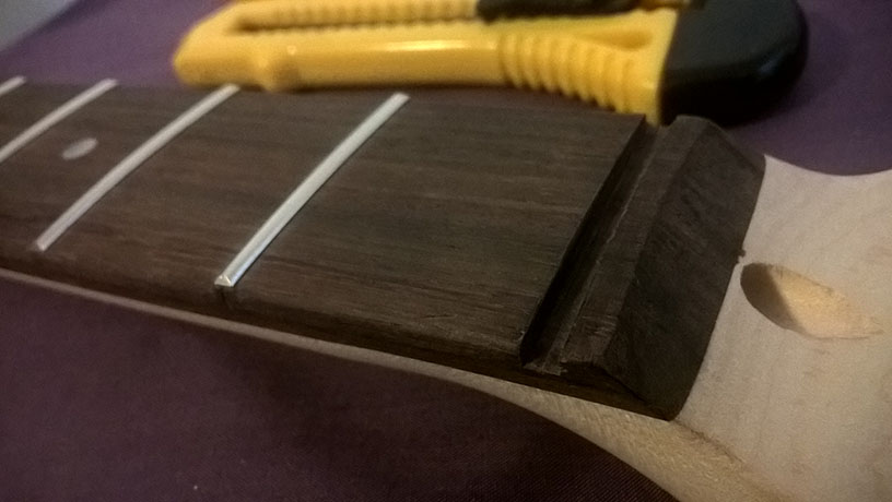

    Whittled away the fretboard corners with a Stanley Knife (crude but effective) and pulled the plastic nut.

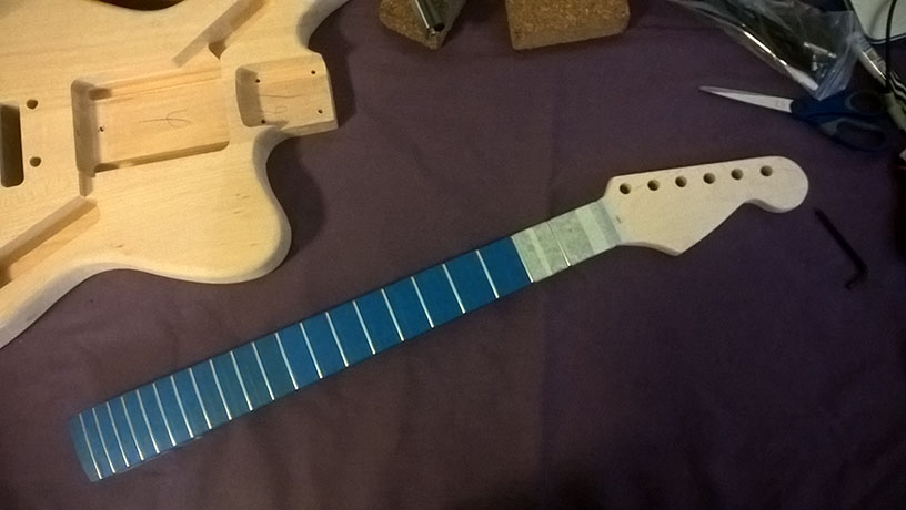

    Taped up the neck in preparation for some fret levelling.
    I didn't take any photos during the levelling process, but I basically just followed the guide on the forum. I went and splurged on some tools, as I'd really like to be able to set up a guitar properly - notched straight edge, fret rocker, fret levelling beam and a triangular crowning file from Stewmac.

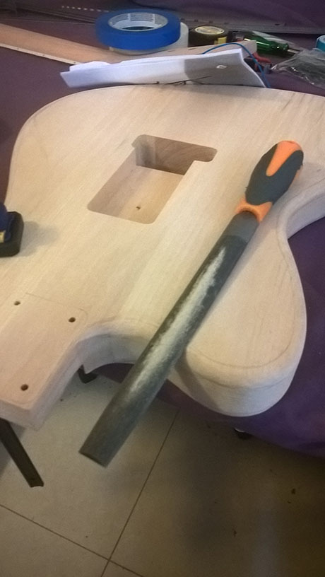

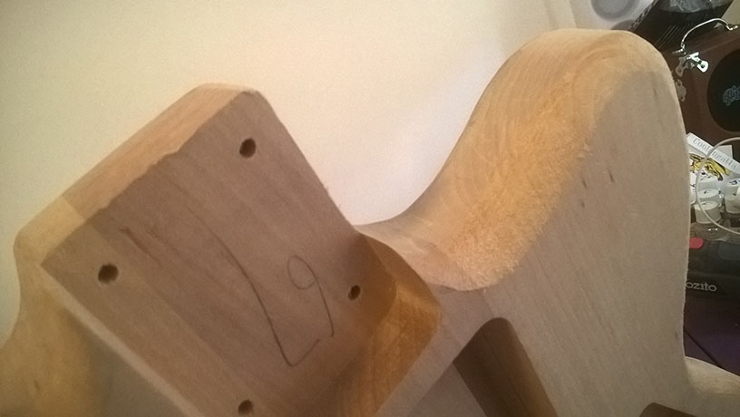

    This is my file, this is my gun

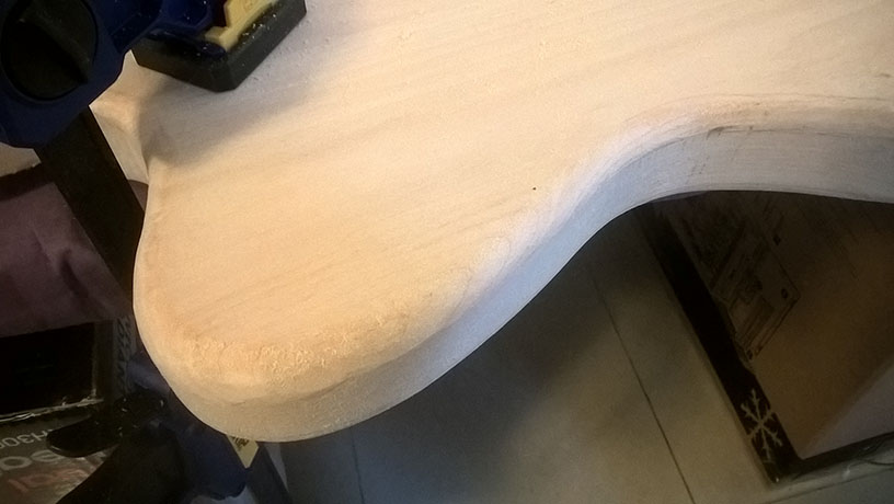

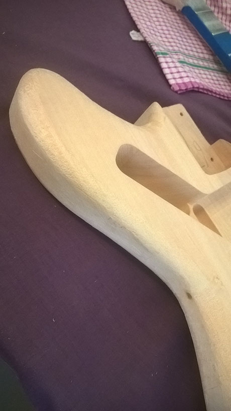

    Started rounding the edges on the back with a bastard file. I just like saying bastard file.

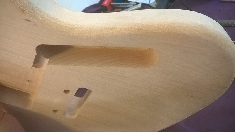

    This could so end in tears.

    I've taken a couple of cheap option for fret work, a Stanley knife blade has a decent straight edge for a fret rocker and an aluminium spirit level has a nice machined surface for a levelling bar, both cheap and readily available at your local hardware store my local also had a nice little kit of assorted very fine files and 0000 steel wool
    A Stanley knife blade as a fret rocker, that's an awesome idea Dave. Thanks for the tips.

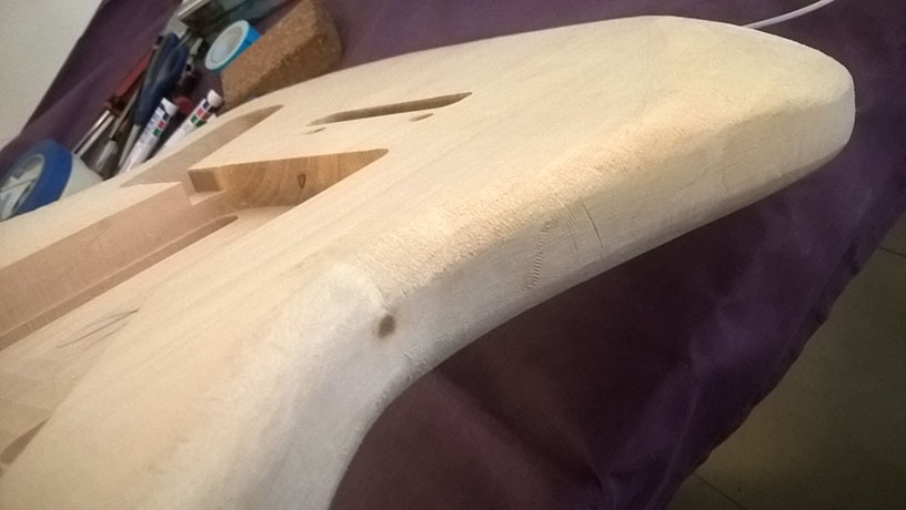

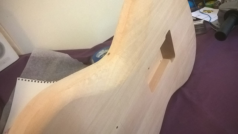

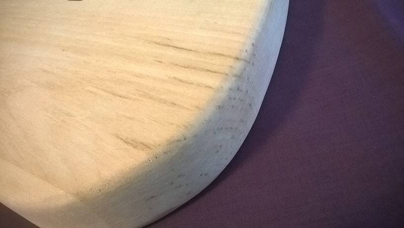

    Shaping
    Filing was good fun. I got carried away in parts and went past my pencil guidelines, but it's quite a comfortable shape now.
