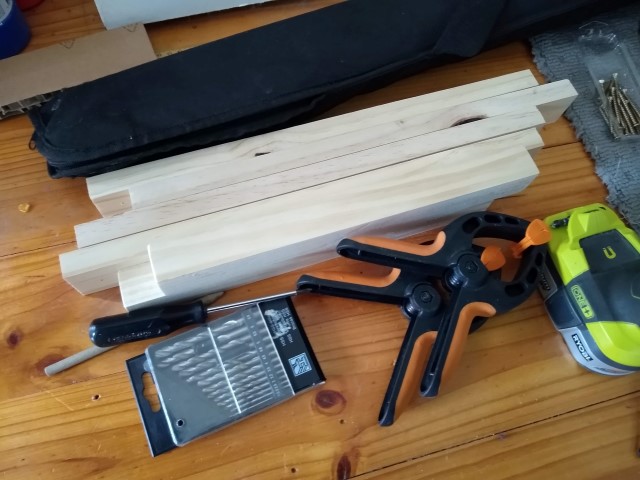

    Timber cut to length:

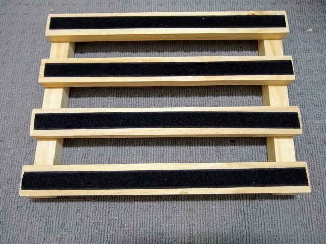

    Screwed together and velcro loop tape applied (I put the hooks on pedals):

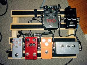

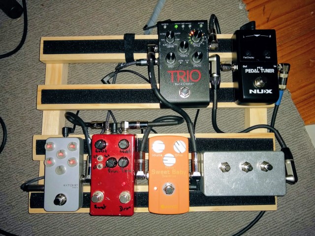

    Current layout. Some cabling not as neat as I would like, but the patch cord from Trio to Sweet Baby is a tad too short:
    The ugly red pedal is a BYOC OD-2 which doesn't appear to be available anymore. It's best described as a heavily modded tube screamer with a separately switchable clean boost. I built it around 5 years ago and it's still my favourite pedal. Of course, I didn't know a thing about using spray can lacquer then. Just sprayed one super thick coat that stayed soft for ages.

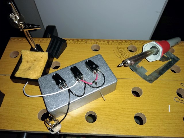

    Project 2 for the pedal board was a DIY version of a Digitech FS3X to control the Trio. It's just an enclosure, three SPST momentary contact footswitches, 2 diodes and a stereo jack. Much cheaper to build than spending >$50 on the original. Didn't even bother to paint this one.
