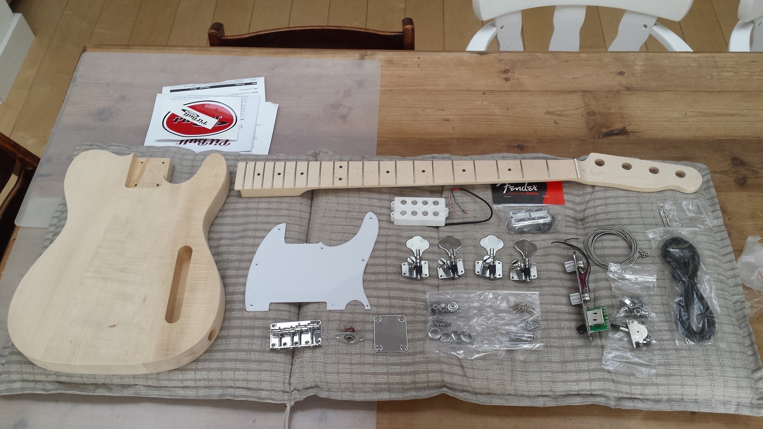

    I've been dreaming about this for many years, now with another baby on the way and limited time to play bass in the evening, I decided to buy a kit for the perfect stay-at-home nights.
    I wanted a telecaster bass, rare on it's own, but Pitbull had one.
    Although this is my first build, and this kit is recommended for advanced builders, with degrees in Electrical Engineering and Microfabrication (MEMS manufacturing) in my pocket I'll just go for it. No gut's no glory and with dedication, patience, persistence and your help, success will be unavoidable
    Design: Sonic blue nitro finish, matching headstock, oiled neck.
    Original Fender Cabronita humbucker at the edge of the pickguard, a 4-conductor MM humbucker closer to the bridge and most likely a 51' single coil close to the neck in the standard tele (guitar) position. Exact electrical wiring connections tbd, will prototype and select the best sounds/combinations to hook up to the new 5-way switch. Will add a stacked 2-band active @ tone position. I might replace the pickguard by a custom one, we'll see (3-ply white pearloid material ordered and got access to a professional laser cutter). Custom Decal (Dutch know who lived @ Drakensteyn), old school j-bass bridge cover and straplocks to finish it off.
    Got the kit and most parts, still waiting for the '51 SC pickup, vintage style round jack plate, battery compartment, but got all sanding paper, nitro finish (base, color, transparent) from a local dutch supplier.
    1st job: the mock-up build....

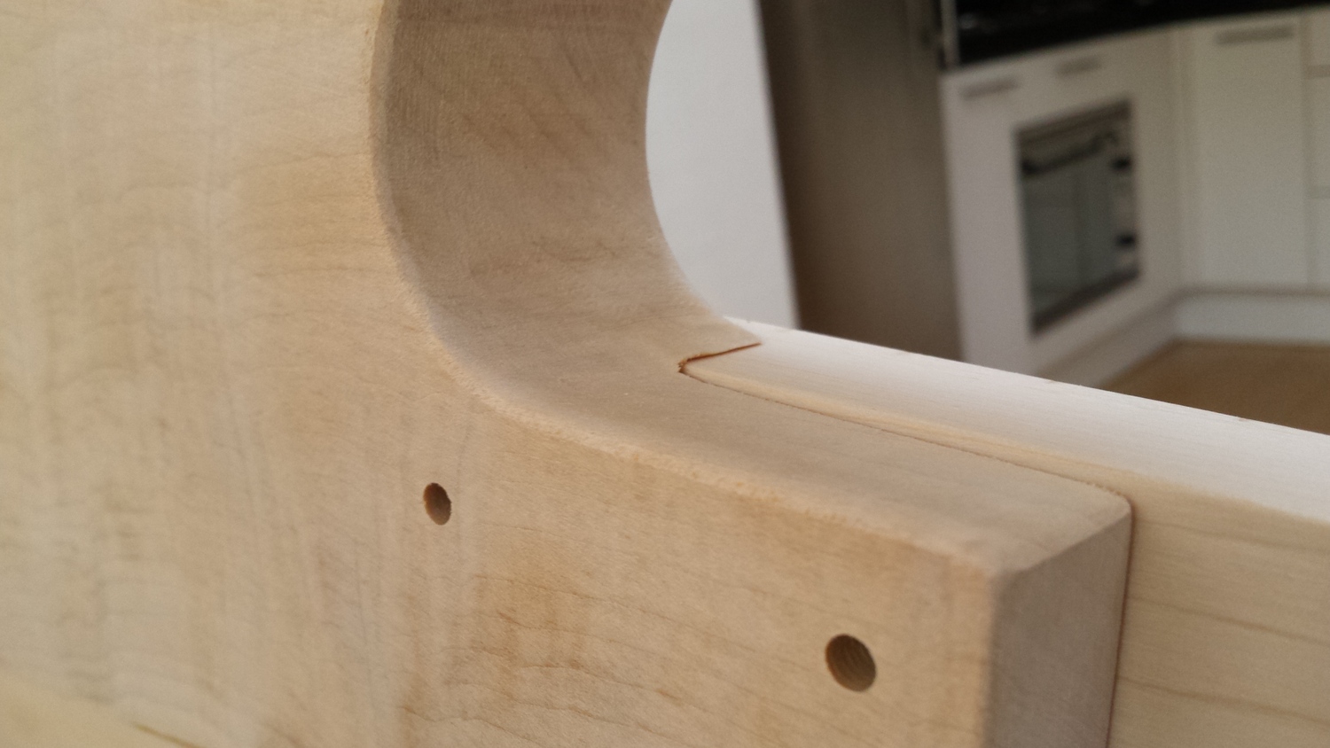

    Straight out of the box, the neck just fitted (not) in the pocket: fraction too wide and can't get it all the way in:
    wood at the lower corner pocket seriously stretched after some force. Also the the corner radius of the neck and pocket don't match.

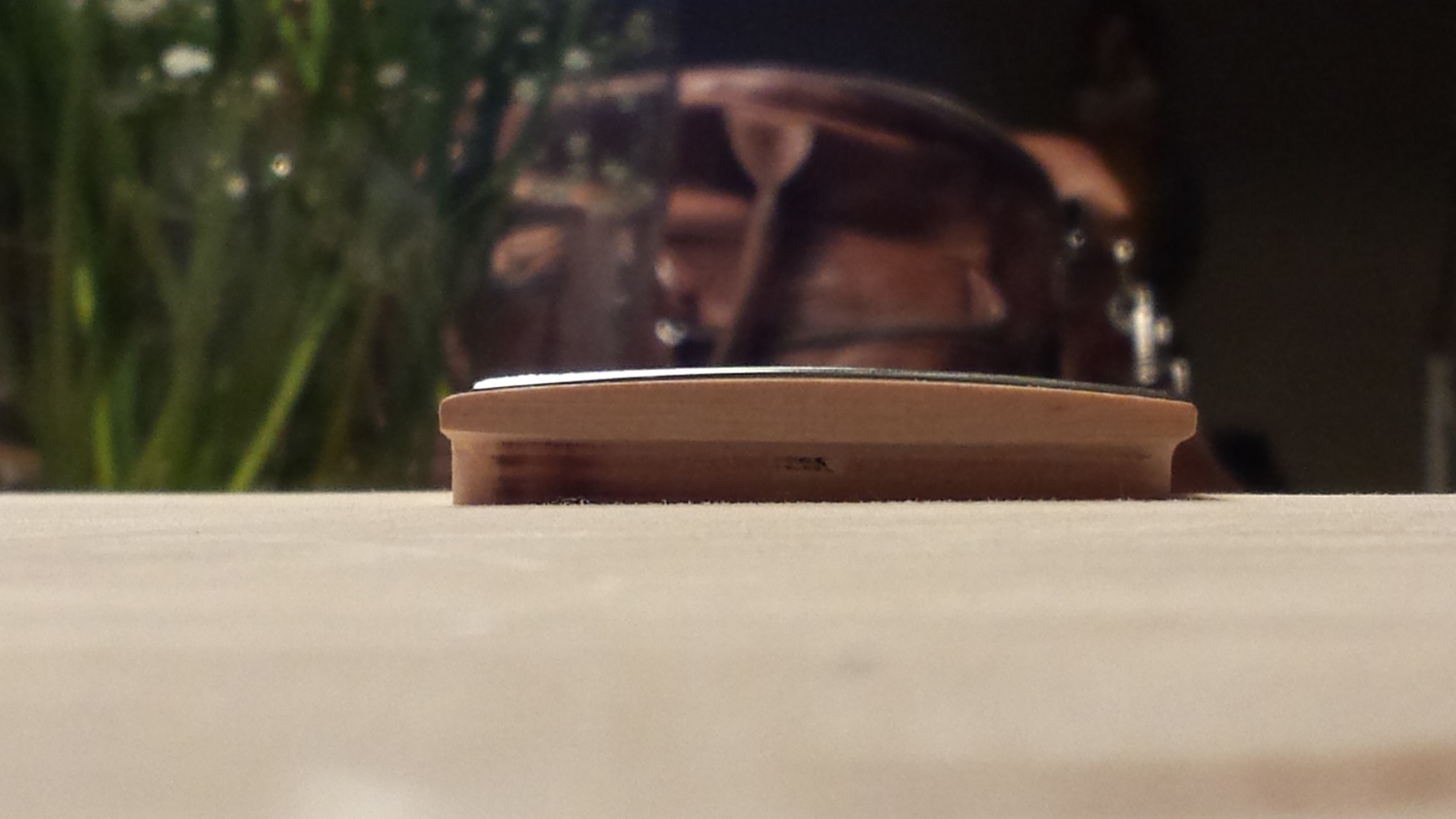

    As this body has no holes for the bridge yet (I checked the 4 point neck alignment tutorial), I decided to sand down the neck at the lower end a little for a comfortable fit and aligned along the long pocket edge. Tried to get is as far in as possible, now at a gap of ~0.5mm.

    Should I continue to get a 100% fit or is a little gap at neck edge OK tonewise? I mean, 90%+ of the contact area is at the bottom anyway and I don't want to risk sanding it too much making it loose...

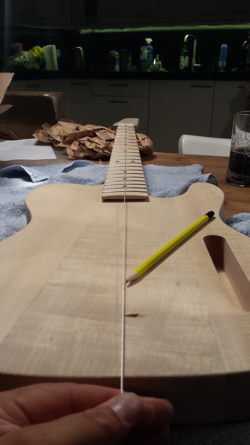

    For alignment, I measured the body width at the widest part, put a little pencil marker half way. A thin wire in the dead center of the neck across all dots nicely lines up with the mark with the neck fully in and pushed towards the long/top side of the pocket. So, time to start drilling the holes in the neck and use this midpoint as the center for the bridge and pickups.

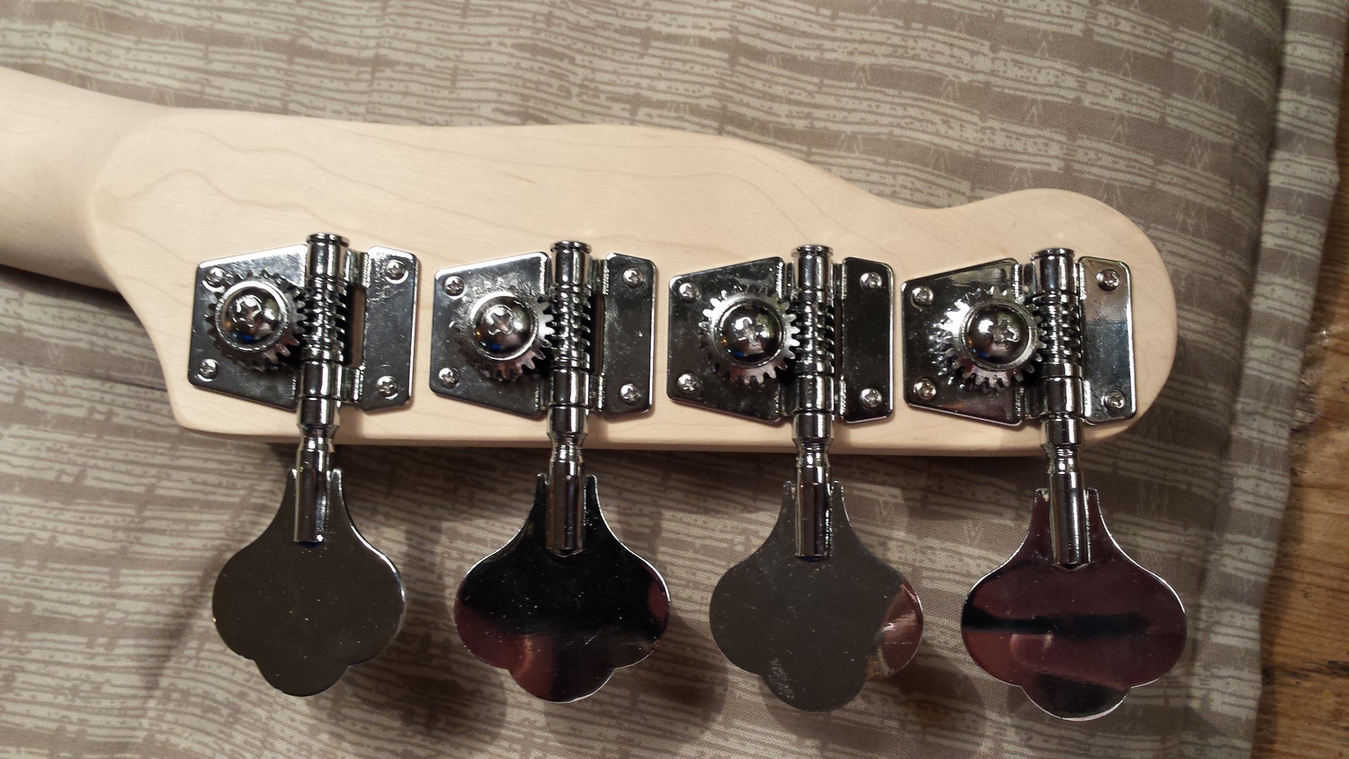

    Tonight got the tuners on, aligned them 1 by one, predrilled 1.0mm and later up to 1.5mm.
    Fit will although lining them up was a little tricky as the bushings are about 1mm wide so centering needs to be done by gut feel. Worked out good enough and no screws broke off..

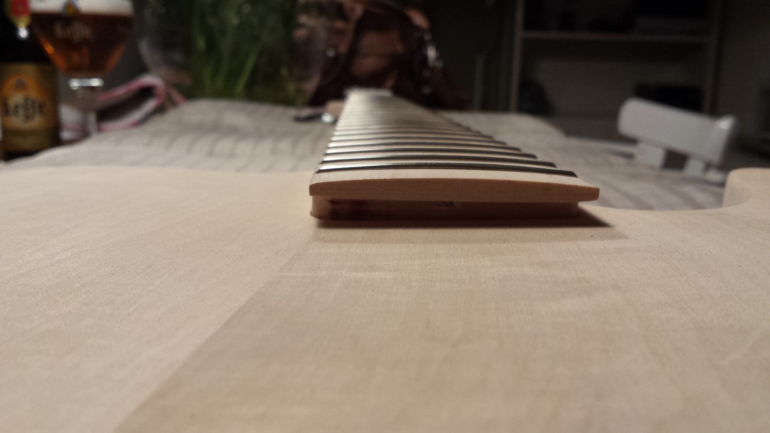

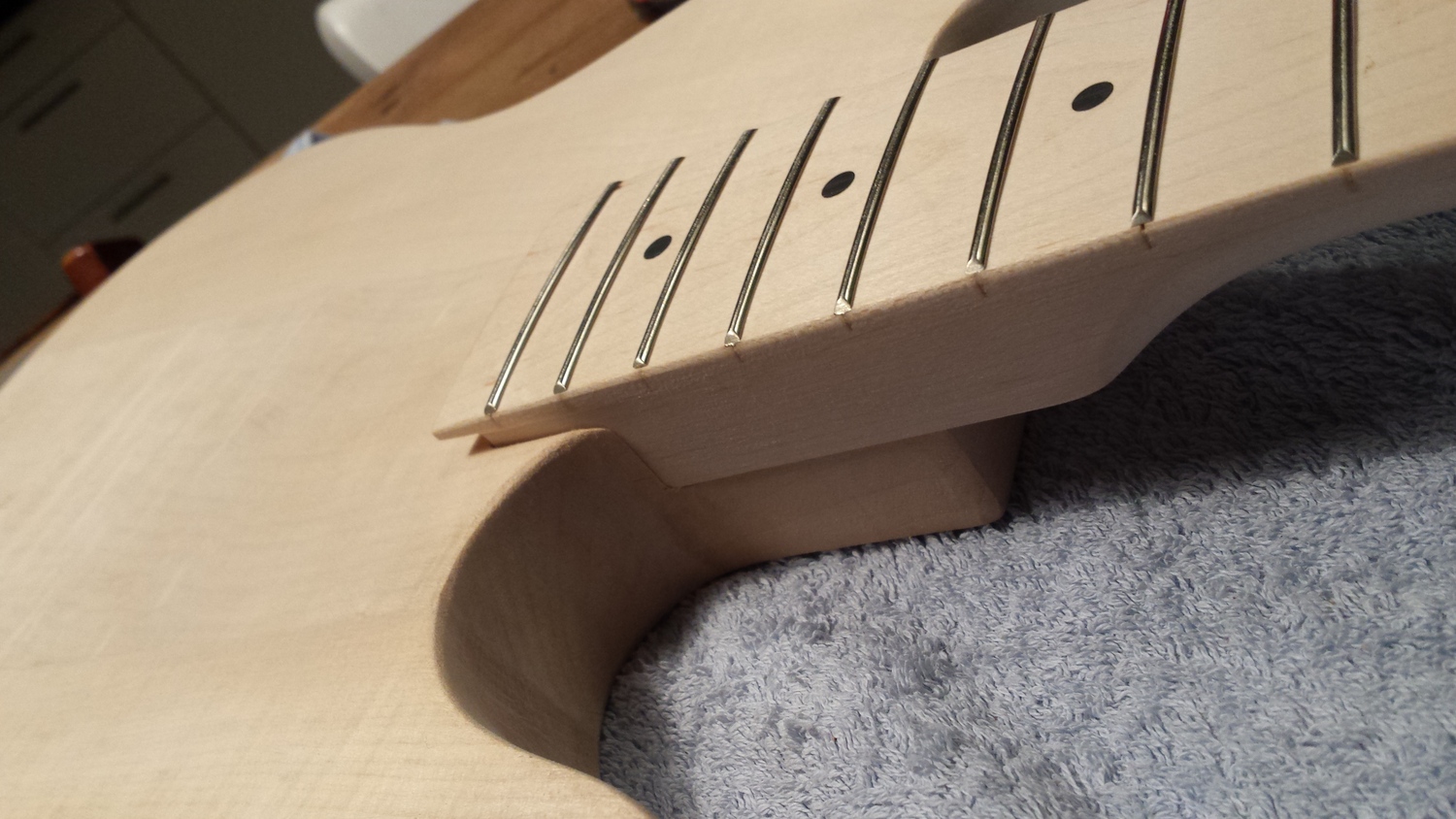

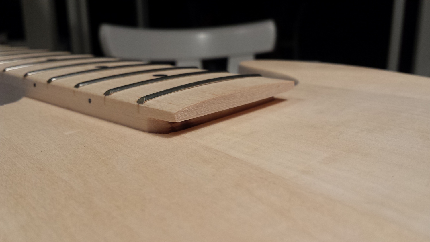

    Closer look from the front show a slight angle on the neck across the body. It's in the neck pocket, saw it earlier.
    I know I sanded the fret board a little at the edges but it's still there...
    I think I need to sand down the pocket towards the side a little to level it. Or I can leave it as is and compensate for it by adjusting the saddles and pickups, but sounds like a compromise to early.

    Any thoughts on this?
