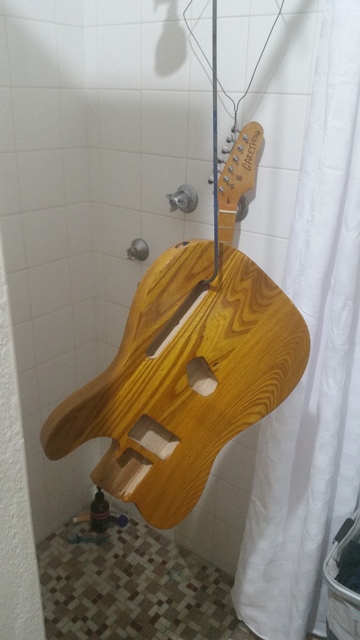

Name:	drying body & neck.jpg
    I learnt not to hang the body like this.

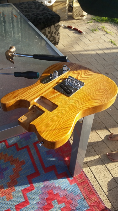

Name:	body assembly.jpg

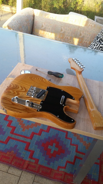

    I had helpers too:
Name:	guitar body with helpers.jpg
Name:	body with bridge.jpg

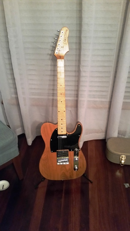

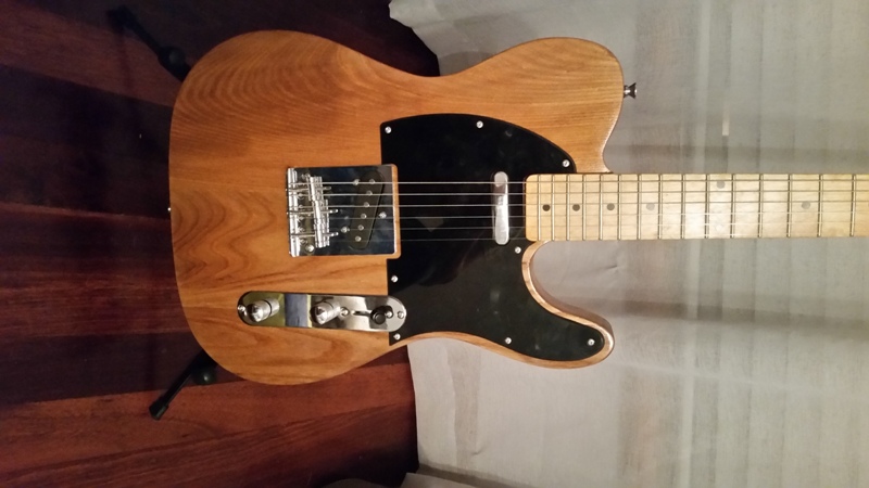

    So I still haven't finished the guitar, but about a week ago I got impatient and wanted to put it all together to have a look, before taking it apart again and continuing with the body and neck:
Name:	whole body strung up.jpg
Name:	Body strung up.jpg
