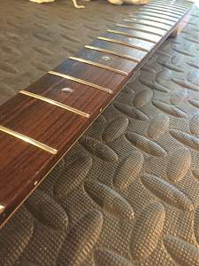

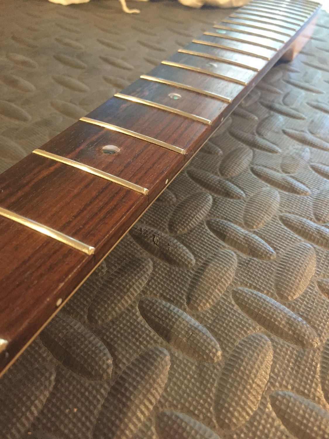

    I usually dingowax my fret boards. I have waxed both maple and rosewood.
    My method is to get a heavy duty cloth, dig out a little bit of wax, kneed it with my fingers until it heats up a bit and becomes supple. I then put an eraser in the cloth (saves your fingers) and push a bit of the wax into the cloth on the outside then apply it to the wood and spread it out as best as possible. after about 5 - 10 mins, I use a bit of the clean cloth and take off the excess wax so its a bit more even. when im all done I put my polishing drill bit on my drill and give it a polish....comes up shiny
