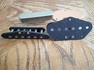

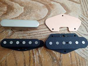

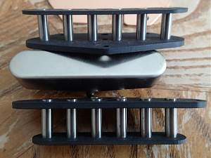

    Vintage 50's style Telecaster:
    Alnico 3 Neck and Bridge
    Neck wire will be 43 AWG the Bridge 42AWG the neck will be wound RWRP
    Polepiece diameter .187"
    Polepiece height Bridge: no stagger all poles .630"
    Polepiece height Neck: no stagger all poles .671
    All constructed, just have to wind them to vintage spec, magnetize them and wax pot them when i do DB's.

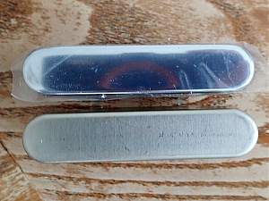

    Your choice Neck pickup cover
    Dull Pure Nickel or Shiny Chrome Nickel

    sounds good Tony, so these pups will be suitable for a baritone neck tele ?
    Yes thats why they have vintage pole pieces and the poles arnt staggered.
    Alnico 3 will warm the guitar up a little, less pull on those bigger strings.
    You wont saturate the tone and will provide a more natural articulate sustaining tone.
    A3 is very transparent, crisp treble scooped mids and a very clear bass tone.
    I can also wind them a bit hotter to take more treble out..
    I run very hot pickups in my Baritone, and once you get to pumping they get a bit blurred as bottom end does, they were also $300 a pair Harmonic Design Z90's, but a very very nice pickup tone wise.
