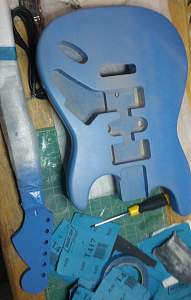

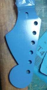

    so after much re-sanding and re-priming the first blue coats.
ID:	6219 Click image for larger version.
    good stuff Crusader, looking good. Once the coat has fully cured stick at more wet sanding and more coats

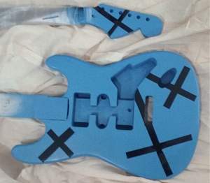

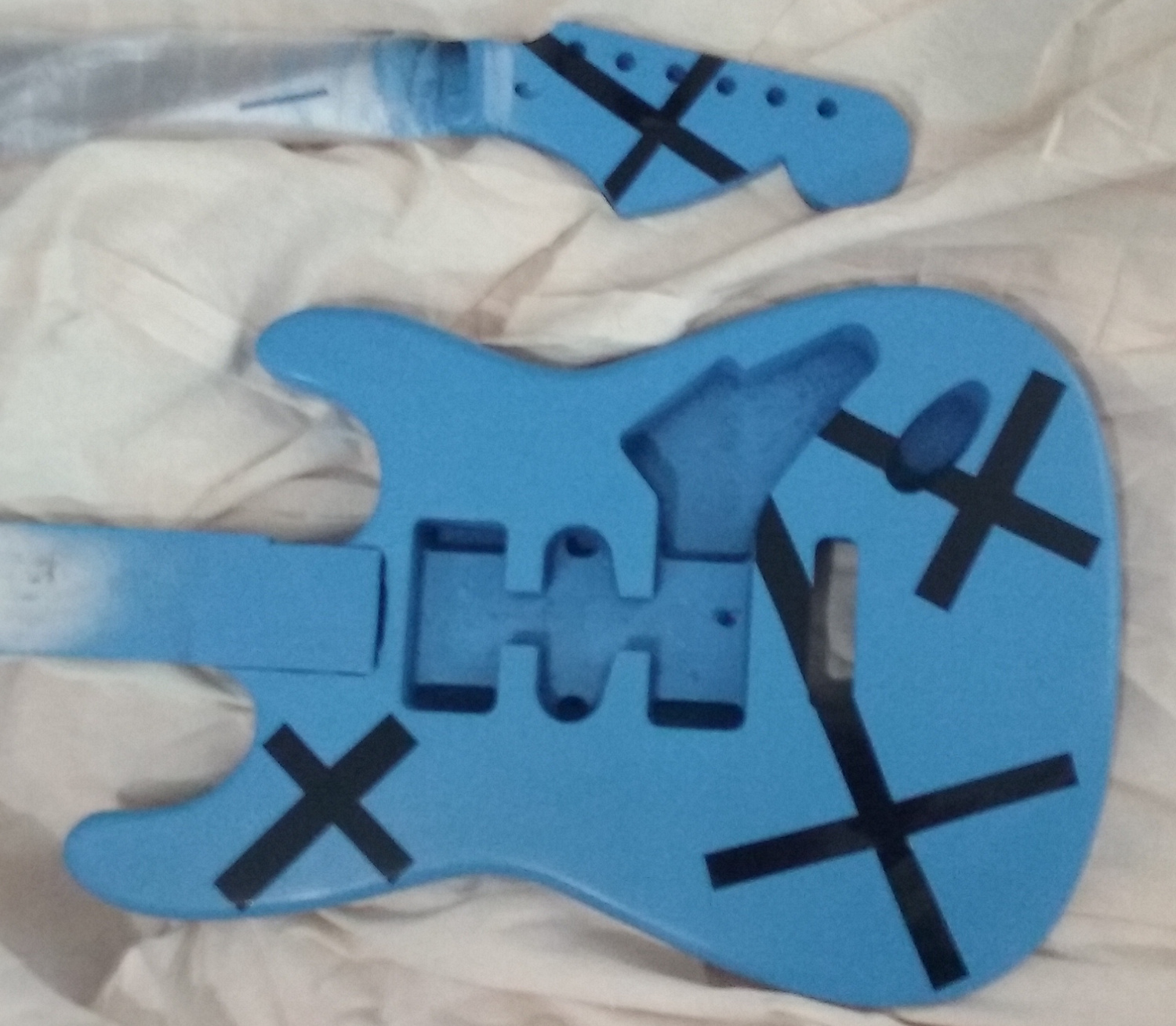

    So after much more sanding, some time and a lot of tape.
    here is a poor picture of the body and headstock complete with the "punk" black crosses on them.
    it's what the daughter wanted. I still have to clear coat and polish yet.
