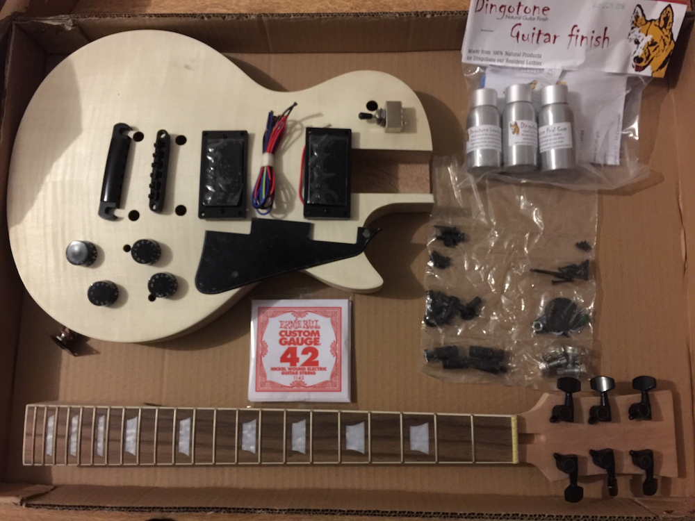

    Just got the box and it all seems to be there. Pretty excited to attempt this. I know virtually nothing about woodwork, electricity, soldering or building guitars. I just like playin 'em and lookin' at 'em.

    welcome to the forum Mongrel, nice looking kit you scored, looks like a LP-1M mahogany body and neck. What colour Dingotone kit did you order ?
    Looks like some nice flame maple on the veneer. Best early tip I can give you is don't sand the veneer much they are very thin. If you want to pop the flames with a black stain then I'd advise no pre-sanding before you apply the black stain then sand it back with 320 grit paper.
    Ask any questions you have and good luck with the build. Most important stage of the build is setting (gluing) the neck so ask lots of questions.

    Thanks for the tips wokkaboy. I found out the veneer was pretty thin, BEFORE I read your post. No major damage just a bit see through on an edge or two. I will definitely ask plenty of questions before i stick that neck on.
