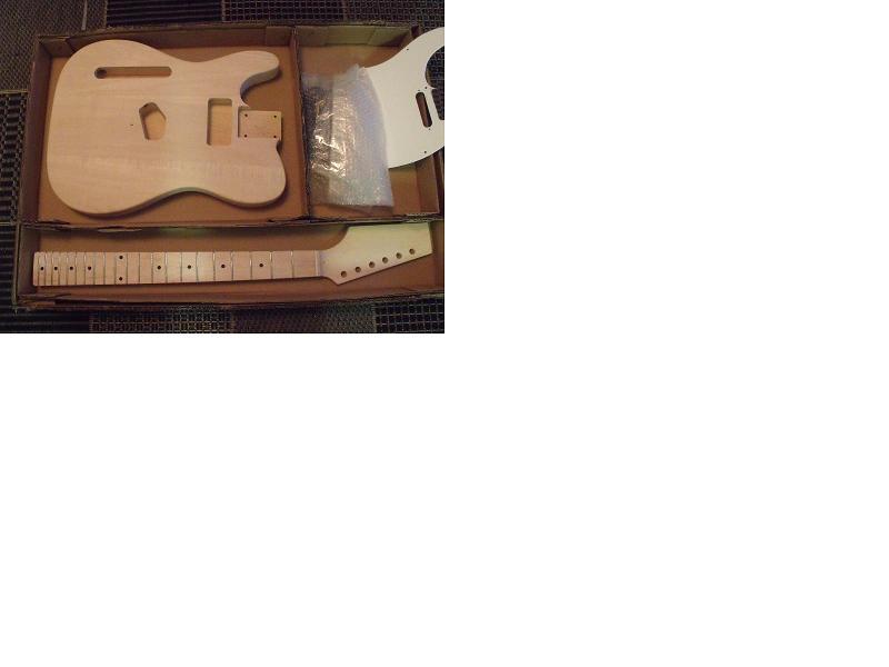

    This is the kit as it arrived in the mail... really quick postage from WA too :-)
    I spent 3 hours sanding the body today and it's now as smooth as a babys bum.
    I first used a fairly coarse paper, then a medium followed by a fine. I finished off with a real good work over with P1000 carborundum polishing paper (wet and dry).
    I'll shape the head and give the neck the same treatment as the body tomorrow.
    kit looks great Rob, so your daughter is a lefty hey.
    I wouldn't sand the body any more than about 400 grit as higher grits polish the timber surface and it won't take the stain as well.
    Same with the headstock face. Go nuts on the neck though can go to 1200 grit. Think you said natural colour neck.
