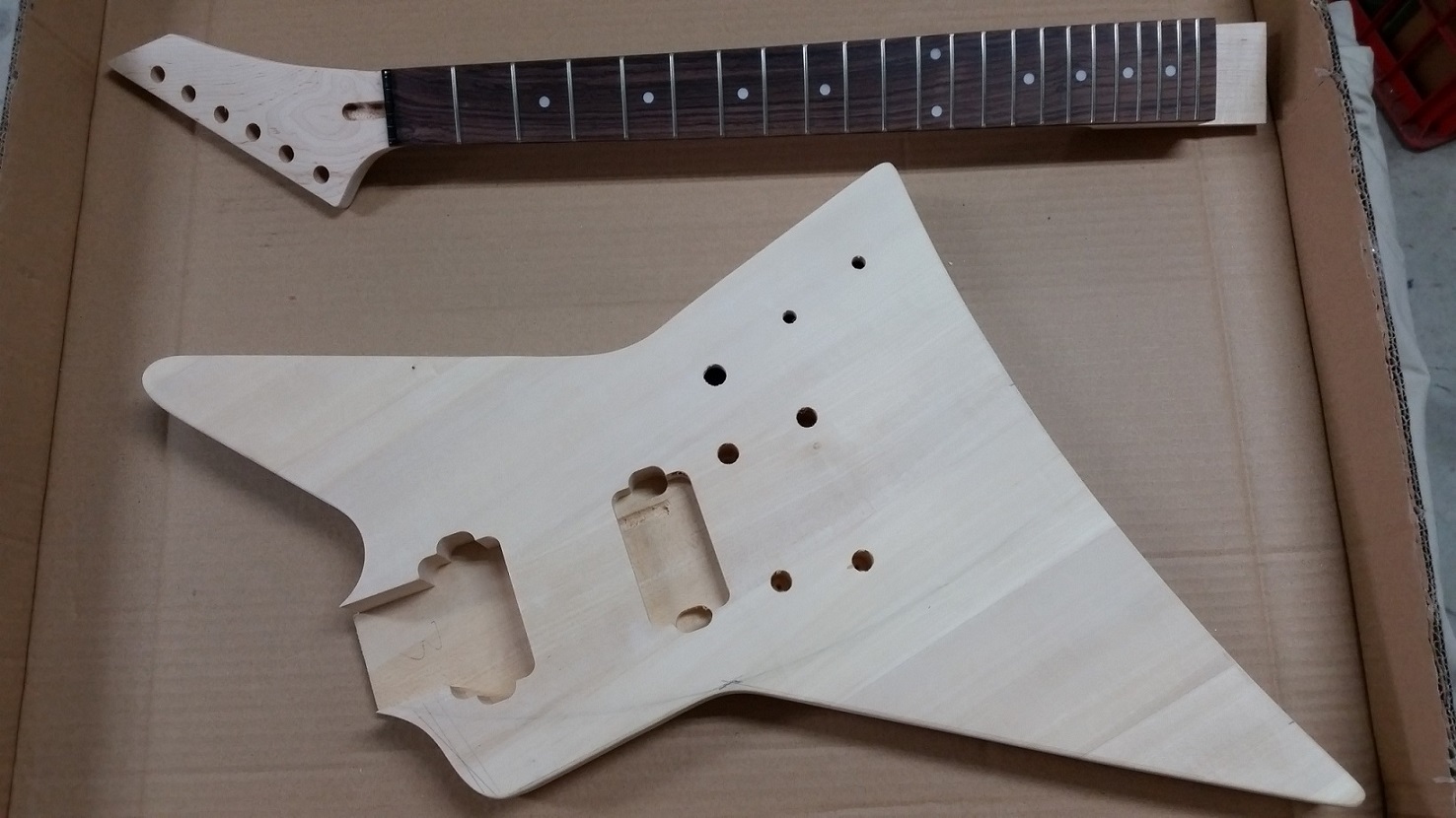

    You may guess from the bad 'tallica pun where this is going. Picked up a Esp-1 kit earlier in the year an decided to try to turn it into a snakebyte clone.

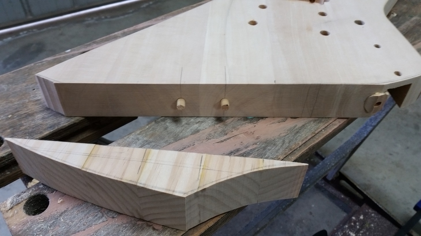

    With the cutting and adding on needed this was always going to end up being painted in a solid colour and the grain in the body was fairly plain, so no great loss in that area. Cut bits off, add bits on

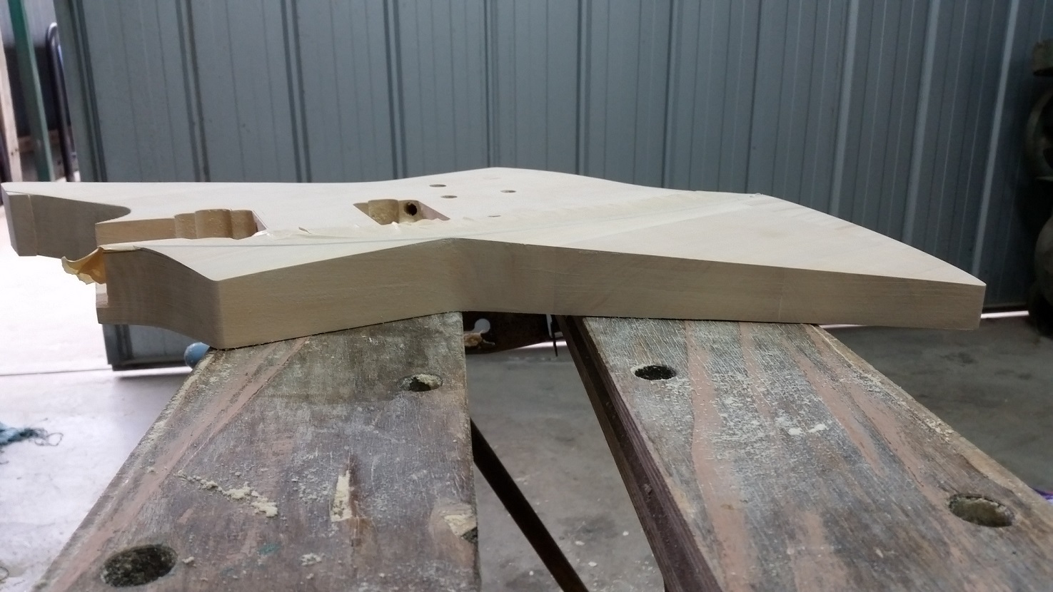

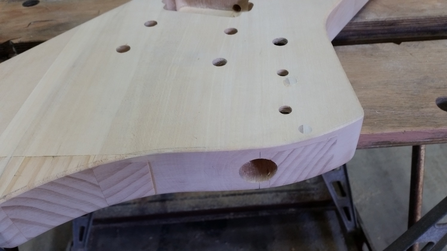

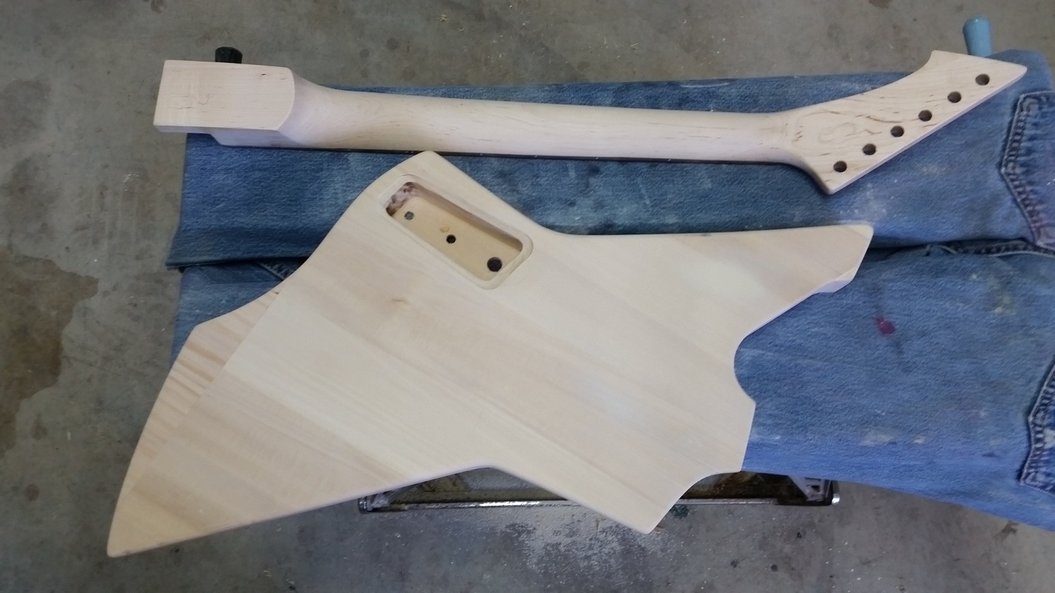

    Filled in the now open end of the control cavity. Being my first attempt at this much modification I left the switch location as a point of reference, also made it easier to plan the new control cavity.

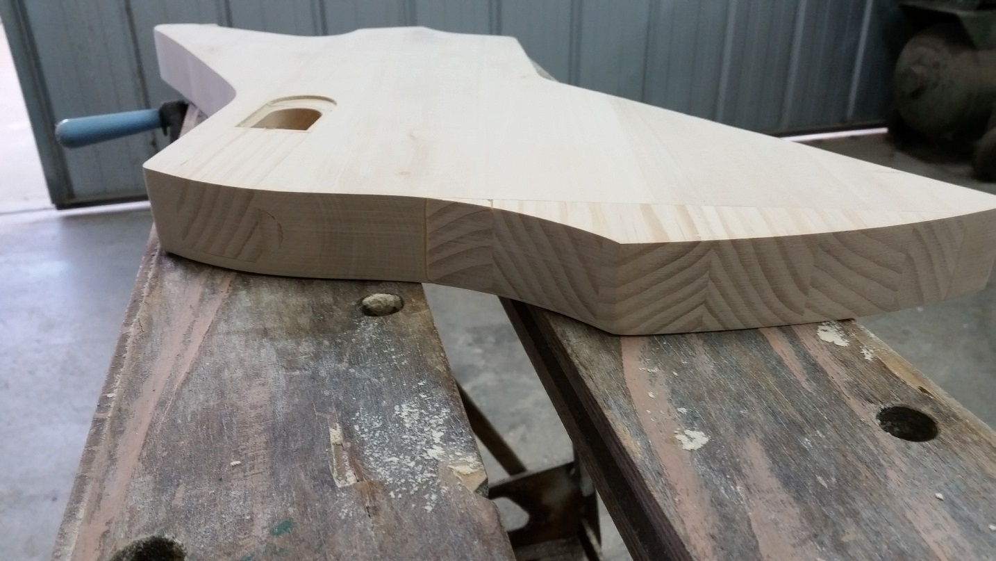

    Shaped the arm cut and upper horn on the body

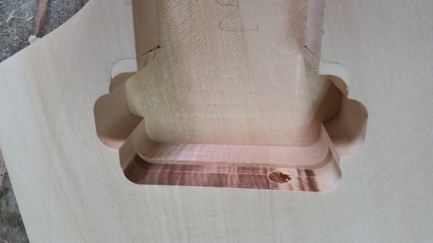

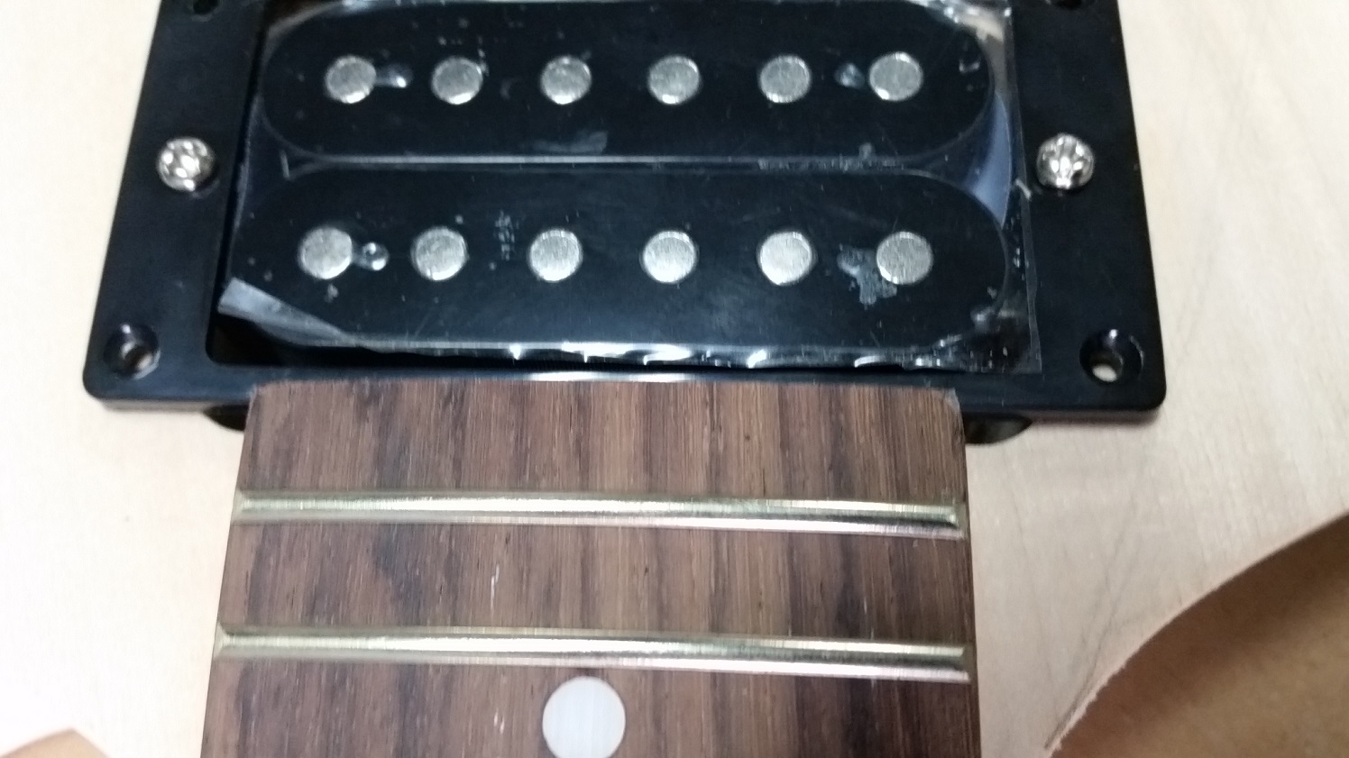

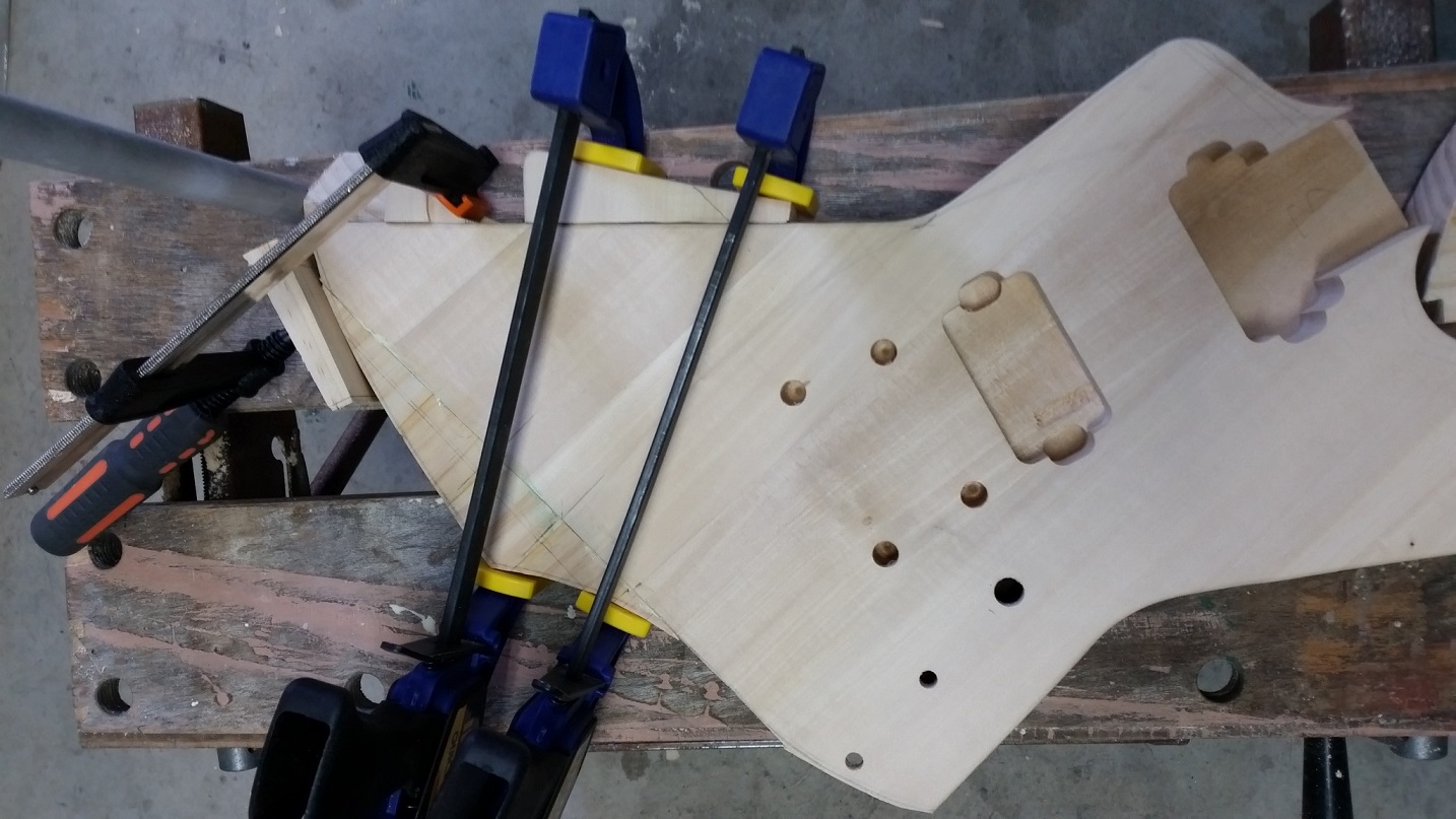

    With the neck in the right position, the pup cavity ended up too far forward
    Filled in with pine (same as piece on end of body) and moved the cavity back about 1.5-2mm just to make sure the pup will fit.

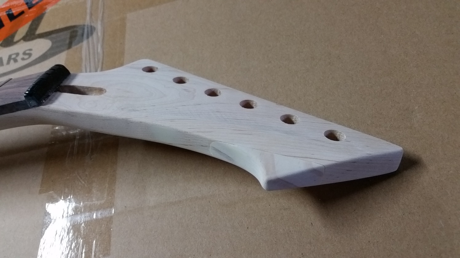

    To make it look right, added a piece onto the headstock and shaped the pointed edge

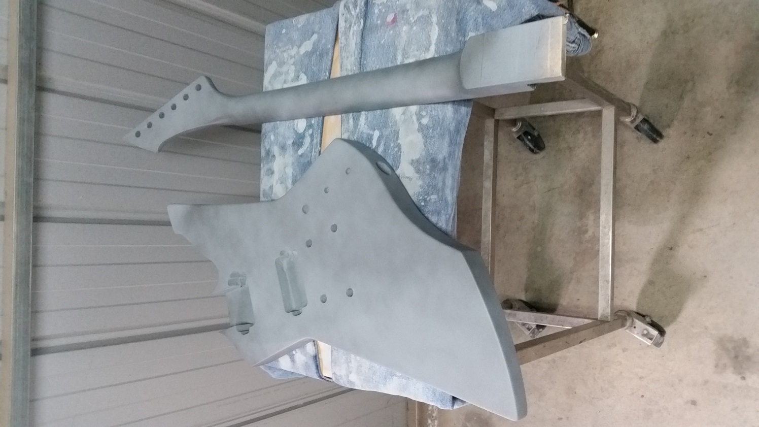

    And now all primered up
