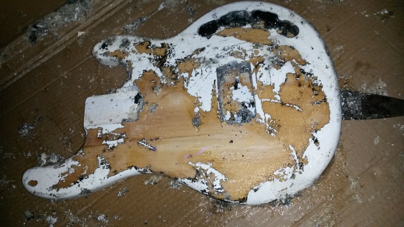

    So I set about the basically pointless activity of removing the incredibly thick paint and sander sealer.
    And even after about 15 coates of stripper, and a liberal dose of heat gun, it still looked like this.
    The sander sealer looked like congealed honey, and while the very thin enamel(ish) gloss came off pretty easily by comparison, I was wonderign if the other gak would ever come off.

    wow what an absolute mess Beef getting the paint off.

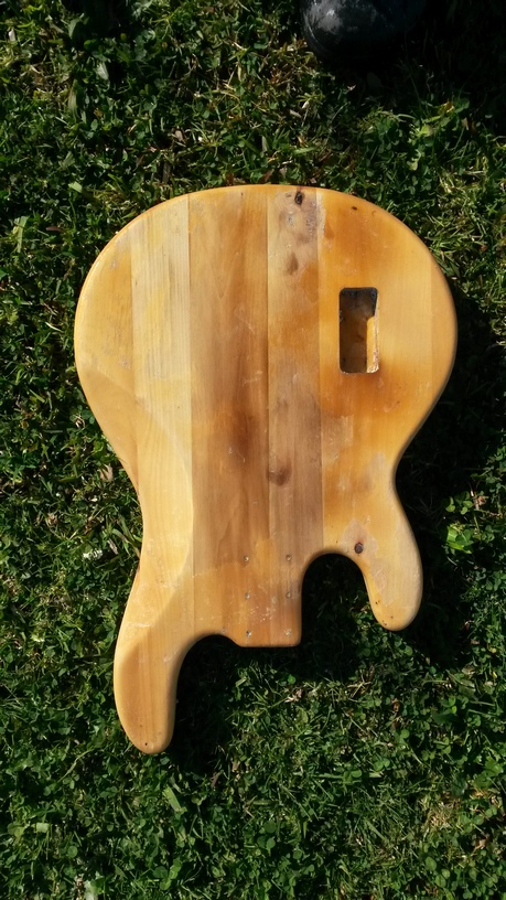

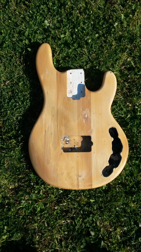

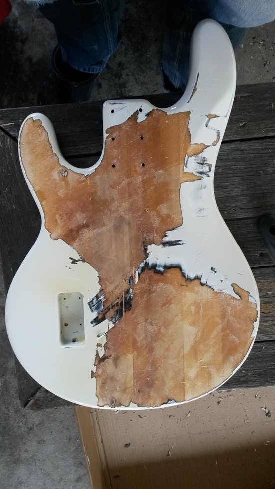

    Next day I had it looking pretty much like this:
    You can see the heat gun damage to the back, where it has gone orange.

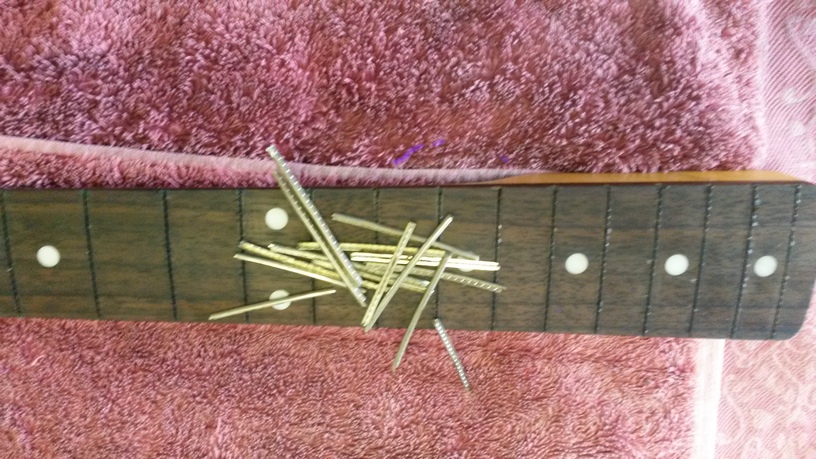

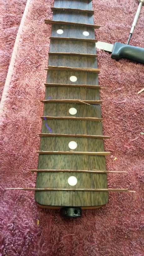

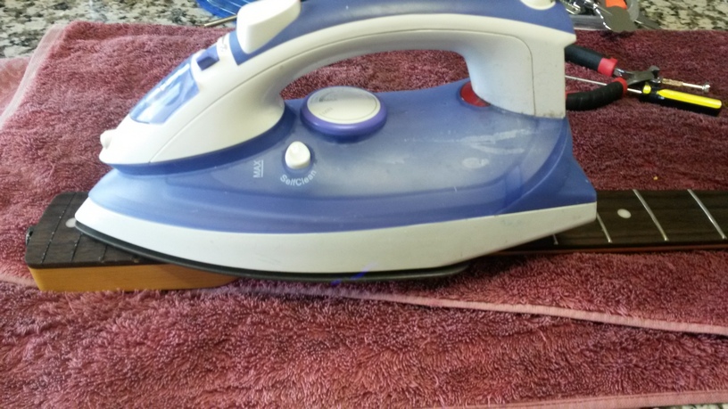

    And they all came out as neatly as a meth-head's teeth. (Probably neater)
    come up pretty good Beef considering how thick the paint and sealer was.
    Whats the idea of heating up frets before you remove them, does that make them easier to remove ?
    That's a new idea !

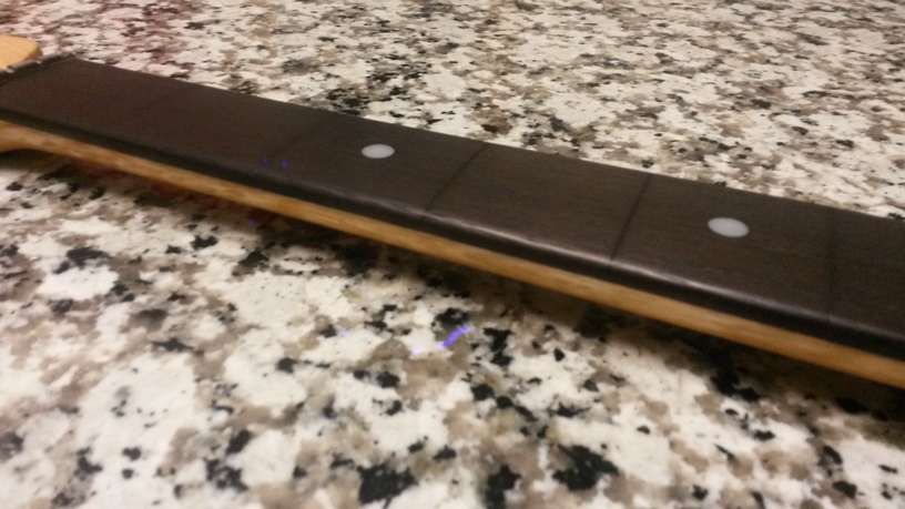

    My most played instrument doesnt have fret lines or markers, so I wasnt keen on the whole lined fretboard idea, so I tried to match things up.
    Filling the fret slots with mahogany vaneer and glue from the nice timber yard out Windsor, NSW way.
    Cutting them off with thing Id never heard of called a Japanese saw.
    Sanding them down and staining the board a few shades darker.

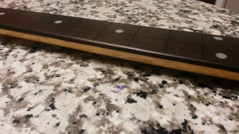

    After a bit of a sand and tidy up, I realised all the neck side position dots are in the wrong place, so I whipped them out, got some dark wood filler, and also addressed some minor nicks in the neck, and restained the whole neck a few more times.

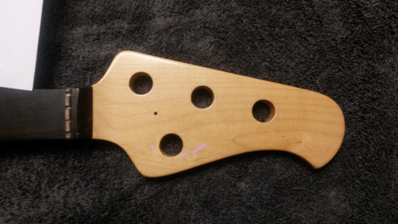

    I also took the time to remove the original logo from the headstock.
    Interestingly the timber had 'aged' around the big black logo, but leaving the unstained neck out on sunny days resolved this in about 20 hours of direct sunlight.
    The frets come out easier if you heat them up, just softens up the glue. Some people use a soldering iron.

    wow looks excellent Beef. What did you use to stain the fingerboard ? looks ebony colour - well done
