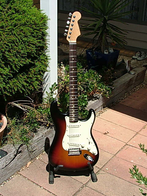

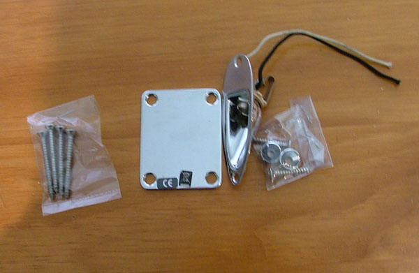

    In 2007 after many years of just playing my G&L ASAT Special and a Danelctro U2 i decided i wanted a vintage strat, but i had no money (muso's don't have money). I played a few different guitars but nothing had that feel i wanted, so i decided to put my own together, heres the build.
    Rory Gallagher is my fav guitarist of all time and he didnt need any fancy frills just a strat and an amp pretty much and its the way i like to setup and play.This guitar is loosely modeled on Rory Gallaghers strat and being a blues blues/rock player myself i wanted the sound and looks to be vintage, hence a late 50's early 60's outlook. I did alot of homework and many late hours on the net looking for parts, not buying anything unless it was an absolute bargain. Netty as the project was called, and if i could make it work, would be constructed by only purchasing the parts over the internet and the cost had to be kept <$1000 aussie (which was achieved).The Aussie Dollar compared to the U.S at the time was .98c today its .72c

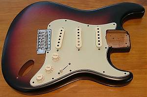

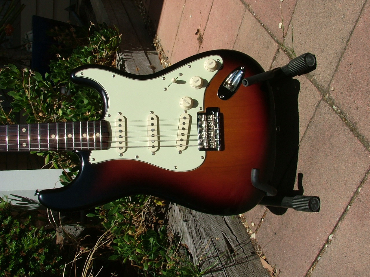

    Body
    NEW (AUG-2007) NITROCELLULOSE LACQUER 3-TONE SUNBURST SOLID ALDER GENUINE FENDER USA STRATOCASTER BODY,JUST UNDER 4lb IN WEIGHT,NEVER BEEN PLAYED,DRILLED FOR A USA SPACED VINTAGE STYLE BRIDGE

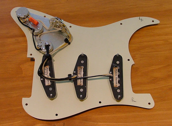

    Pickups were probably the hardest choice for me, i wanted vintage with grunt but the prices or even the making of some of these pickups left alot be desired until i stumbled upon "Sliders Vintage Classics" an Aussie guy in Sydney making handwound vintage pickups so i lined up a set on Ebay and won the bidding. Heres what Slider has to say about his pickups. Slider's Classic Vintage 59's are a matched set of handmade "scatterwound" single coil pickups.

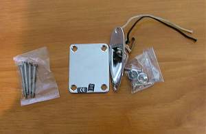

    Next up

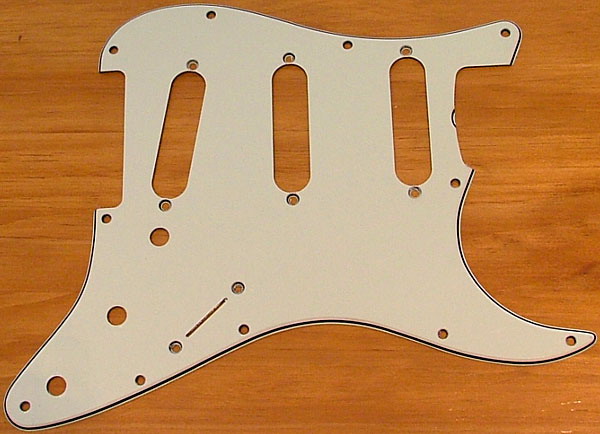

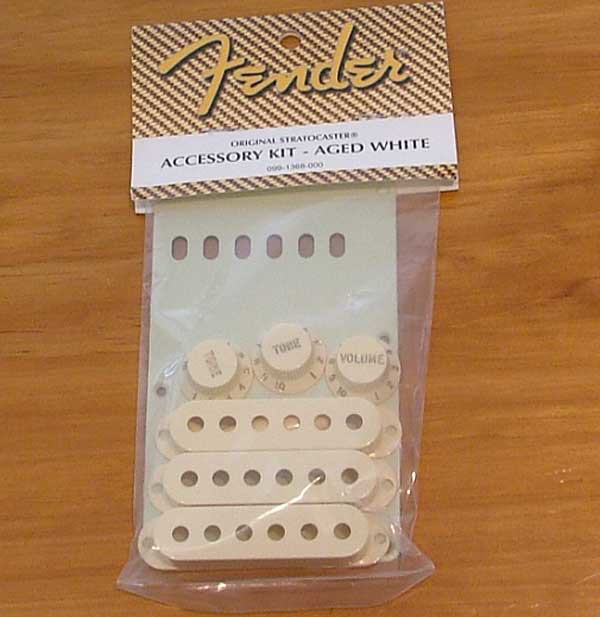

    A NEW GENUINE FENDER 3 PLY 11 HOLE 62 STYLE MINT GREEN S/S/S PICKGUARD COMPLETE WITH SCREWS.
    FENDER STRATOCASTER
    ACCESSORY KIT - AGED WHITE
    Genuine Fender Replacement Part No. 099-1368-000.
    Kit includes :
    3 knobs
    3 pickup covers
    Tremolo arm tip
    5-switch tip
    Backplate
    Now for a Bridge
    Type: Tremolo/Bridge with Full Steel Block
    2008 American Fender Strat Tremolo (6 Screw Vintage) Vintage Style Synchronized Tremolo w/ Fender Stamped Saddles & Full Steel Block- Mounting hole spacing 2 3/16", String hole spacing 2 1/16"- Genuine Fender.

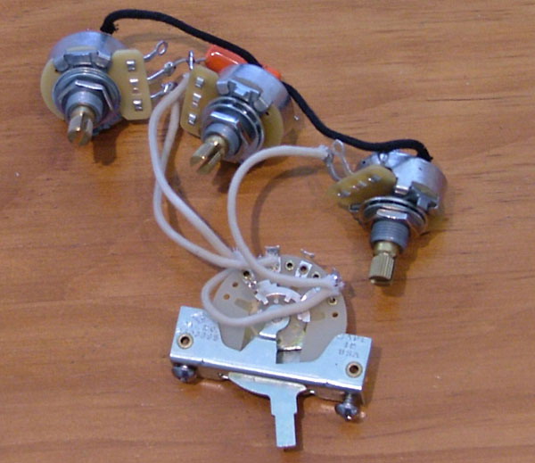

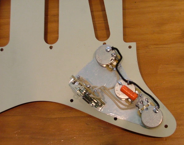

    Wiring and Pots
    CTS 250k POTS matched pots
    CRL 5 WAY SWITCH
    ORANGE DROP 47uf CAPACITOR
    cloth vintage lead wire
    Switchcraft Jack
    I spent quite some time wiring the pups, the Vintage wiring looks good the shielding takes out about 75% of the guitars hum and noise and although the vintage wiring looked great, no ones going to see it anyway.

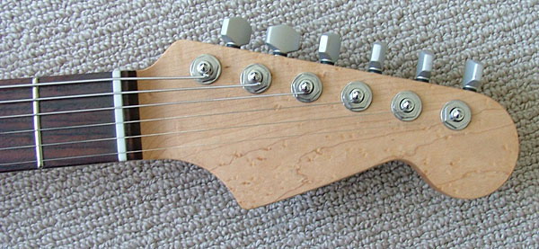

    Neck and Finished
    Warmoth Vintage C shape replacement neck, headstock with Sperzel Lockers. Neck is Maple with rosewood finger board 1-5/8 at the nut Straight 7.25" Radius, Cream Face Dots frets are Vintage Jumbo. I found this neck on the Warmoth showcase.Neck is finished in Nitro clear Matt finish.
    Tuners: Sperzel lockers.
    I probably saved a couple of grand doing it this way, and it also taught me a bit about sourcing guitar parts and whats available via the net, today i am much much wiser.

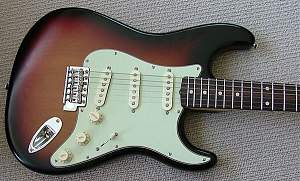

    More parts

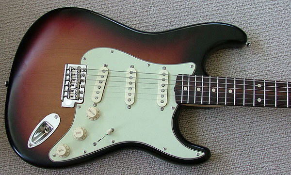

    The finished project
ID:	7044Click image for larger version.
Name:	netty new 003.jpg
ID:	7045Click image for larger version.
  4. Liked by: andrewdosborne
    Looks good Tony. Does she play as expected? I notice no tremolo arm, is the block fixed? I would like to build a similar axe but with a hard tail (I'm not a fan of tremolo systems)
    nice work Tony, neat job on the wiring
    Banned
    Dec 2015
    1,171
    Yes Andrew its better than i expected, my second generation Luthier mate said he gets thousand of strats through and this is one of the best hes seen and heard, so i got it done right which was my main concern. I blocked the trem, also not a fan, Rory Gallaghers guitar was blocked as well ,so it was always going to be. It doesnt get played as much as it should, i am a tele kind of guy but i do love the sound of the strat.
    Cheers Stan i pride myself on my wiring even if no one can see it
    looks good Tony, so the body and neck were pre-finished (stain and clear coats) when you purchased them ?
    Keen to hear a sound demo of the pickups in all switch positions.
    The only fault I can see is no headstock logo to say you assembled it
    Quote Originally Posted by tonyw View Post
    Shows attention to details mate, reveals that you have taken care with this one
