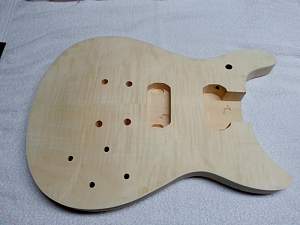

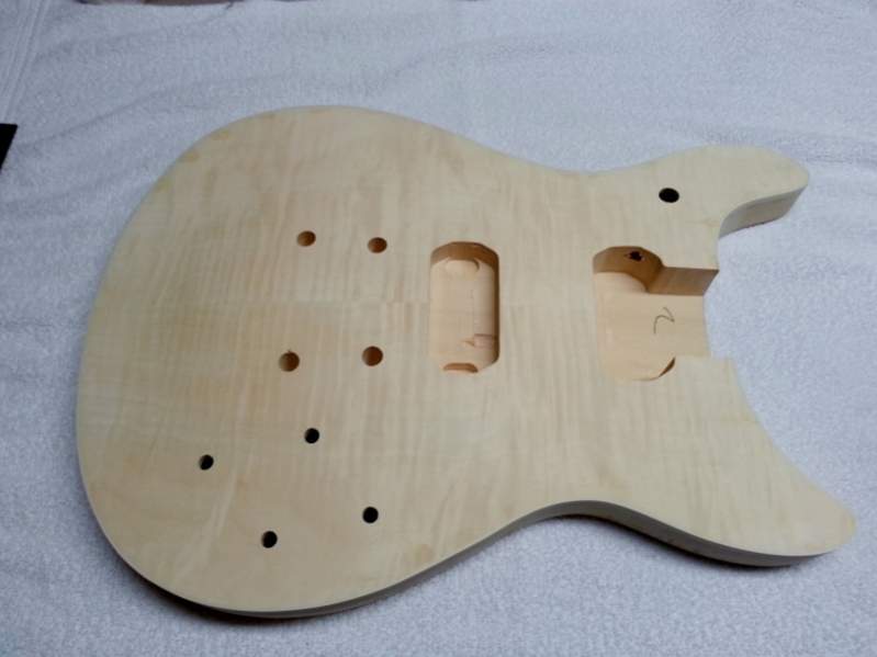

    The body of the Guitar looks great. I can see some clue around the binding on the woo, but I figure than should sand out.
Name:	PB Body (800x600).jpg

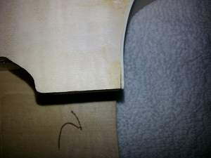

    But I did find one issue. The binding on the top of the guitar at the neck has pulled away from the wood. Hopefully a little titebond and some tape and I can get this stuck again.

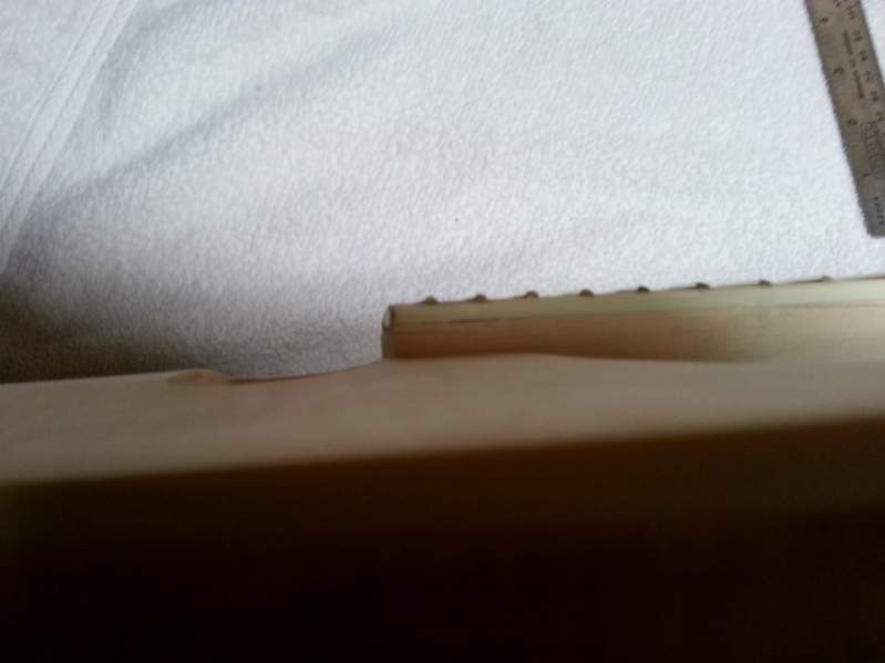

    The last issue or perhaps it is a non-issue is the neck and the body. It seems really high over the top of the body at almost 12mm. It is however, fairly tight which makes me confident that I won't screw it up. Feedback would be greatly appreciated

    Bit of glue on the binding I'd use superglue and tape it up tight, try and wipe off any excess glue before it dries.

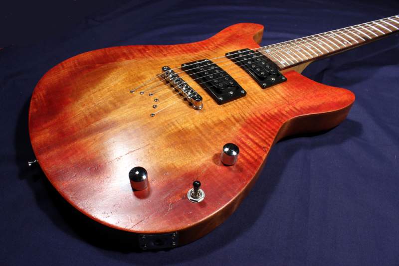

    I've attached a pic of a PRS I built a while ago, different model (PRS-1S - spalted maple cap) but it's a set neck and my fingerboard is about that proud from the body so with a tune-o-matic bridge should be ok. Does your neck rake back like a LP guitar does about 3 degrees from memory ?
    I think my PRS does.
    I'd order your hardware and to a mock build and get a long ruler to see what the string action will roughly be.

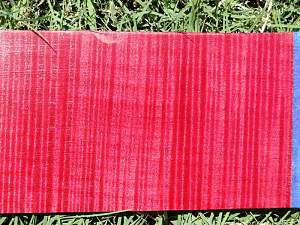

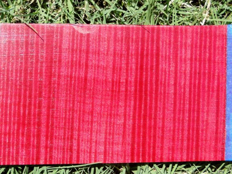

    Yeah I saw that, was just too worried it is a more salmon like pink. I can start really light an work up with the transtint. Here is a sample I found that made me think it is the way to go.

    that's a nice shade of pink, the flames should look excellent
