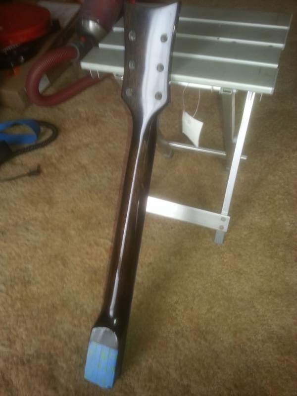

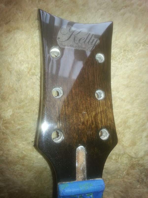

    After too many attempts to get this done I have reached a point whereI am happy at least with the neck.
    Thanks to AJ for his help with sorting the spray gun(I still have a long way to go).
    I have tried to get a gloss on this neck about 5-6 times each time cutting through the Japan Black. Each time having to patch the cut through and repspray with clear. The danger with spraying clear on a neck is to not get it too thick, but thick enough so you can cut out all the pock marks. I think I have gotten this one as close as I can.
    PK

    Very Nice Paul,
    Quick question what type of decal do you use? is the decal intact and damaging it when you spray the Lacquer?
    Regards
    Budi

    that has come up nicely Paul

    Hi Budi,
    See reply below... DOH
    PK
    Kellza
    (PK)
    Mentor kells80aus's Avatar
    Jan 2014
    Wyndham Vale, Vic
    775
    Hi Budi,
    this is a lazer printed decal. I bought ten sheets of it from a craft site. It is a gummy backed decal that you wet for 30-40 seconds then slide off. The beauty of these is they are A4 sheets, so you can print some dummy runs on plain paper to get the right size.
    With the Lazer print it isn't that important to give them an acrylic dusting like you have to go with the plastec ones from Officeworks, as they are printed on inkjet which runs when wet. the Decal is under the acrylic. I did notice though that it does not appear to be too secure and I feel it may lift in time to come.
    Tks AJ. now I need to get soeme X20 to hit it with to hide those tiny swirl scrtches.
    I think I understand now what was happening with the overthnned Acrylic. I think it was flashing off the previous layers, so everytime I hit a layer of acrylic on it most of the previous layer was getting vapourised, so your suggestion of 75% thinners would reduce this from happening. I have it at about 130% atm but I am planning to wind that back to about 100%. I also think there are issues with this spraygun I am using. It is all to do with gettign the pressure right at the nozzel. I need to work out how to balance the right presure with the right amount of paint feed. too much pressure on a low feed rate is giveing me the too fine atomization. If I wind the feed up a little I get the tiger stripe banding, which means there is too much pressure at the nozzel. so it is a balancing trick and I am still elarning what I am doing. I need to get a large sheet of MDF, preferably painted a dark colour, so I can do a few practice runs till I get it sorted.
