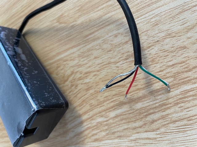

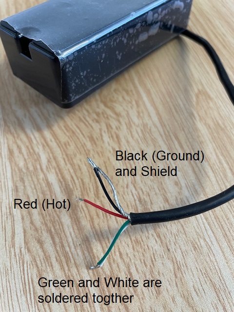

    With the 4-wire pup shown below:
    the Red wire is "hot",
    the black is the "ground/Earth" which is soldered to the bare Shielding wire,
    and the green and white wires (which are soldered together) link the two coils in the humbucker. These are normally taped to prevent them shorting on the other components.

    Great idea! That's actually all you need to know if you are attaching PB supplied pickups. If they come two "colored" wires soldered together that's always the middle. If there is a wire soldered to the silver shielding wire that's always the ground (or finish), so by process of elimination the other wire must be the "hot" or start wire.
    I think with a lot of the PB kits you get two different colors of hot. YMMV, but sometimes one is red and the other is yellow. The "hotter" the two will be the bridge pickup and other will be the neck pickup. You can test to see which is hotter with a multimeter by checking DC resistance (ohms) between the "hot" wire and the "ground/earth" wire. The one with the bigger number is the hotter pickup.*

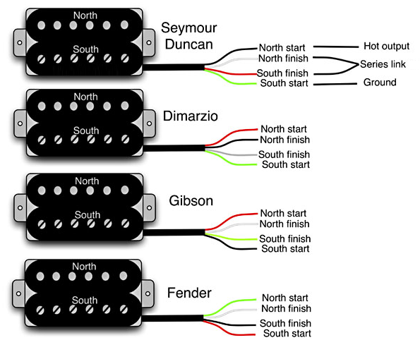

    If you buy aftermarket pickups all this may be mapped out for you already:
    The guy (Chris from Highline Guitars) in the vid won't tell you the "right" way to wire your humbucker, and says it depends on the sound you are going after. Technically true. However, the most common way to wire them is in series. That would be the way the pickup is wired in TD's example and like the Seymour Duncan in the pic.
