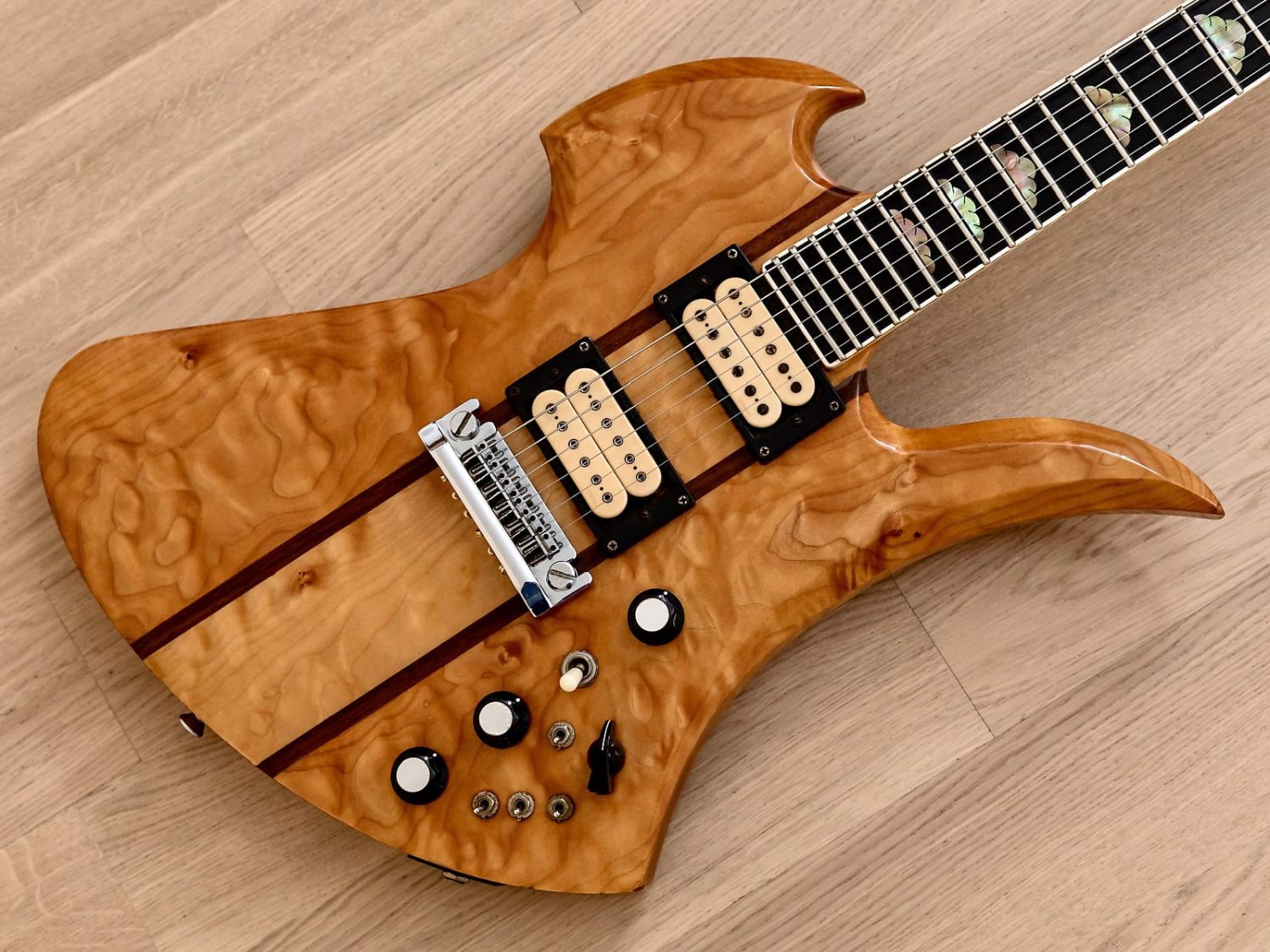

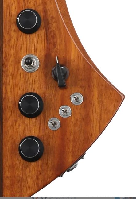

    I may use a mini toggle switch to turn on the varitone circuit. I know the idea of the first (bypass) setting is to not use the varitone, but I think I like the idea that the setting can be preselected before it is needed. I will keep thinking!
    I have acquired a couple of rotary switches, chicken-head dials, mini toggles, caps and resistors. So, I am committed now!

    Switches and chicken heads definitely fit the Mockingbird aesthetic ;-)
    Yes, I agree.
