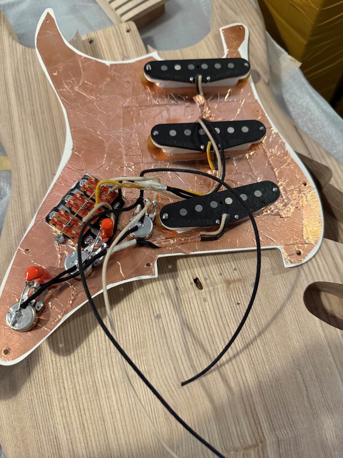

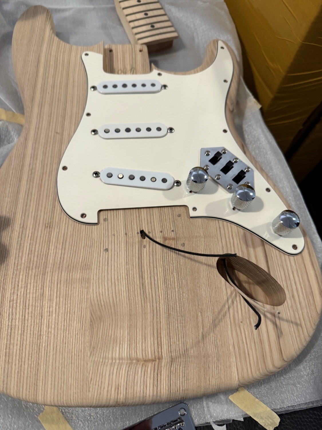

    Keen observers will notice that I've thrown out the traditional wiper-blade selector switch in favour of a three-selector panel.. that's something I found going through the misc pile, there's a dozen or so pre-fabricated plates, and they fit the two-position DPDT selectors perfectly!
    I'm using an ancient SSS ST loaded pickguard I found... and first thing is that the hardtail bridge won't fit in the tremolo slot, so I've got that to try and get square!
    I've shaped the headstock to the 'Pit Bull Guitars' shape, but that's all I've really done so far.
    2,042
    Nice work. The cream pickguard will look great with the natural tint from the Tru-oil!
    Take care with widening the pickguard to fit the hardtail bridge as the lower screw hole gets in the way. I had a similar issue with my STA-1HT kit.
    Good luck with the build!

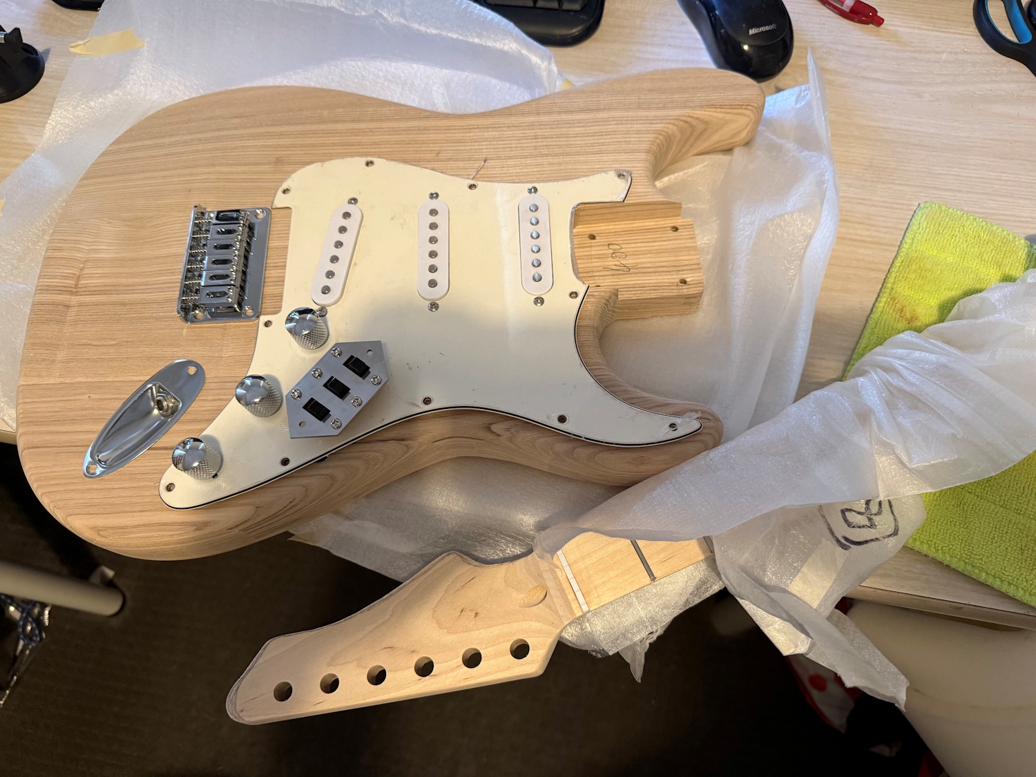

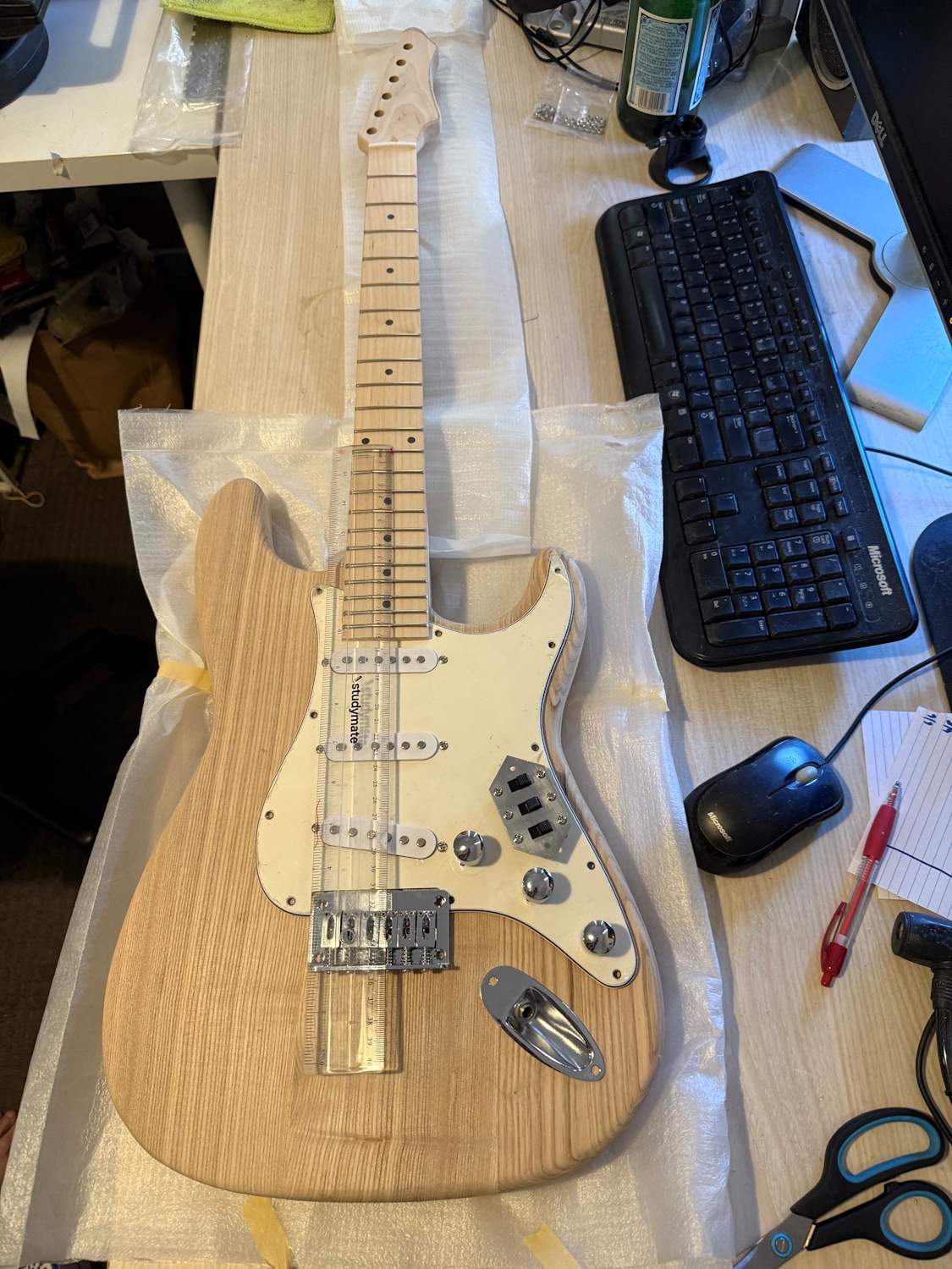

    This build is progressing slowly.. as I inevitably get more and more ambitious with what I want to do with it.

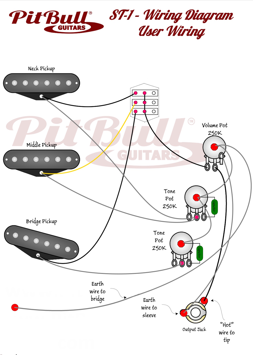

    I probably didn't need to do the pick-guard first, but I was most excited about that, and working in electrical engineering design, it was probably the easiest step to do. I must say, I'm absolutely stoked about how nice the creamy aging looks on that pickguard under the crappy old plastic covering. It really did a good protection job!
    I've drawn out the schematic for how I've wired it up, just as simple as it can possibly be - a classic standard strat that's just got individual switches for pickups instead of a 5-way switch.

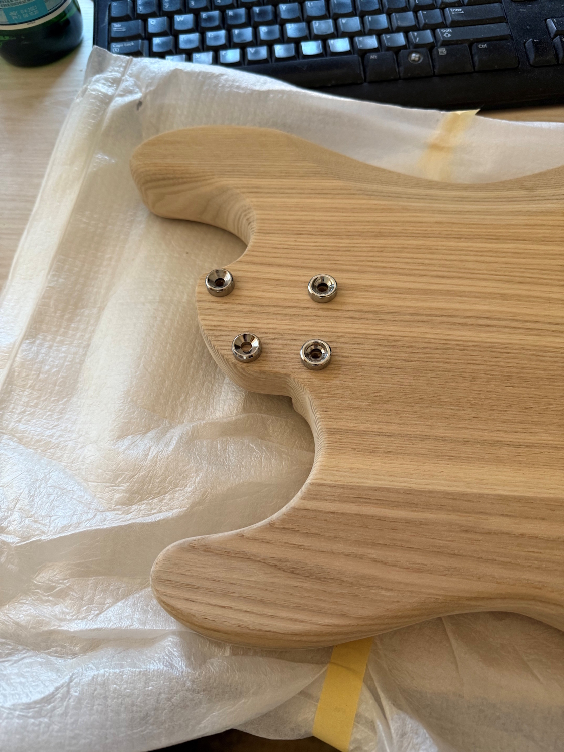

    I'm going to use ferrules for the neck bolts and string-through for the bridge, so I thought I'd shape the neck heel a little just for funsies. Ash is a solid wood to work with, and I did all that by hand with just a rasp, then file, then sanding to smooth. Not shown, I very slightly put an extended curve in the neck on that side to suit, but it's quite subtle.
