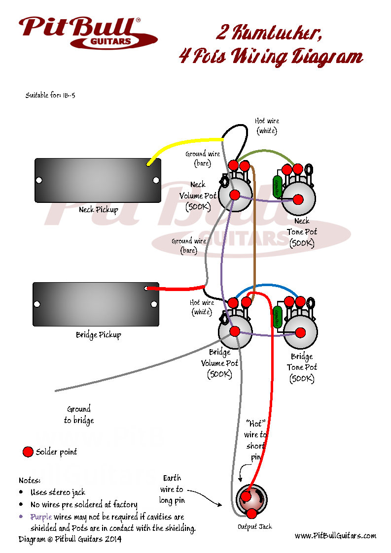

    possibly easily fixed but we don't see it possible that we can earth to Bridge on IB-5.
    Wiring Pick Ups to Pots and Ground to Bridge???
    Could anyone advise us how to Earth to bridge?
    Do we have to start drilling our own routes for wiring or is the Diagram incorrect that we are trying to follow to build.
    With the diagram, it makes sense and we can do everything easily except this part where is says to Earth to Bridge as we don't see how this is possible.
    Can anyone help with this?

    There's a small hole that connects the control cavity to the area of the bridge location, the ground wire is simply fed through that hole and a splayed bare end is held between the body and the bridge plate to provide the grounding.
    Note. if the bridge is black as per the website it is most likely non conductive so you'll have sand a bit of coating back to bare metal to make good contact

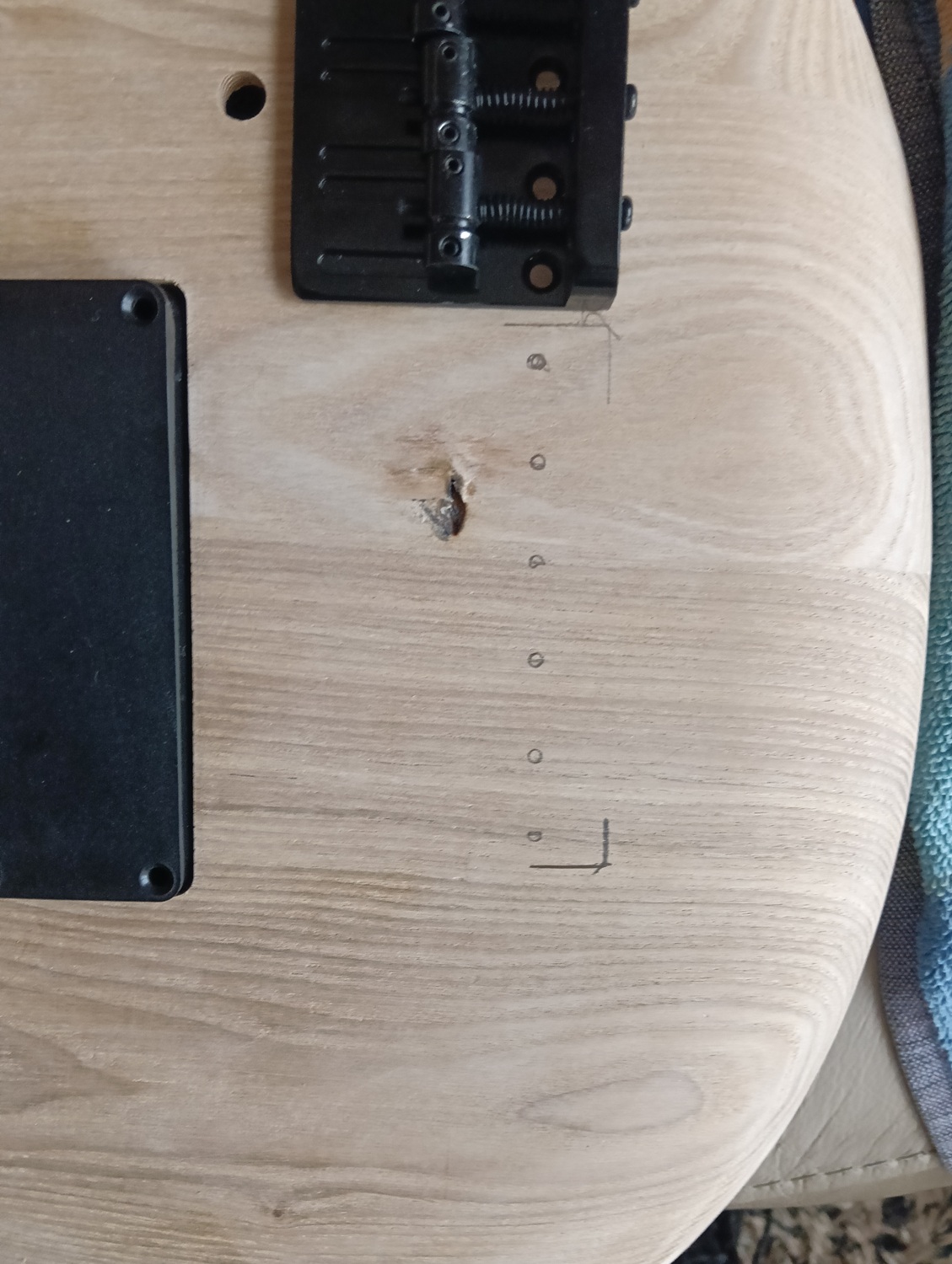

    ahhh... before we copper taped all cavities, we accounted for the holes that were present and these were for the Pick Ups and the Pot Bay. there was no other holes.
    we will attach a photo which may be something that we don't know of as just thought a blemish as did not go anywhere, as if just a knot in the wood.
    There is no other holes in the body of the guitar than already accounted for and nothing that goes from Pot Bay to behind the Pick Ups. do we have to drill our own hole from behind the Bridge to the Pot Bay Cavity???

    This hole, Blemish where would be behind Bridge is in opposite direction from any would be wiring source. so we filled it in and finished the body with Acrylic over Primer covered in Polyurethane.
    there were no holes that leads from Pot Bay Cavity in the direction towards the Bridge or anywhere else as all holes accounted for by Wires from Pick Ups and to 1/4" TRS Outlet.
    If we have to drill, we guess we will have to drill.

    dave.king1... you surely have saved us plenty of hours, more likely days, as with your description, that we found nowhere else, we found where this Pick Up Bay to Bridge Grounding pathway very easily.
    it was the thing that we thought to be a mere blemish which comes to be one of the most important fixes we have had this build, our first build.
    obviously we had copper taped over it ages ago and never took a second thought to it.
