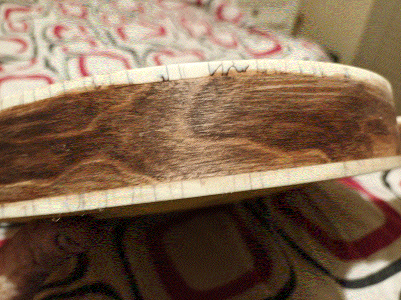

    Is this normal all these cracks ? How do you fix it did I bugger it up

    As far as the binding is concerned: it is common for the stain to creep into the cracks.
    For the TL-1TB kit I did, I sealed the binding (using tru-oil). I taped it up. Then added the stain. This seems to have worked.
    You may be able to scrape the binding to remove the top surface (and hopefully the stain marks). There is a post from Simon B (I can't find it atm) but I'm sure it mentions that he painted the binding!!!

    Mum and Dad are in America they went to the NAMM show and then to Egypt so their away for another 3 weeks when he rings next time ill run it by him as I don't know about fixing this, ill try to scrape it I watched youtube might haft to put new plastic strips which I have no clue about, I probably haft wait for dad to get home and see if he will fix it but he doesn't want to paint anymore, was looking forward to doing it never had an ES

    I know this is a common problem, so if you go searching you may find various solutions. I remember Simon painting. Once you have it clean, putting some clear on it before adding any more stain, as TD suggests, makes great sense.
    I tried staining an ES, but botched it and went with a solid color...but before that a bit of a problem like yours, although not as bad. I was able to get rid of most of it by scraping. It really just depends on how deep the crack is. Worth a try.

    i thought about that but it was right through the whole thing I talked to the old man about it he said to just put it aside till he gets home and has a look at it, it's too expensive to mess it up as my guns skill isn't that good I ordered new plastic strips Dad said he might paint it if he can get away with it I know nothing about painting im probably the worse painter here Dads pretty good at it, He an automotive spray painter and he's done heaps of them is I got to try to talk him into painting it, I got an ash Stratocaster with the es so I'm using that to try spray paint I can use all his guns and stuff bit disappointing but

    I can spray paint but not a scratch on the ol man his guitars look crazy good, I ordered new plastic strips I haft to fix it as cost me heaps to buy it I've got a strat which I'm doing while I wait to fix the ES, and a les Paul I just ordered
